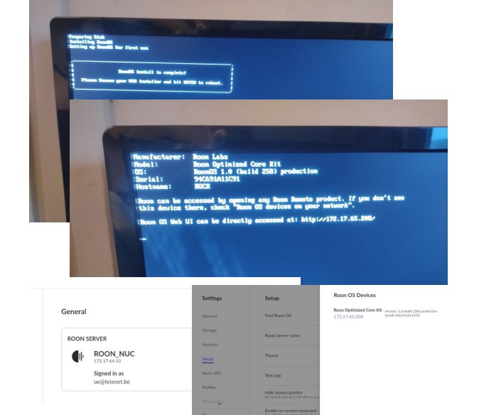

Installation was o.k./successful … but the configuration screen did not appear. Instead, I got the message that Rock can be accessed on any web browser at 172.17.65.208.
…but I can’t access this site in either way (= this site is not available)
When looking at my other NUC (Roon on Windows 10, ip: 172.17.10.) and going to setup, Rock is found on 172.17.65.208

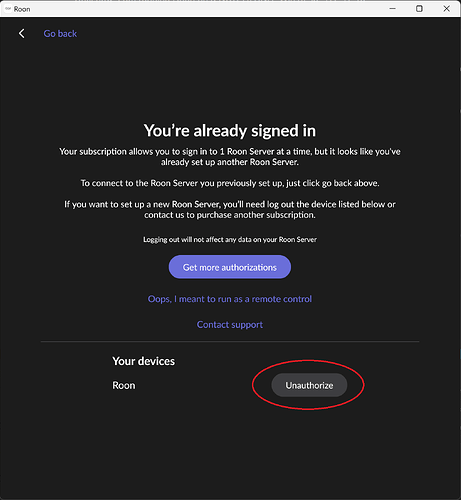

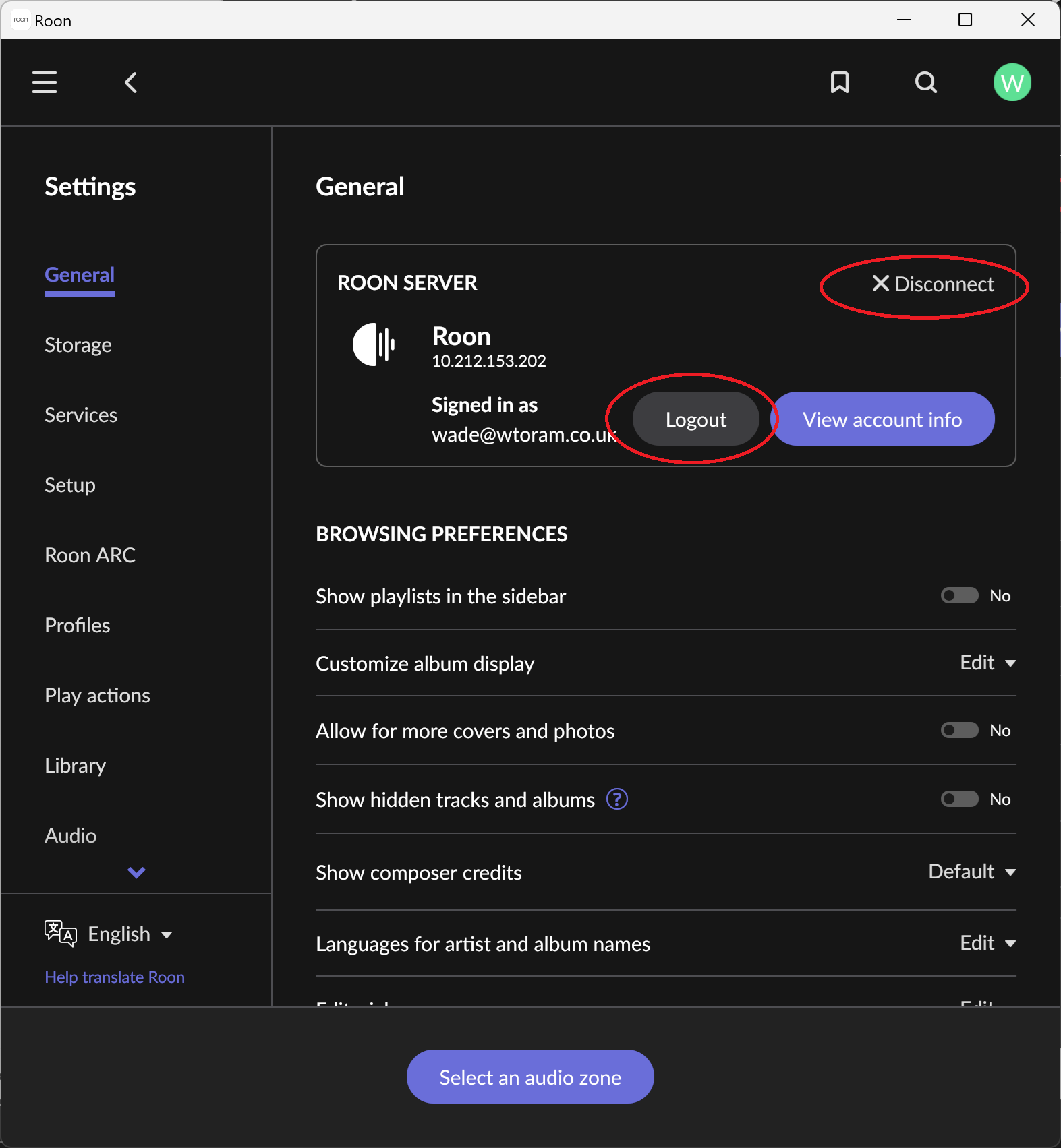

You will have to logout or disconnect from your existing Roon Server:
And then connect to the ROCK Roon Server when offered a choice:

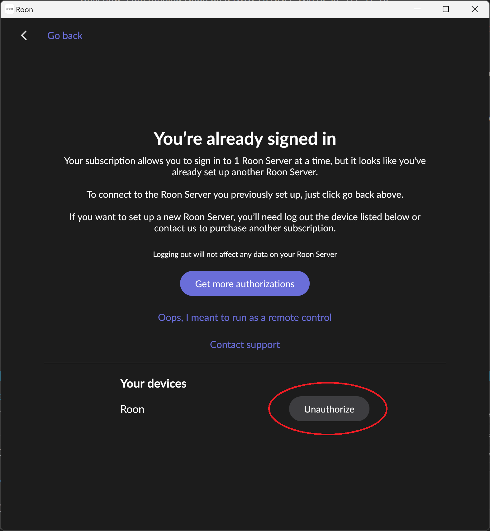

If you only ‘disconnected’ from the old server, then you will have to ‘unauthorize’ the old Roon Server:
Then you can log into the new server.

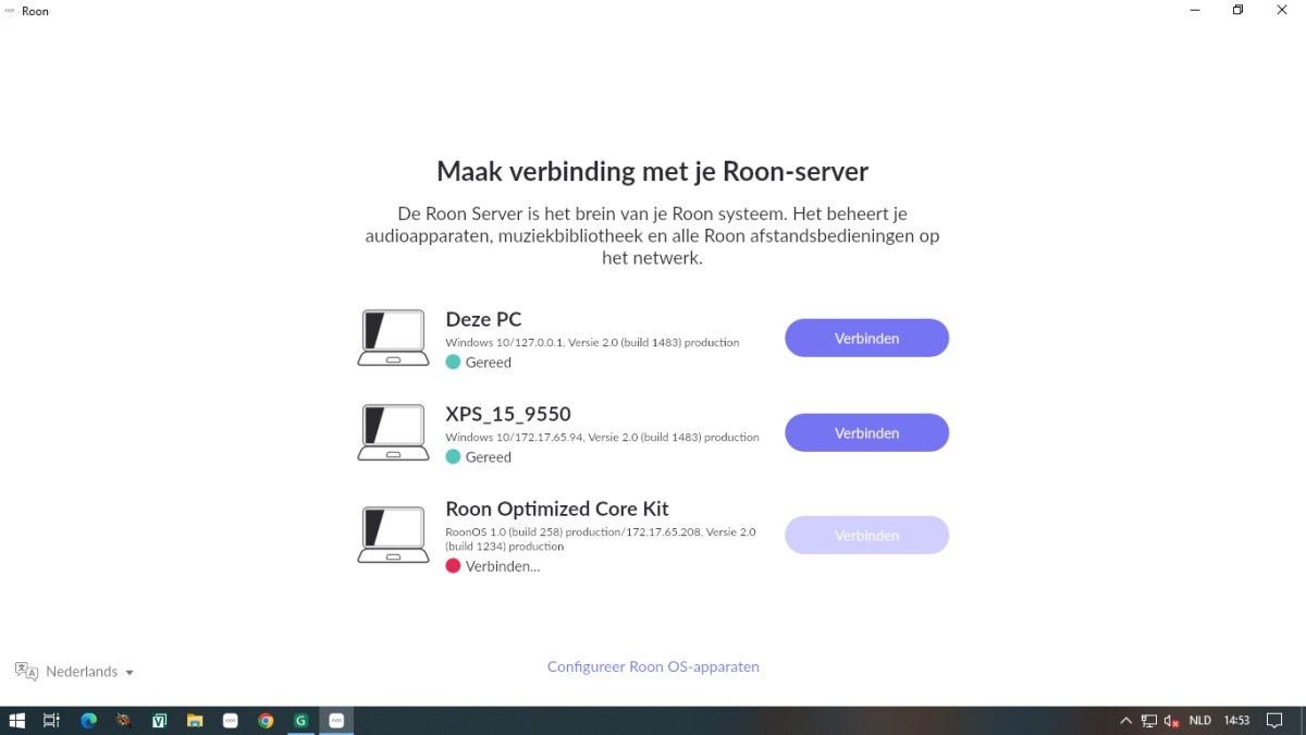

Today ROCK appeared for the first time on the selection screen…unfortunately I did not get the option to connect (see attached print screen).
What exactly happened: I disconnected the current Roon server, but by mistake I had not yet started the NUC with ROCK. When the Rock had just started, the selection menu appeared, but it was not possible to actually make a connection. After about 1 minute, the choice disappeared again.
Conclusion: if ROCK is on/started, the selection menu does not appear… if Rock still has to start up, the menu does appear, but I cannot connect… and after a minute the choice disappears again. Any idea how to find a solution?
That screenshot says that the Roon Server on the ROCK system is build 1234 - which is an old version.
You should first go the the Web Administration Interface of the ROCK and reinstall the Roon Operating System - this will install the latest build of Roon Server as well. This is stated in step 6 of the ROCK Install Guide:
Be sure to also confirm that ROCK is on the latest version. You can trigger ROCK to update by selecting Reinstall from the Web UI.
