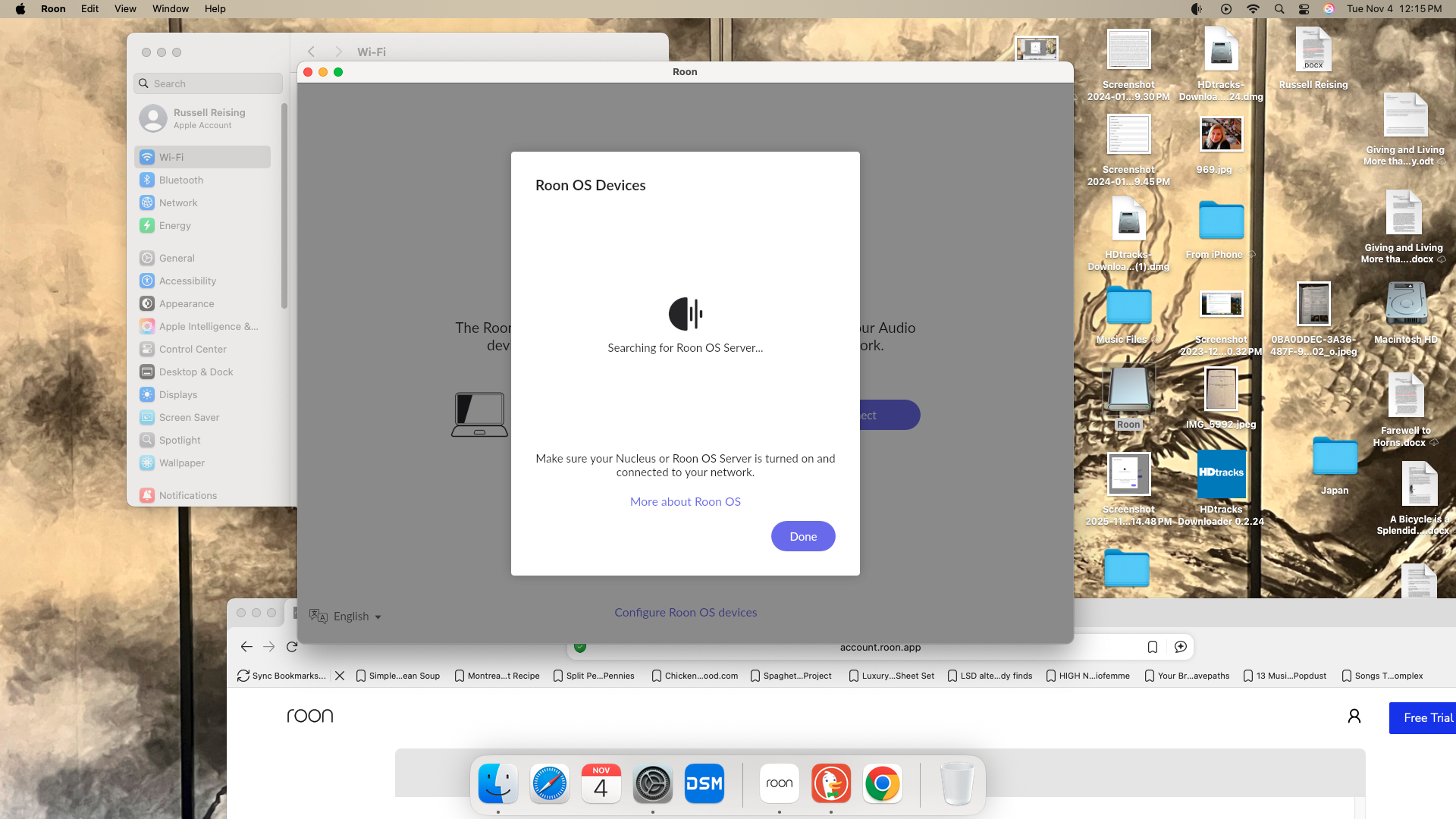

Unable to access Roon Server due to incorrect email address (ref#EU4KX1)
Is Roon Server running?
· "Waiting for your Roon Server"
What happens if you press the "Select a different Roon Server" button?
· I don't see Roon Server.
· *MacOS*
I’m sure roon has the wrong email address for me. the one listed is new, and I never manually changed it. I can’t access my roon library on my Mac computer. My nucleus is a wyred 4 sound music server.
Wyred-4-Sound music server;
Hi @Russell_Reising,
You stated that Roon Server is on macOS, the screenshot posted is looking for a RoonOS (ie a Nucleus or ROCK) so that screen will not find your Mac, and can be disregarded.
I suspect the issue may be down to this …
macOS Sequoia (version 15), has tighter (and more obfuscated) network security settings than preceding MacOS versions.
Can you please navigate to macOS System Settings > Privacy & Security > Local Network, and make sure Roon and Roon Server are allowed.
If it is already enabled, toggle it off and on again. Then reboot your Mac, and see if the same issue persists.
