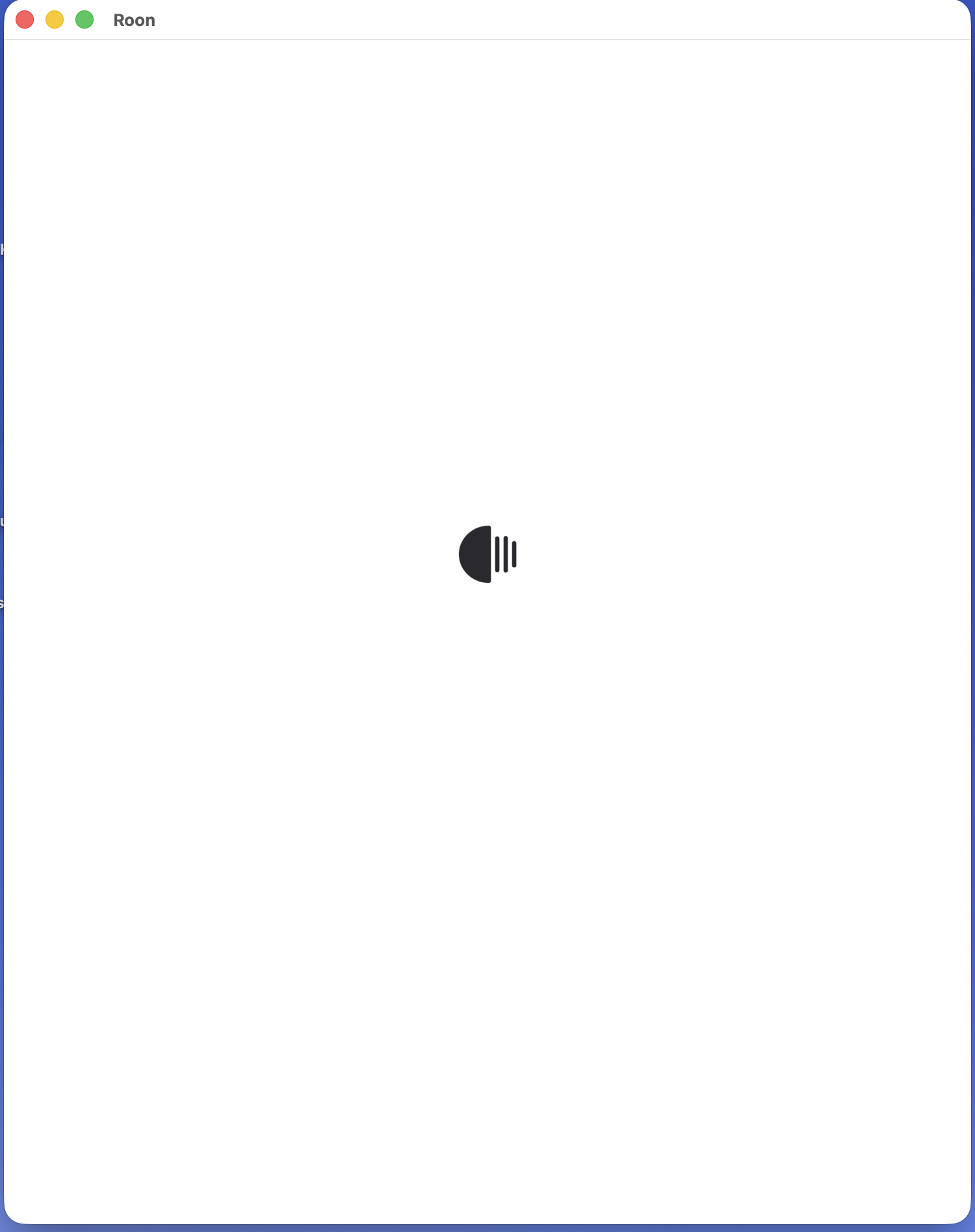

Since the last Roon update I cannot access my roon server on my Nas. I tried everything I can do but no success. So I want to create a new server on an SSD but roon is blocked on the symbol searching...
I want to create a new server on an SSD (and no more on the NAS)

2/ Or if I want to change my Roon server (no more on NAS) but on a SSD, how can I do it ? because It try to connect and remains stuck on the Roon symbol (see yesterday print screen)
