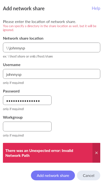

At this point, under Storage -> +Add network share, I am not able to add a network share and my folders show as "This drive is not available. Check the drive or edit this folder if it's been moved."
When I enter smb://192.168.1.249 it fails to connect with the message "There was an Unexpected error: Invalid Network Path". I am able to access my NAS files via my desktop's Windows 11 File Explorer with no problem.

For the network share location I assume \johnnysp is the Synology‘s DNS name? If so then the name of the actual share seems missing. Something like \johnnysp\share
Edit: the second leading \ is killed here in the forum for some reason?
Thank you for your assistance. johnnysp is the name of the Host NAS. I have tried a variety of paths to access the Network share including: smb://192.168.1.249
smb://192.168.1.249/
smb://192.168.1.249/Music Library
smb://192.168.1.249/Music Library/
The following is entered as preceding with two double back slashes (not one as displayed here)
\johnnysp
\joihnnysp
\johnnysp\Music Library
\johnnysp\Music Library\

The forum uses the single backslash \ as an escape character. Therefore, you need to type three to see two \\ of them

Hi @John_Spaventa,
What are the Advanced SMB settings? Diagnostics we’ve pulled from the affected RoonServer instance indicate that the mount is failing due to outdated security. This sometimes results from the NAS defaulting to SMB 1.0.
My apologies to everyone who has tried to help. The problem was I was using an incorrect password. So happy we have the solution and I confess I am so red-faced and embarrassed. Please close this ticket.
