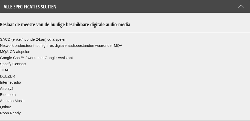

2) This is the link on the Dutch Technics site for the SL-G700M2: [Grand Class – G700 Series SL-G700M2 - Technics Nederland] (Grand Class – G700 Series SL-G700M2 - Technics Nederland):
Specs:
SACD (enkel/hybride 2-kan) cd afspelen
Network ondersteunt tot high res digitale audiobestanden waaronder MQA
MQA-CD afspelen
Google Cast™ / werkt met Google Assistant
Spotify Connect
TIDAL
DEEZER
Internetradio
Airplay2
Bluetooth
Amazon Music
Qobuz
Roon Ready
Are the specs mentioned on the Dutch site wrong?
And you are right, I mean the SL-G700M2. Thank you.
Best regards,
Peter
At least to me it looks like it. Maybe this is about future plans, maybe it is a copy-paste error. I already linked Roon Labs’ official Technics partner page above where you can see that the device (currently) is not listed. While Roon Labs may comment on the issue here, I think you should definitely contact Technics about your inquiry – it is their product and their web page, so it also is their responsibility to provide clarification and correction if, where and when needed.

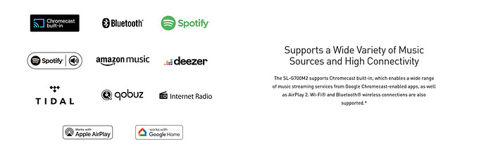

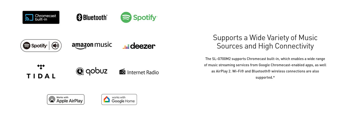

I searched the web page you posted for the device and didn’t see a single mention of Roon or Roon Ready. Can you post a screen pic where it is shown?
Needs to be uncovered and is there then visible:
It looks so far like the Dutch site is the only one containing a reference at all to Roon (I cross-checked the French, UK and German sites and none of them reference Roon neither does the US site I already linked above, copy-paste error then?). Following official support links I came about Pansonic’s specification sheet and that also does not mention Roon:
