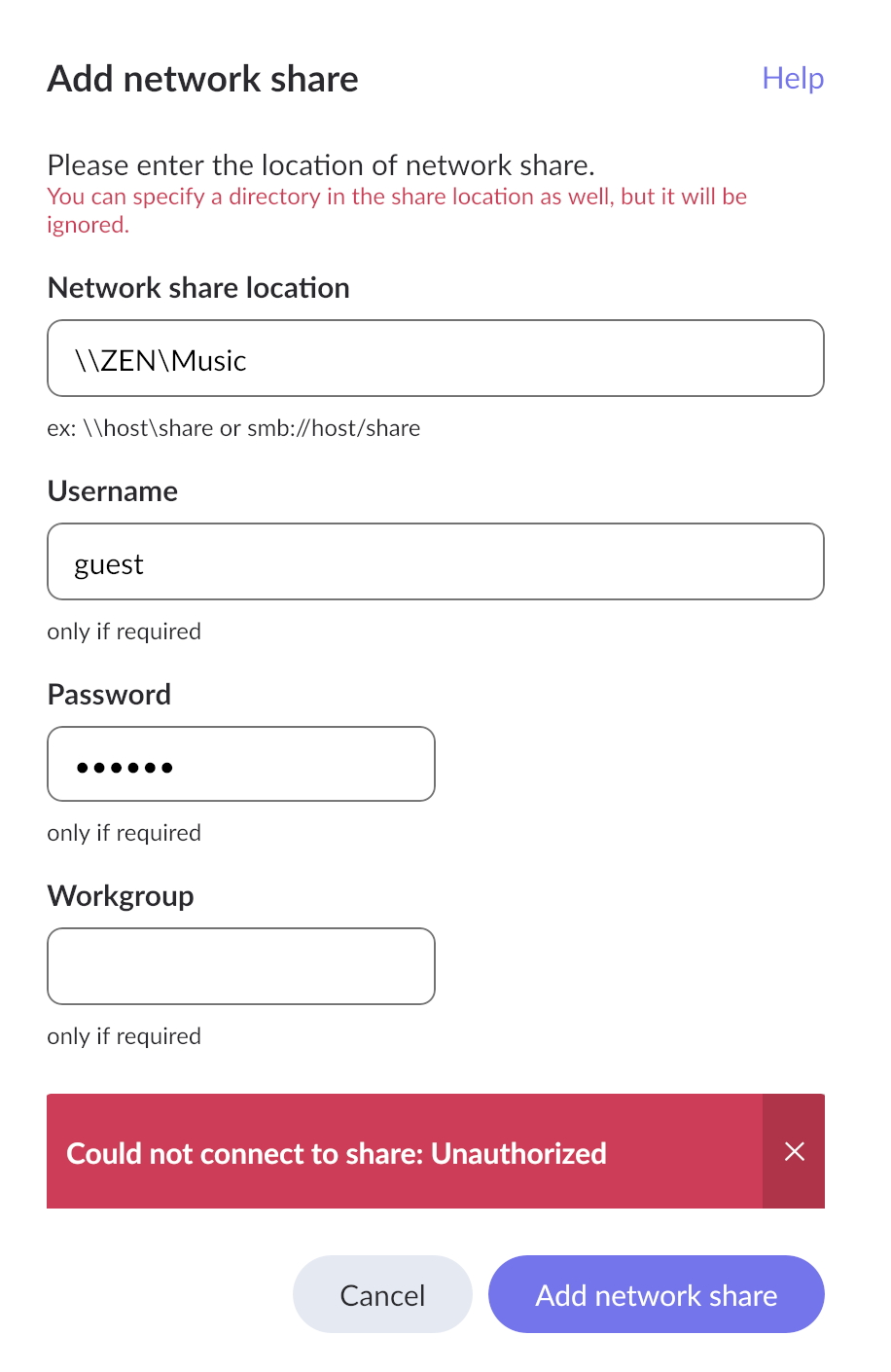

· I am unable to add a network share to access my Innuos Zen Mk.3 hard drive. Roon Server v 2.7 on my Mac Studio. Roon Bridge v 2.60 on my Innuos.
I was able to add an external hard drive (WD MyCloud) on my network with a username and password. When I tried it with the Innuos, it said "could not connect to share: unauthorized." I used the same username and password that allowed me to see and access the Innuos hard drive mounted to my Mac Studio, so I'm not sure what the difference is between the WD MyCloud and the Innuos is. The situation seems identical. Your help is appreciated. Incorporating the local files on the Innuos into Roon is a key part of why I want to use Roon. Thanks!

I did try the ip address yesterday, but just to be sure I just tried it again with and without the username/password. Same result. Because the message I’m getting is that my access is unauthorized, I appears to me that the network share location is fine – it’s more of a permission issue (I’m marginally literate when it comes to network issues so I may be completely misunderstanding this).
I added the info about the WD MyCloud only to say that connection happened no problem. I put in the location, username, password and boom – it was added and Roon could access everything I needed it to. It’s ironic b/c the MyCloud is very quirky and I only have it as a non-essential backup on my network. I just used it to make sure as a test to make sure I could add something as a network share in Roon.
Also, I am using the username/password that Innuos gave me and that works for me accessing the Zen on my network from all computers – just not Roon. The only thing I have no idea about is what situation does a Workgroup apply and could that be the issue? I have always left it blank.

I got a response from Innuos who suggested that I try “sense” as a username instead of “guest.” This solved the problem. I’ll note that guest was the recommended username in the Innuos user guide and it worked when connecting to the Innuos hard drive directly from Finder on my Mac. I just didn’t work through the Roon software.
