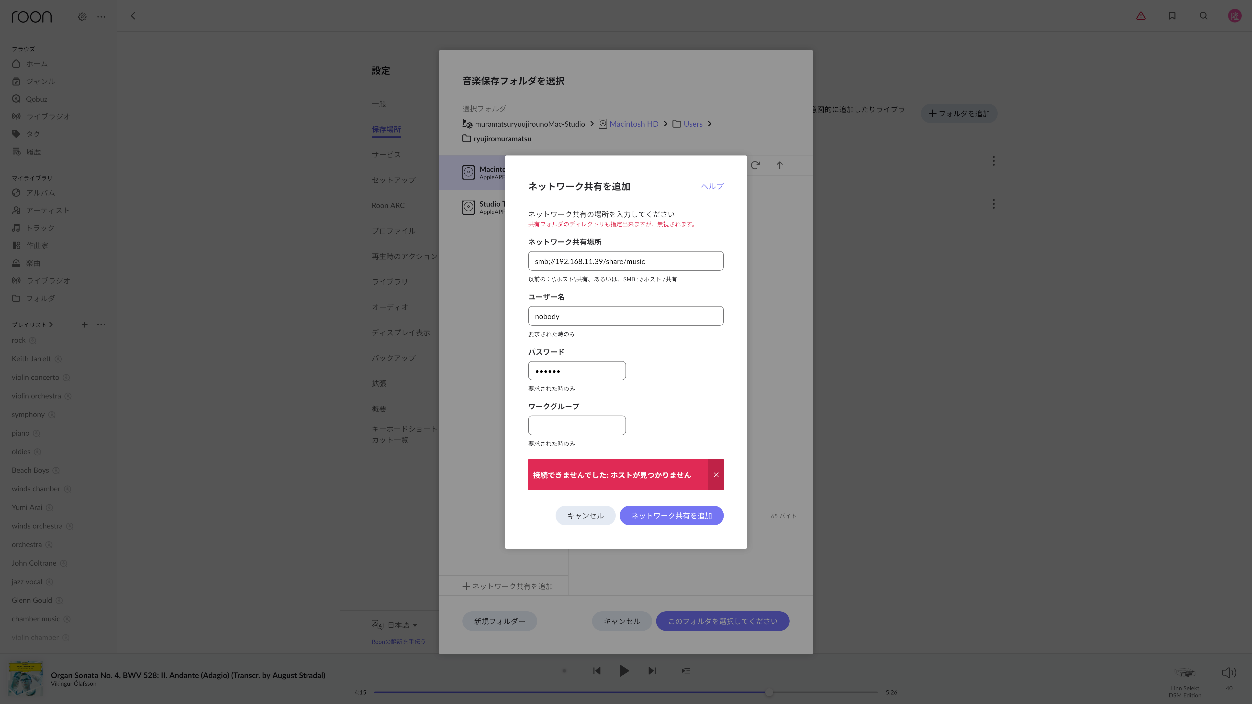

I added a Wi-Fi router to my existing router in my home LAN, so the IP address changed and I need to change the settings on the device.
The address of the save location in the ROON settings changed, so I entered the network share location, username, and password
in "Add network share" and pressed the add button,
but it displayed the message "Invalid network path specified” and rejected it.
Please tell me what to do.

Replace the semicolon (;) after smb with a colon (:) to make it valid, then try again.
When I took a screen shot, I made a misstype. In the case of colon, the result is the same.

I don’t know what your current error message is or if a non-existing path specified also leads to an invalid error.
grafik
It is unlikely that there is a share named “share” including a folder named “music” – it is much more likely that the share is named “music”. The URL to connect to such a share would then be: smb://192.168.11.39/music

I don’t know if that means anything (the translation is correct), but there is no real need or logic to provide an URL or network path here with more than two components, a server component and a share component.
Apparently I had misunderstood the path to the save location. I checked the path again and found that the following path was correct.
smb://192.168.11.39/internal/import/all/music
I entered the new path name and it worked fine. Thank you very much.
