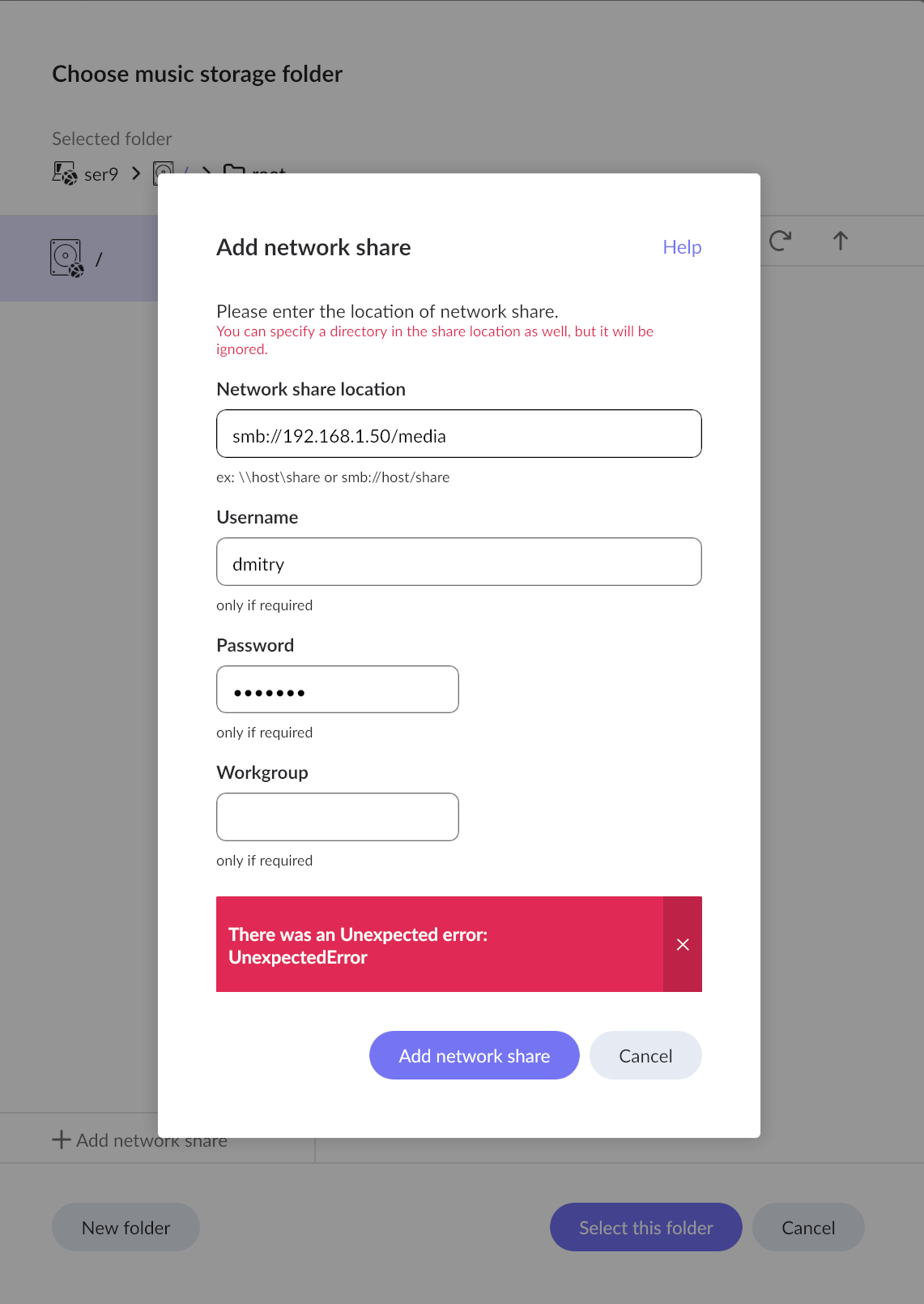

Running Roon server on Audiolonux I cannot add a network share within Roon, I get an “Unexpected error” red message all the time.
Network share location, user and password are all fine and used to work before.
My network share is on the Synology NAS, the Synology logs say that a client is trying to connect via SMB1 protocol and the NAS rejects such connections. SMB share work fine if I connect to my shares right in Audiolinux command prompt (via smbclient).
router: mikrotik RB5009UPr+S+
switch: mikrotik CRS310-8G+2S+
switch: miktotik CRS304-4XG

What you are facing might be caused by the restrictions policy of Synology NAS OS.
Roon is using SMB ver. 1 for file sharing while your NAS seem to be accepting only higher versions of SMB.
What you can do now is to set the minimum version of SMB on your NAS to the “ver 1”.
Let us know please if that’s helpful for you!
Regards.

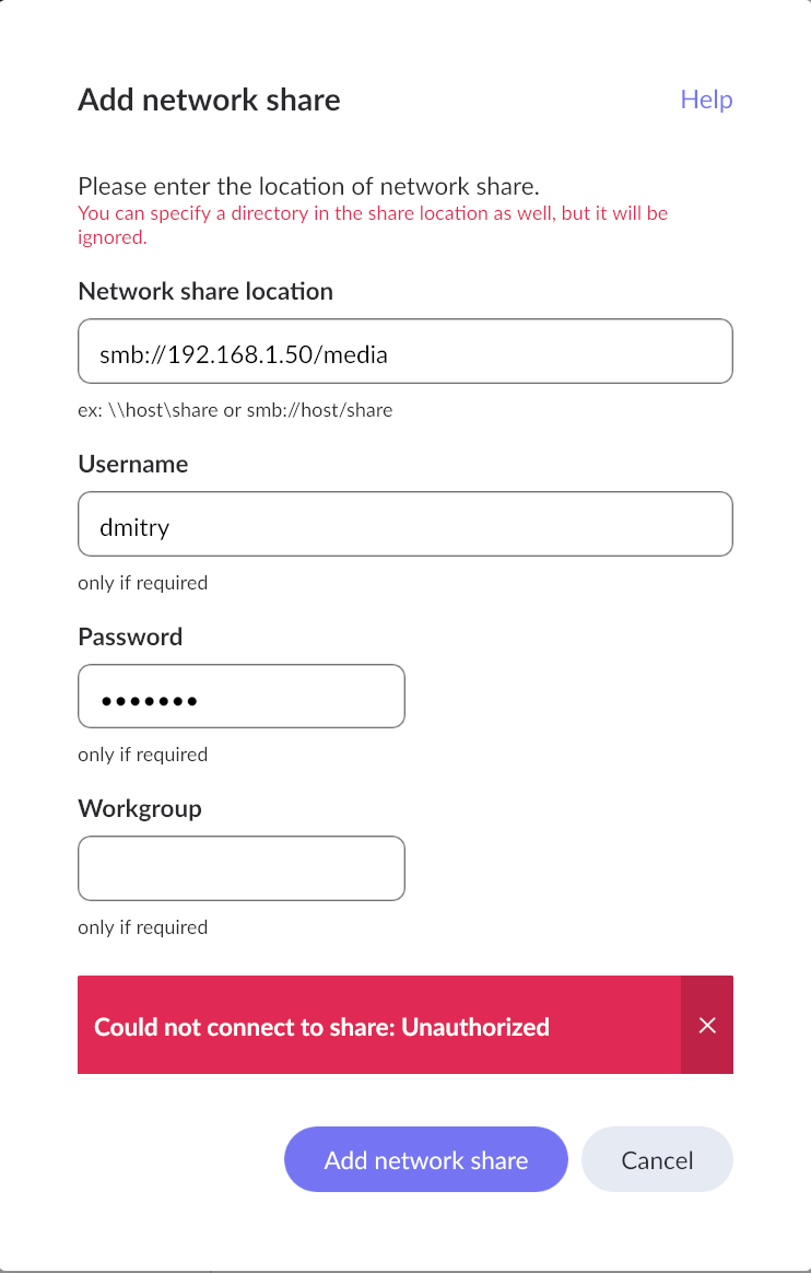

Hello @alex_h
I set SMB ver1 for my NAS. Now I get red error “Unauthorized” though I’m pretty sure my credentials are OK.
Besides I verified I can connect to NAS via SMB1 right from Audiolinux command line like this:
smbclient //192.168.1.50/media -U ‘dmitry’ -m NT1
NAS logs say connection is established via SMB1
User [dmitry] from [AUDIOLINUX2(192.168.1.70)] via [CIFS(SMB1)] accessed shared folder [media].

Have you tried to connect with those exact credentials from other PC ?
from the analytics data report we can see that it is more likely should look like smb://192.168.1.50/media/music .
Can you please try that ?
Regards.
I have tried and I can connect to the share from other PC.
Tried “smb://192.168.1.50/media/music”, still “Unauthorized”.
