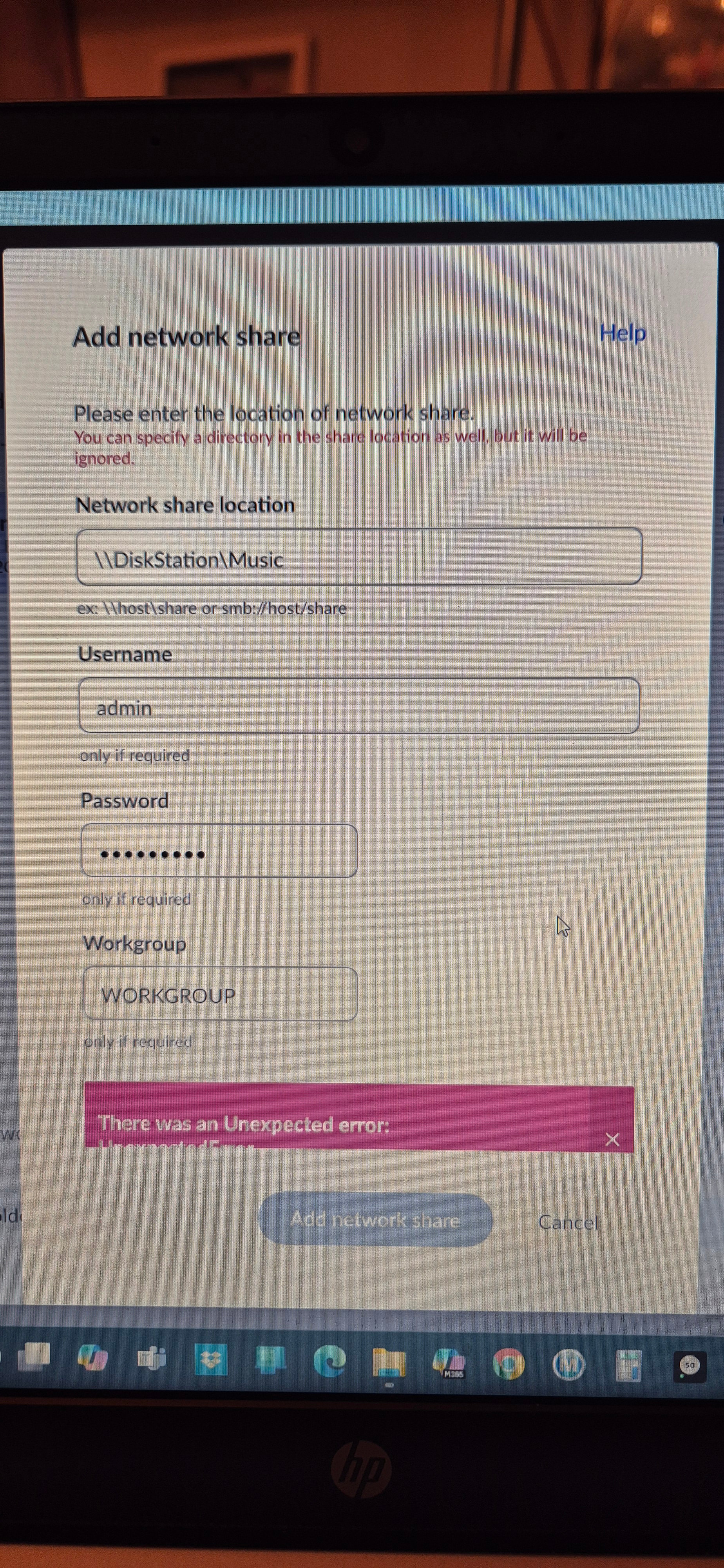

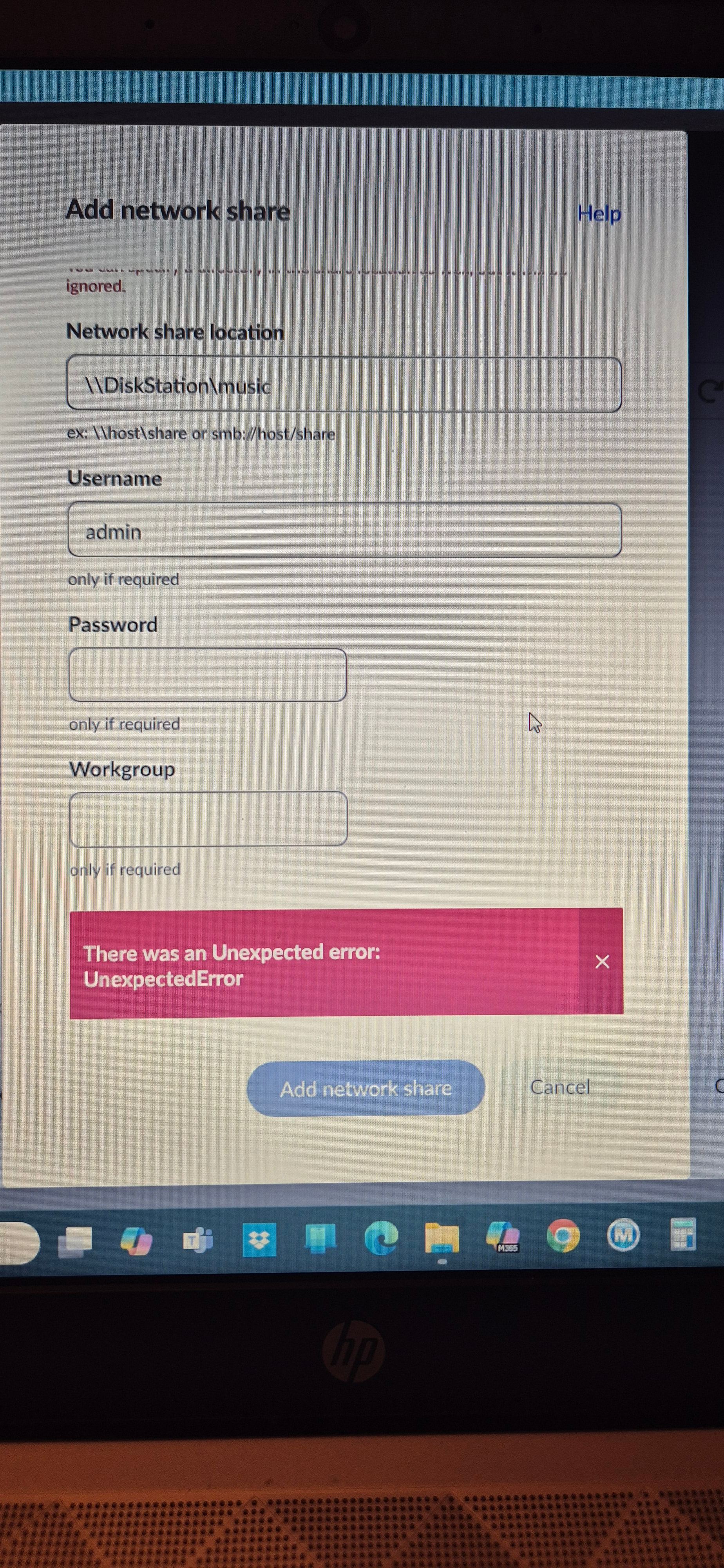

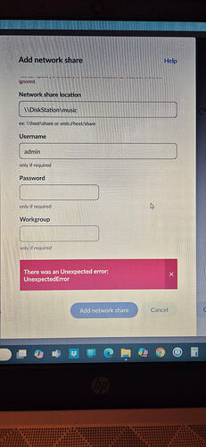

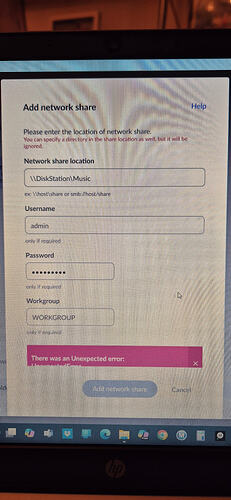

I’m entering the required info eg \\DiskStation\music along with my user name and password for the NAS. The response is “Unexpected Error”

I attempted to create network share using \\DiskStation\Music at 19.02 UK time with same result
Hello @dsgrayabz
Thank you for the screenshot! The “Unexpected Error” when adding a network share via a hostname (like \\DiskStation) usually means that your router or Windows is having trouble resolving that specific name on your local network.

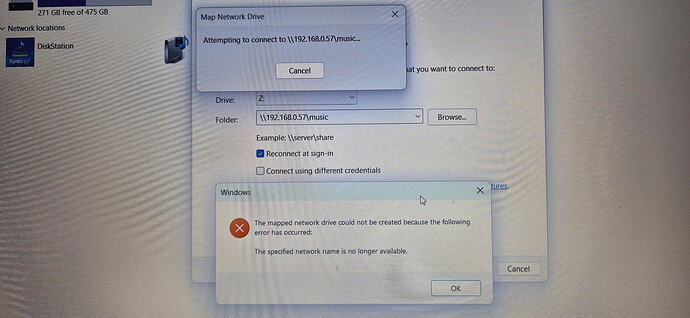

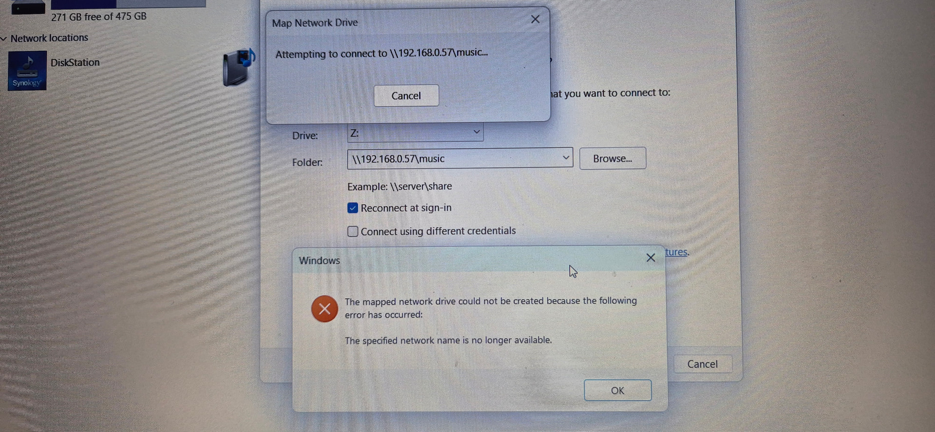

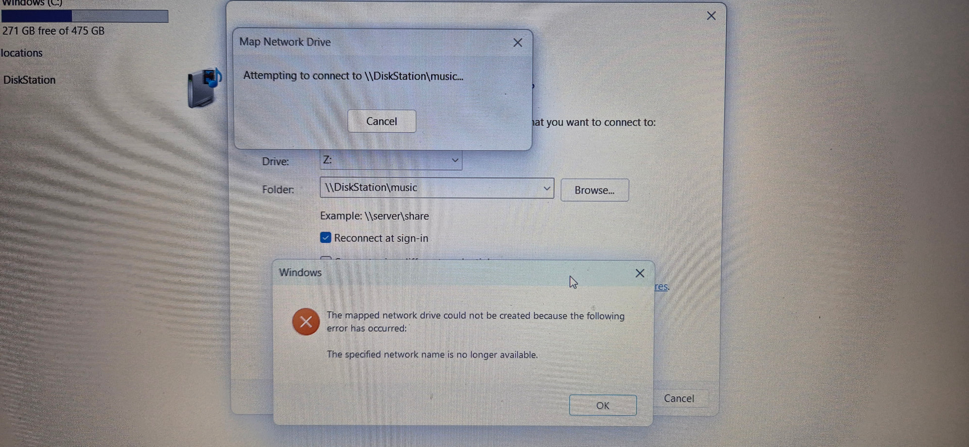

Unfortunately neither method has been successful. Using tge IP address in Roon returned tge same Unexpected error.
Mapping the drive returned the following errors using both File name and IP address
Hi
I have now discovered that the SMB settings in Windows for the laptop on which the Roon server is installed were not properly configured. I have now changed the settings and the files from my NAS are currently being imported into Roon :slight_smile:
