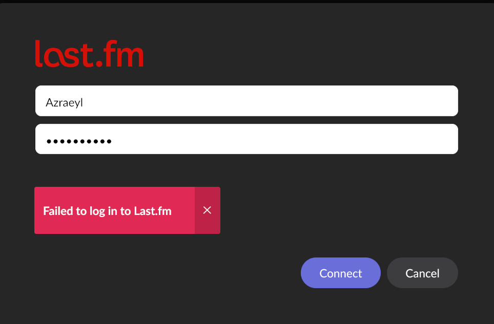

@vadim Vadim, my Last.fm login failed this morning (08:30 Amsterdam time) again. Took the steps when it happened a month or so ago. Disconnected Roon from last.fm, removed the connection on last.fm started up again. Trying to reconnect this time, but not log in! Failed to login to last.fm is the error message. No scrobbles this time. So the connection is lost, but can’t establish a new connection. Username and password are correct (from pwmanager). Can log in in last.fm Could you look into this, please? Something strange is going on.
I restored a backup from halve August, but still get the massage: Failed to login in Last.fm
Very annoying.
ps I didn’t change username or password this time. Out of the blue this message came this morning.

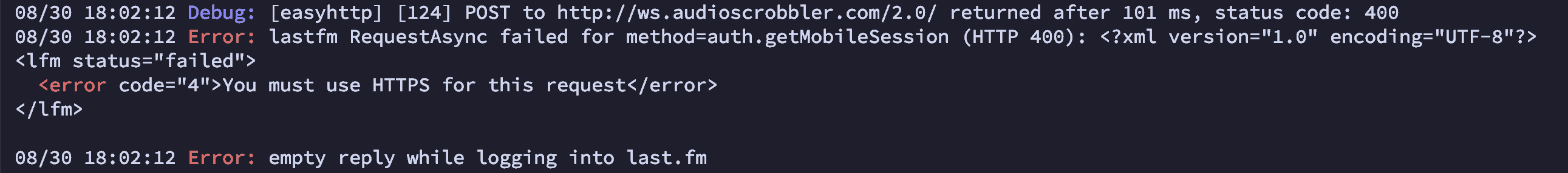

· Cannot login to Last.fm due to Roon making API call over HTTP instead of HTTPS
· n/a
08/30 18:02:12 Debug: [easyhttp] [124] POST to http://ws.audioscrobbler.com/2.0/ returned after 101 ms, status code: 400
08/30 18:02:12 Error: lastfm RequestAsync failed for method=auth.getMobileSession (HTTP 400): <?xml version="1.0" encoding="UTF-8"?>
<lfm status="failed">
  <error code="4">You must use HTTPS for this request</error>
</lfm>
08/30 18:02:12 Error: empty reply while logging into last.fm

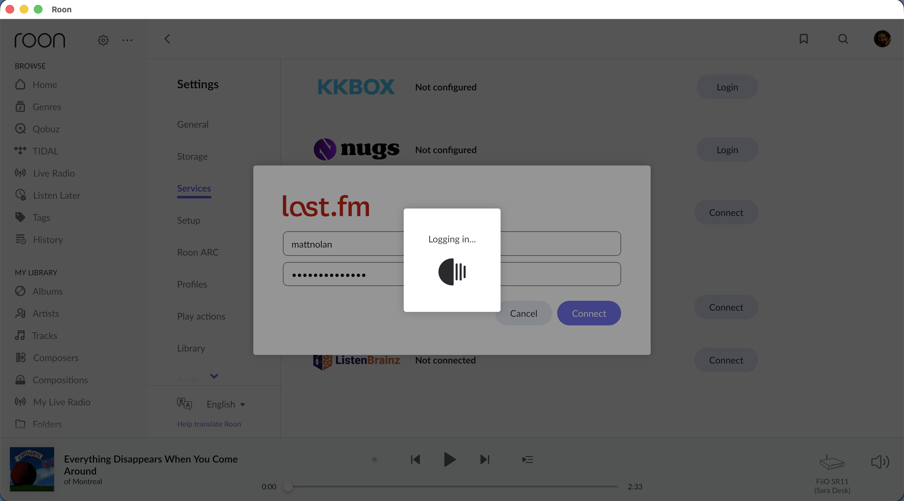

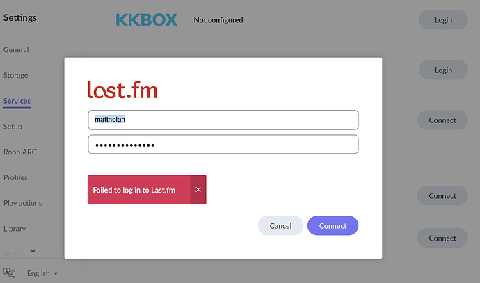

Backstory: I noticed some missing, random songs not scrobbled (I.e. I listened to several albums and two songs from each album didn’t scrobbled while all the other songs did).
Anyway, I disconnected Roon from my Last.fm profile and then disconnected Last.fm in my Roon settings.
Then, I tried to log back into Last.fm through my Roon settings.
However, I keep receiving Failed to Login message when putting in my credentials in Roon. (I confirmed they are accurate by logging out and back into Last.fm several times).
One Note: I did NOT change my Last.fm password. I only commented here, because the other thread I saw on this topic (not able to login to Last.fm) is closed.

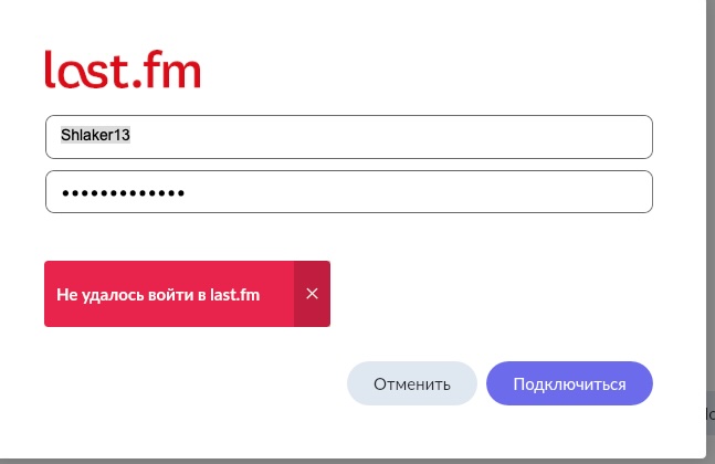

· When I try to connect, I get an error saying it cannot connect. The Last.fm website is working, and scrobbles are coming through from streams. I found information about the player cache and the authorization token; I uninstalled the app and renamed the folder so that the cache folder would be recreated, but it had no effect.I also tried creating a new Last.fm account and changing my password in case there were issues with special characters, but that didn’t work either.

Finally, I just tried logging in to Last.fm again at exactly 7:15pm Eastern (9/1). I had/have a concern you are going to say it is something with my network, as I’m not 100% sure how to troubleshoot that, but if you have any suggestions or guidance, I will definitely do whatever is needed!
