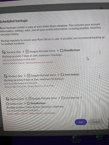

Here is the existing back up setting as shown in Roon:

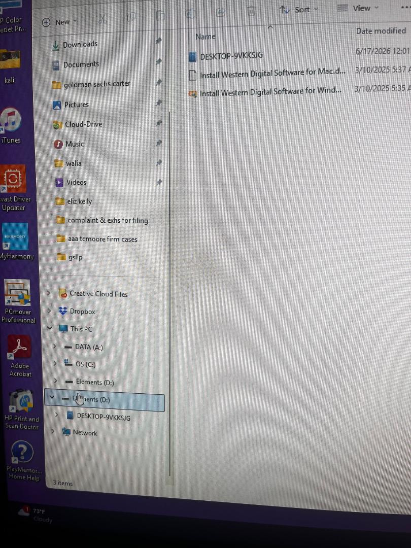

This is where I want to direct the backup instead, to my “D” drive:

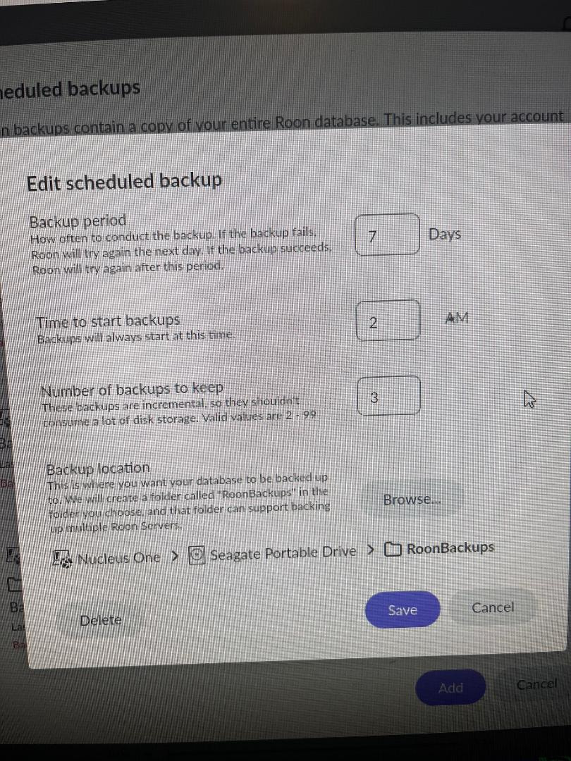

This is the display when I try to edit the setting:

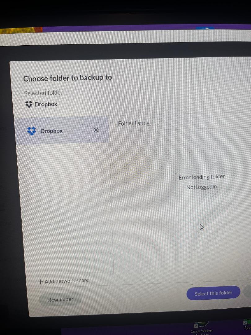

This is the dropbox screen that appears when I try to add or edit:
In answer to your question, my new external drive is connected to my PC, just as the Seagate was. I look forward to your thoughts. Thanks.

Roon backups can only target storage the Roon Server itself can reach, local storage on the Nucleus or a network share. A drive plugged into the remote PC isn’t visible to the Server, which is why the browse dialog only offers Dropbox.
Since your new drive is connected to your PC running as a Roon Remote, you’ll need to set up a network share from your Nucleus to your PC to recognize the drive.
That said, you could always attach the drive to the Nucleus directly, plug the external drive into a USB port on the Nucleus. It should then appear as a local backup destination (note the Nucleus expects exFAT, FAT32, or NTFS) so you’ll want to know the format of the drive in this case.
Otherwise, setting a network share is what you’ll want to do. Here’s a simple step-by-step for setting up a network share on the Windows PC so the Nucleus can back up to the D: drive.
