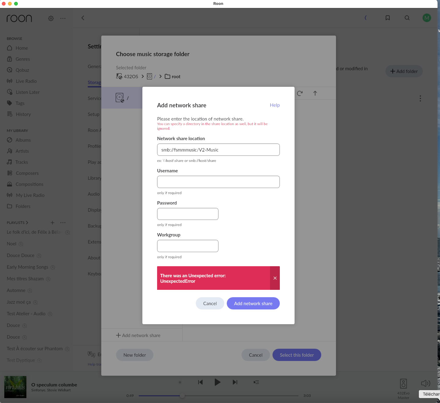

Unable to connect Asustor NAS to In 432 EVO Roon Core (ref#L83JDV)
Unable to connect my Asustor NAS In 432 EVO ROON Core
Modem : Helix by Videotron
Router : Unify
Switche : LHY Audio SW 6

Hello,
The Asustor NAS is connected to my switch.
The 432 EVO (Master) is connected to the same switch.
The LHY SW-6 switch is connected to my router.
I can’t bypass because the switch is far from the router and the 432 Evo and NAS is connected to the same switch.
Before using the 432 EVO, I was running Roon server which was installed on the Asustor NAS. Everything was going well.
I have uninstalled and erased Roon server in the Asustor NAS.
In the past I was using a Mac mini for the Roon Server : no difficulty in finding my NAS.
Roon works well with Qobuz
Thank you
Also, I have followed the tips in the FAQ
Some third-party firmware may provide their own means of connecting network shares (outside of Roon). Furthermore it might just be that the firmware is very outdated on your server and that is why you can’t successfully connect. Did you consult the 432 Evo manual or customer support already?
Hi @Michel_Maltais ,
I noticed that you have no username/password set there, I have yet to see a NAS with no user/pass before, are you able to double check your NAS account settings (or try to make a new account)? Usually you’ll also want to enable “Windows File Sharing” on the NAS side if that option is available. One final suggestion would to also try using IP address instead of hostname, I’ve sometimes seen Hostname be unreliable. Let us know if this helps!
