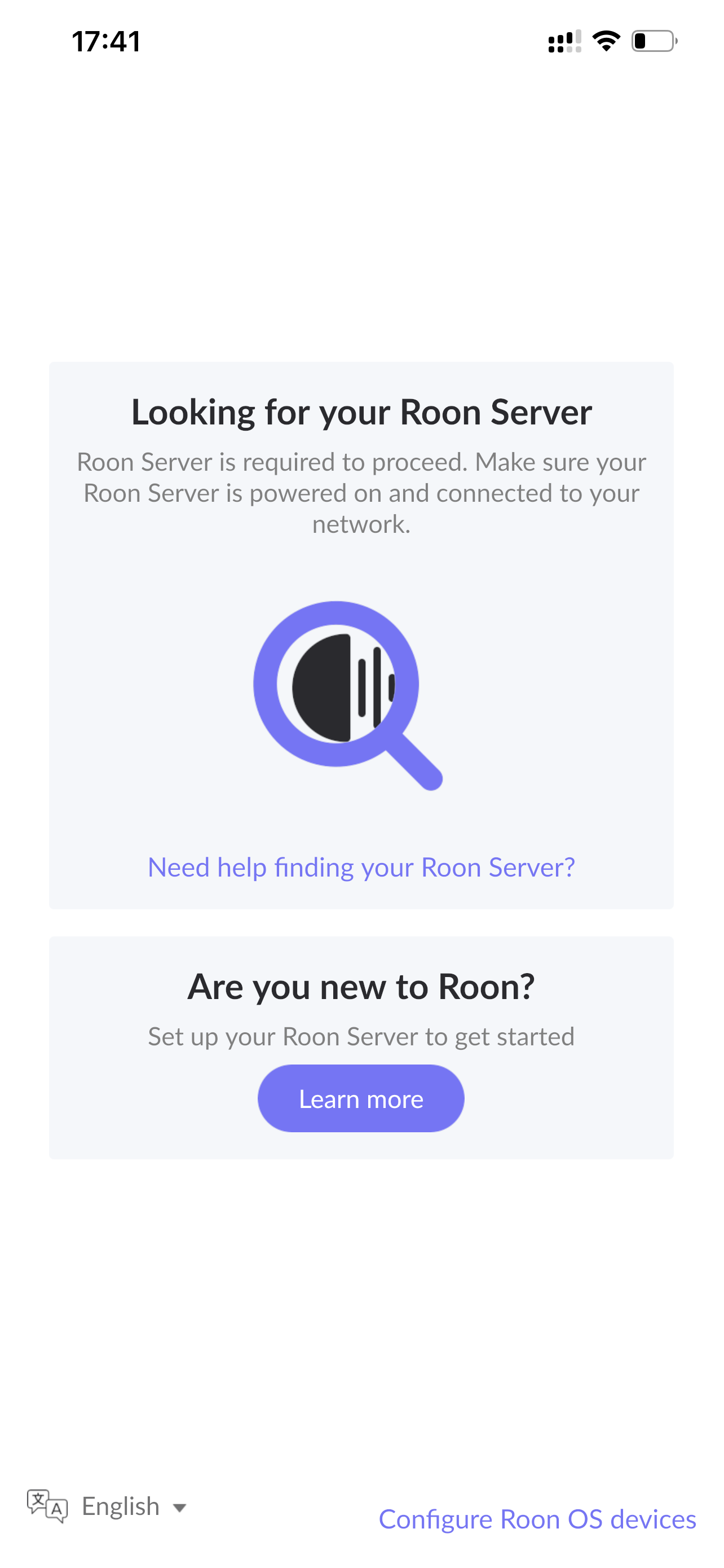

I can’t connect the app in iPhone with the nucleus.

Hi @goncalopitasoares ,
Welcome to the forum. Can you please confirm your network setup (model/manufacturer of all devices) and specify how your Nucleus is connected to the network? If you navigate to your iOS settings → Roon, is Local Network Access toggled on?
