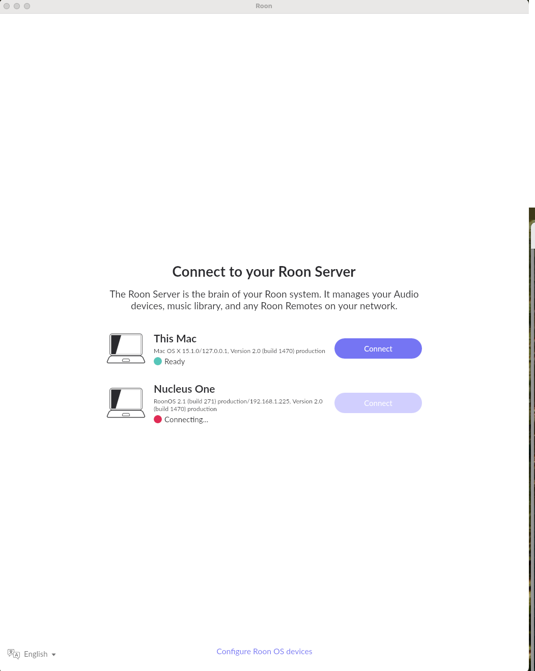

updated Macbook pro to latest software, when connecting to Nucleus One I get that it's connecting but it never connects
connect via ethernet, att modem

Hi @tom1,
Thanks for reaching out to us about this issue. Can you please ensure that your Mac server is deauthorized? You can only run one Roon server instance per a license and I see from your screen shot that the Mac server is active. If that doesn’t help please try the test that @Singleton suggested.
