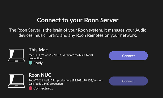

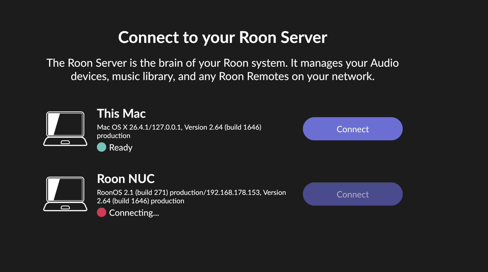

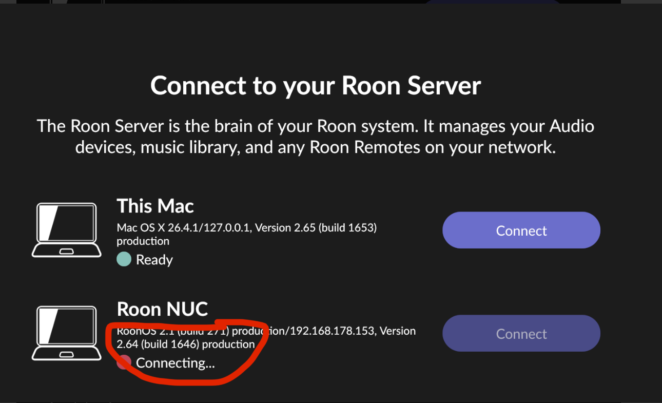

On my home network, I am ale to connect to my Roon server with the iPhone remote, but not from the Macbook remote after I restarted ROCK. IT shows "this MAc" as a server and sometimes shows ROCK "connecting" but fails to connect and stops showing ROCK
Rock is connected via ethernet to the router (and it used to work fine before I restarted Rock. All remotes are using Wifi.

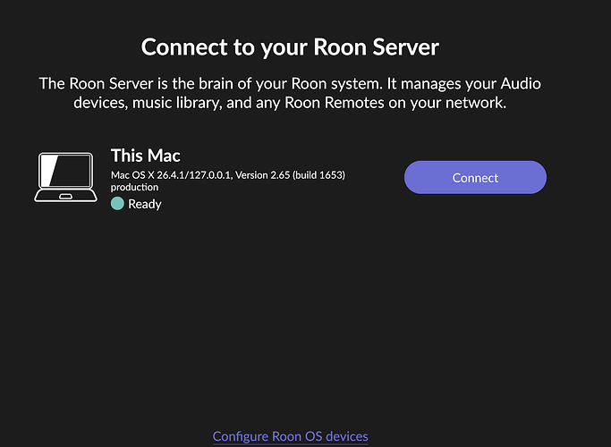

I followed the steps as requested. Unfortunately I still have the same behavior: as soon as I launch Roon, it detects the NUC running Rock but fails to connect, then removes the NUC from the list and only shows This Mac. When I click on configure roon OS devices, it opens a browser at http://100.90.115.98/ which is not on my network

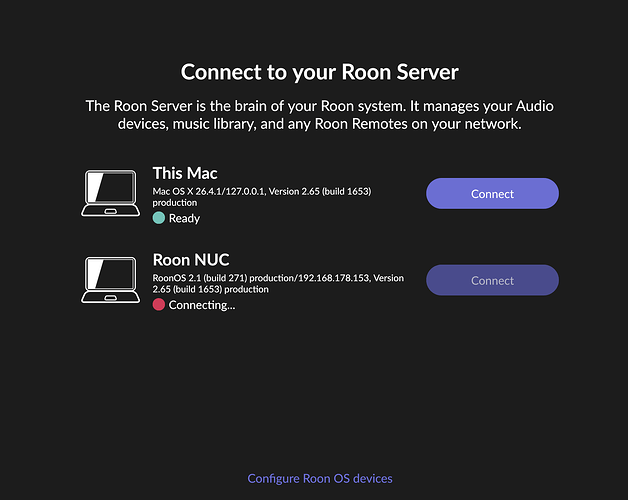

Hi @Thierry_Bruno,
I believe @Suedkiez is spot on correct with the above reply - it now looks like your ROCK is running the latest version of Roon Server, are you able to now connect?
Thank you! :+1:

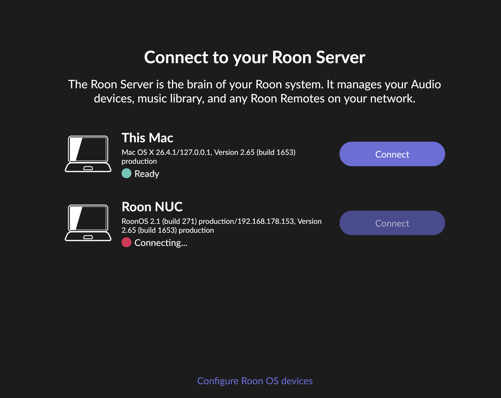

unfortunately, it still doesn’t work, same behaviour as described previously
It’s ok, I fixed the problem which was linked to the Mac not removing an old roon entry in privacy and security nlocal network settings; I uninstalled roon, reboot and the corrupt entry was gone and then reinstalled roon. It detected the NUC Rock immediately and connected to it.
