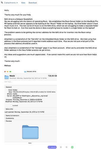

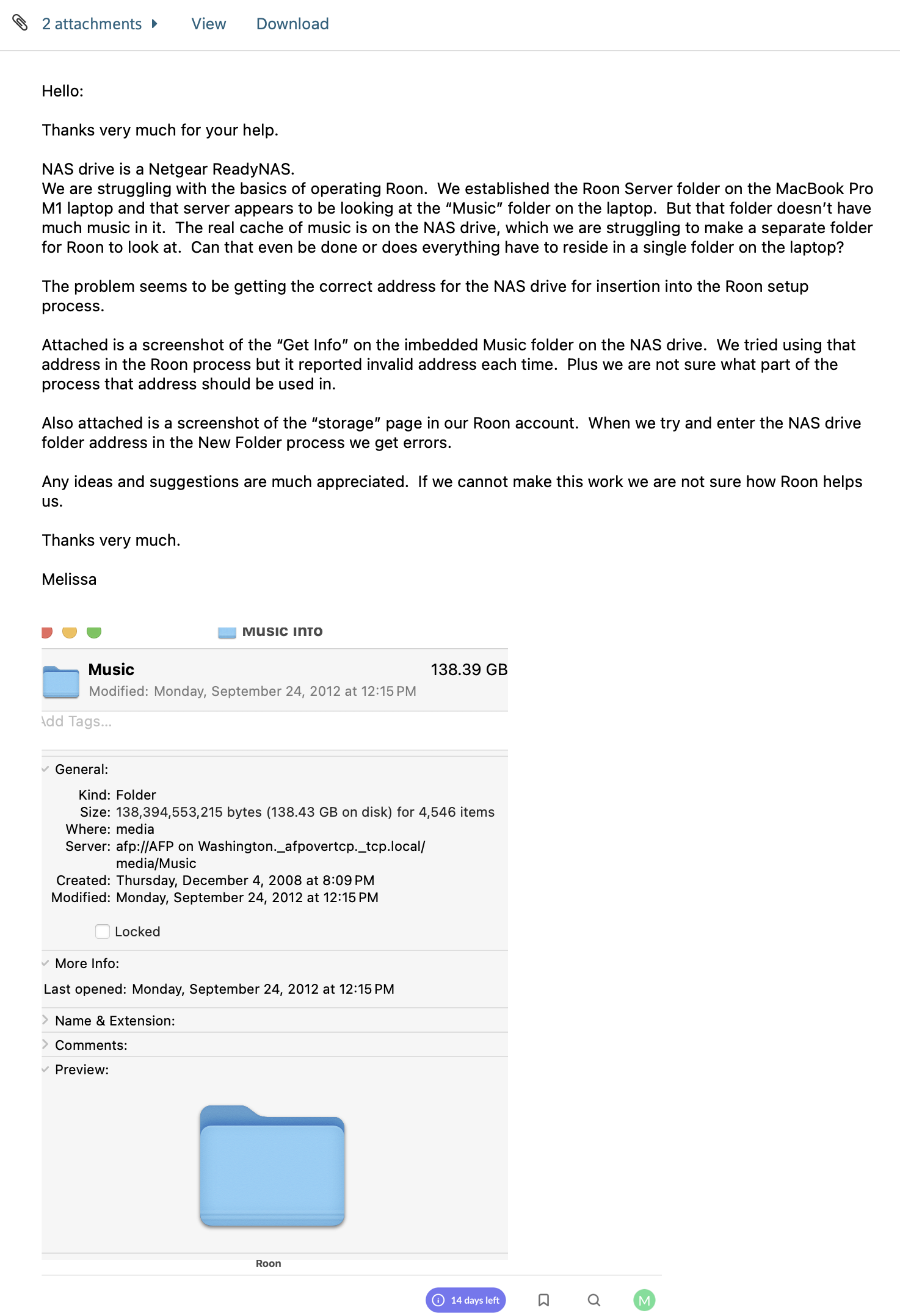

Hello: Attached is a copy of my earlier reply - mistakenly sent as reply to your email!
We need help figuring out the basic of Roon, attaching music sources, etc.
Thank you.

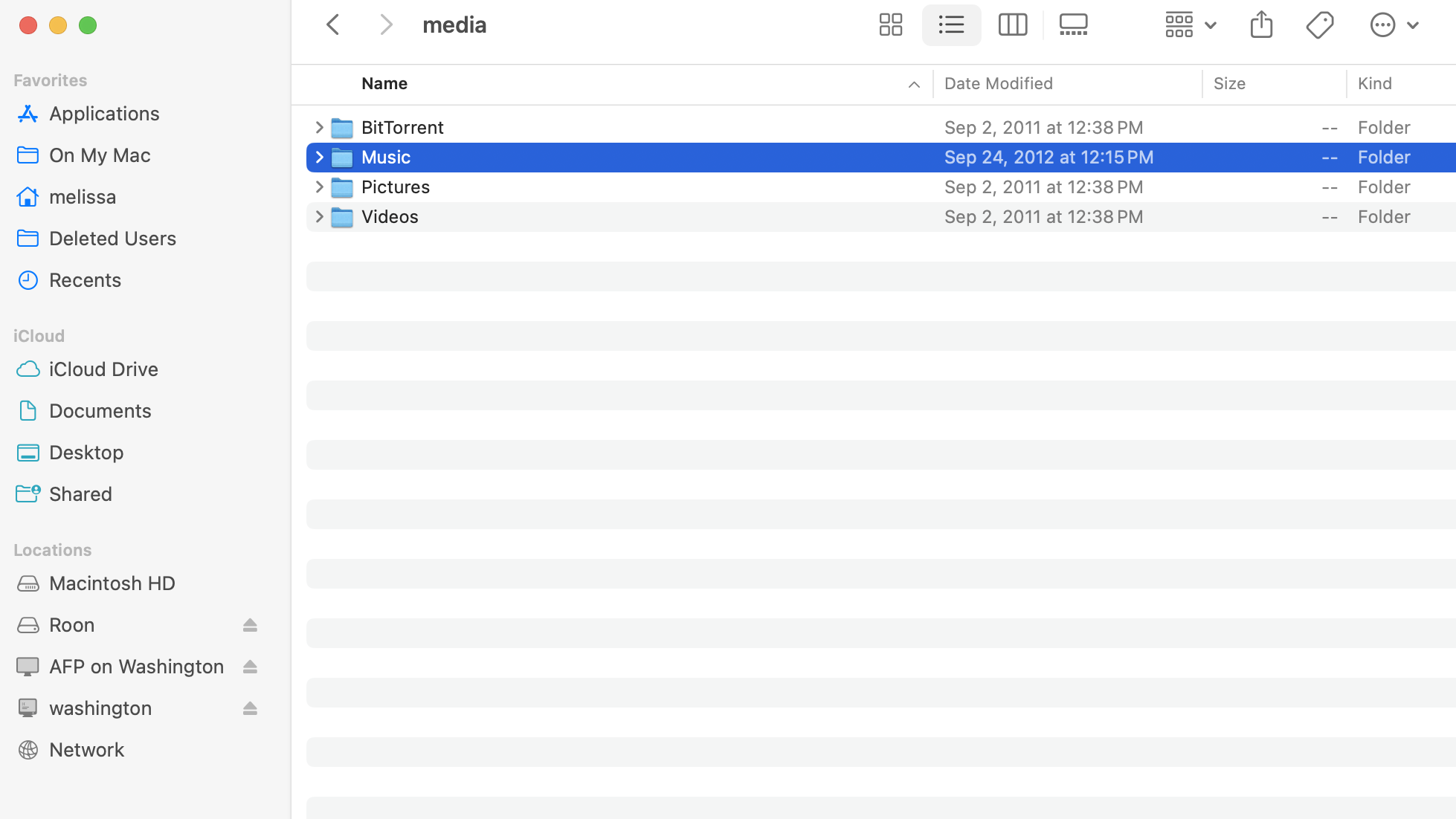

Hi @melissha,
The file settings you’ve shared in your email screenshot indicated that this MacOS machine is mounting the NAS via AFP. This is a separate protocol for network shares from the one upon which relies (SMB 2.0 or SMB 3.0).
You will need to enter your NAS administration page as @DDPS suggested above and ensure that SMB 2.0/3.0 is enabled and is the default network sharing setup for this location. Log into your NAS’s web interface (usually accessible through your web browser) and navigate to the file sharing settings or service settings. Look for options related to SMB/CIFS or file services. Enable the SMB service and save the changes.
From there, the machine should generate a new address location starting with SMB instead of AFP. You can use this address to set up the network share in Roon. If that’s not working, you’ll need to make sure you follow the steps to enable file sharing here:
