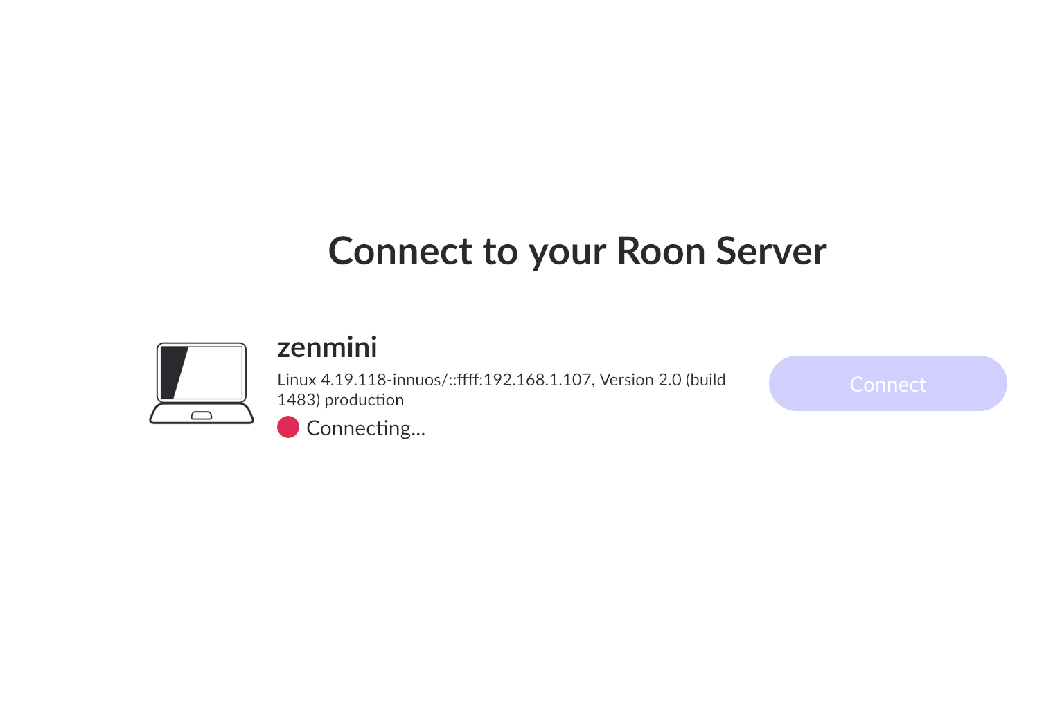

I can log in to Roon on a PC, or a gen 6 ipad, but cannot connect with a 2024 ipad m4 pro. I can see the zen mini mk3 via my innuos with Roon Core as it base, but cannot connect via Roon
roon core is on a zen mini mk3, using and ipad m4 pro for roon, zen mini is connected to router via cat6 cable and ipad is connected to router via wifi, router is a TP-Link AX5400 model vx420-G2h

I have rebooted the zen mini several times and still no response. Again i can see the server through my innuos and the IP address is the same as for that displayed in roon. This address is different from when i logged in via the older ipad. Checked the settings and all okay.
Still no response.

Issue resolved. The solution ended up being resetting my iPad. I guess when it replicated from my phone the settings on the phone were transferred to the ipad(?). My phone could not connect to Roon either, but this is a work phone and perhaps there were some settings that would not let Roon connect.
So all good now.
