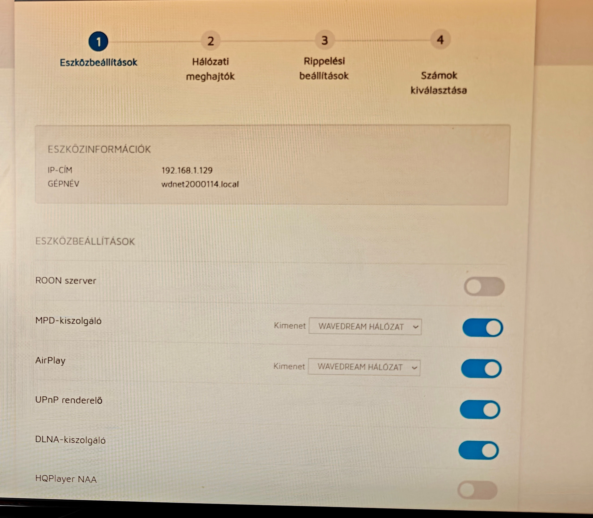

· After the Roon update on April 29, 2026, the service stopped working on the Rockna Wavedream Net streamer. The update was performed normally through the Roon app for Android, and there were no power-off issues. I've done this many times before. Now I can't use Roon (an annual subscription). The streamer manufacturer says it's not their fault, but it's also impossible to revert to the previous version of Roon.

Roon doesn’t work for me either, the Rockna web interface doesn’t let me turn on Roon. I temporarily returned to the nconnect application.
