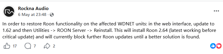

Rockna posted this on their facebook. It does not work for me. With mozilla I press reinstall and nothing seems to happen. Perhaps it’s because im still running the latest roon on my pc and phone so it won’t talk to the NET??

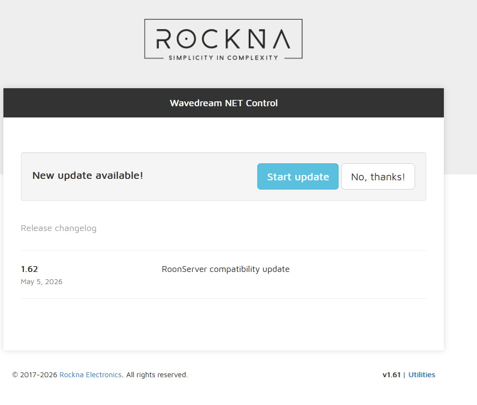

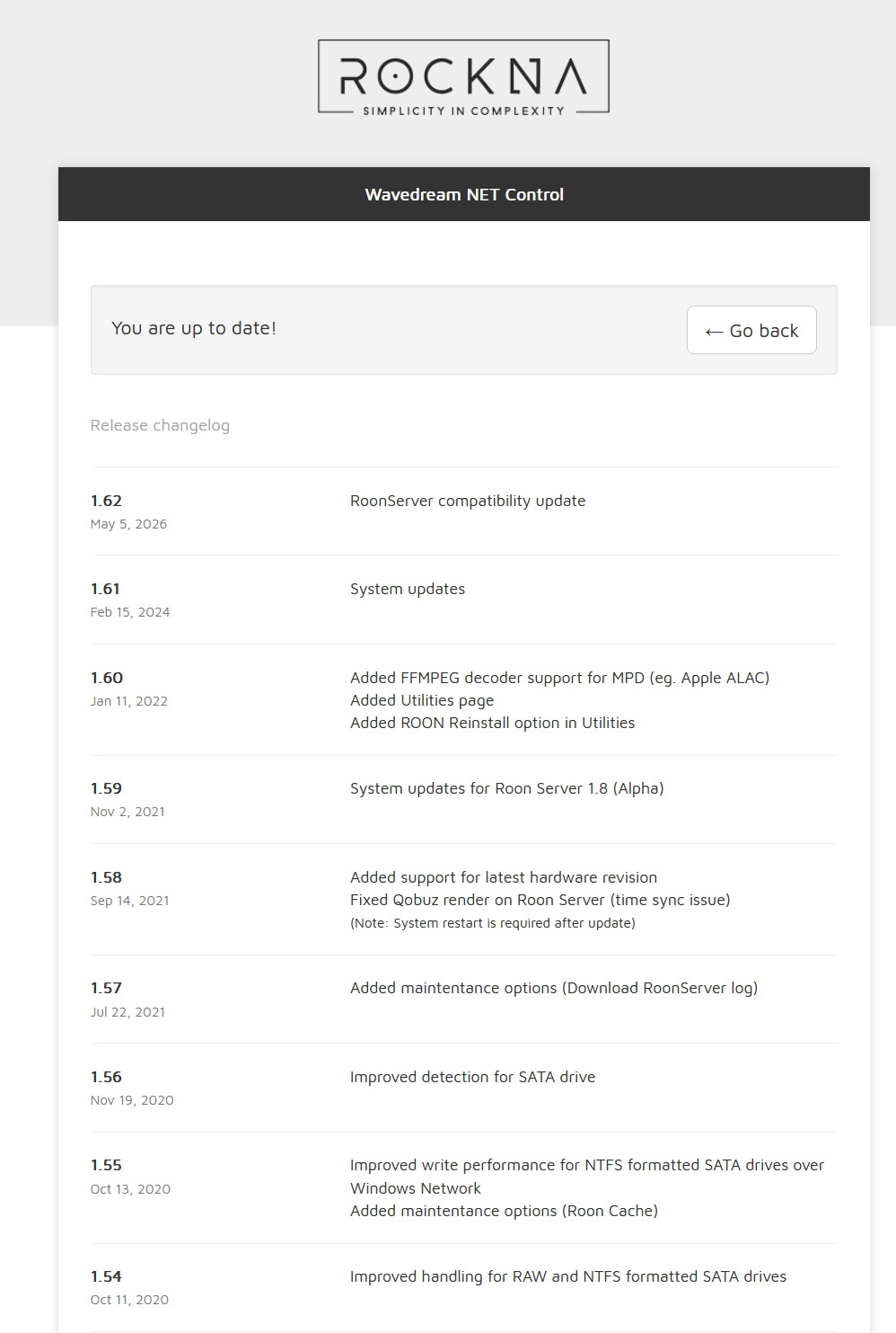

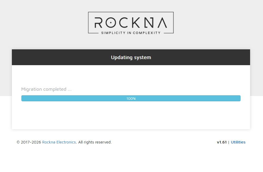

Rockna has just released an update version 1.62. Using the WEB console, I performed the update, but it did not help, including restarting the system. Perhaps you need to do the same with Utilities → Roon ->Server ->Reinstall ?

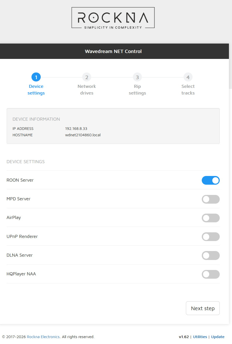

I will add good news to my review - despite the fact that the update to version 1.62 did not change anything, I reinstalled roon (In Wavedream NET Control: “Utilities”→”Reinstall”) and the roon checkmark turned on!
However, my roon client on the tablet still did not see the roon server.
Then, I chose “choose another roon server” in “android roon remote app” and finally, my rockna roon server was detected.
I had to configure it first, but now my roon+ qobuz are working!

I asked Rockna a question about upgrading to the latest version of ROON and received an answer according to which I understand that the latest possible update for roon server 2.64 and the update version 1.62 from Rockna only commits and makes it impossible to install further versions of Roon.
