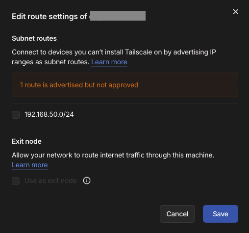

Just need some help here please, I’m now noticing Tailscale shows a “Subnets(!)” error message in the admin console: “This machine has unapproved routes. Review this from the ‘Edit route settings…’ option in the machine’s menu.”
Sorry but I’m unclear where a network flag like -tun would go?
Here’s my current docker compose configuration. I also tried pointing TS_ROUTES to the exact subnet address of the UGREEN, but that didn’t seem to work. Is the port correct? Networking is admittedly not my strong suit, I thought /24 was kind of the default control port?

@vadim actually, disregard the last reply, aside from the Tailscale “Subnets!” error message part. I didn’t realize the setting was right there in the Tailscale admin console. Just needed to check the box and save :man_facepalming:
Confirmed ARC now plays via cellular. Appreciate the help all!
