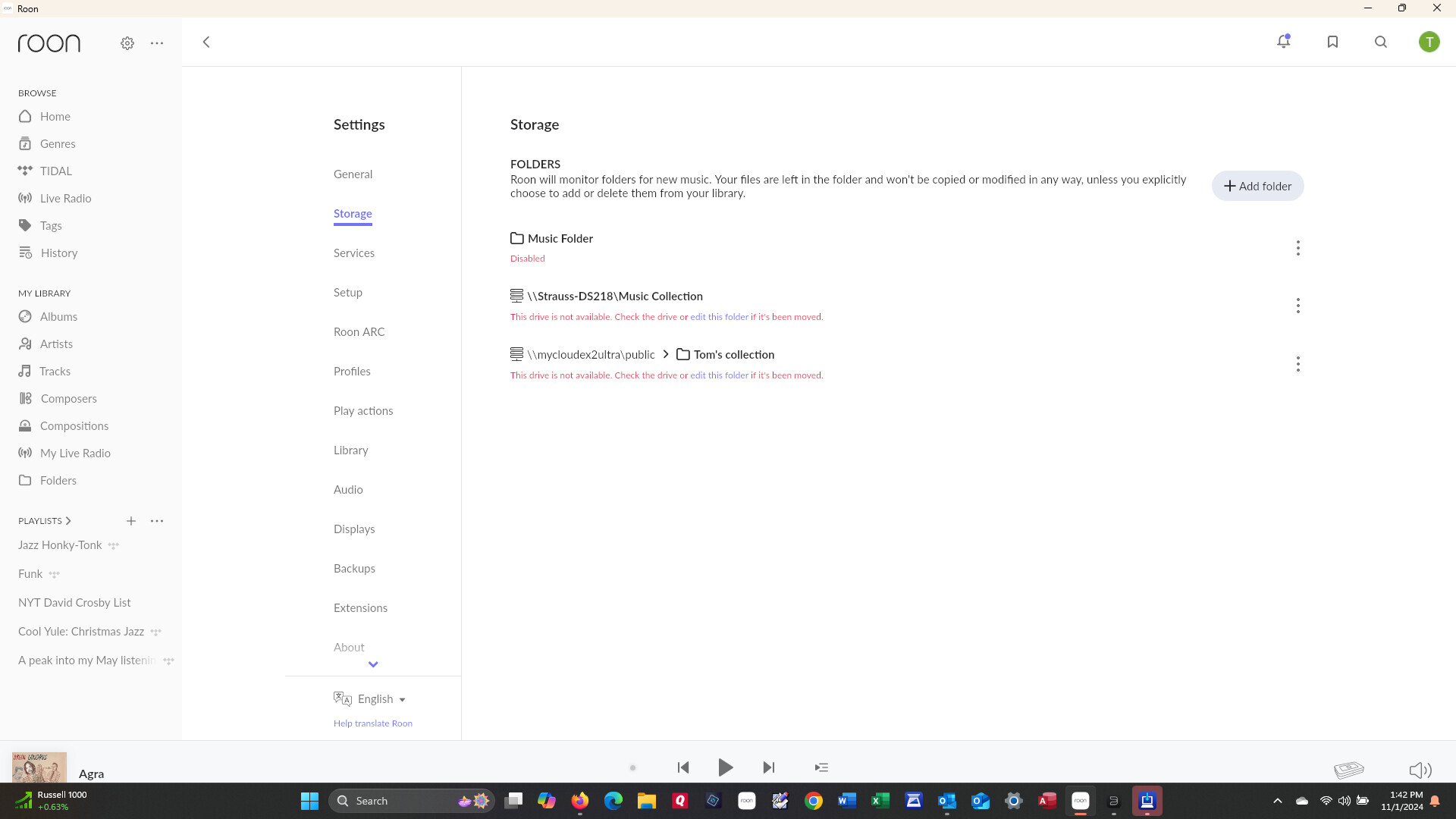

Thanks for writing in to ask us about this issue. We activated diagnostics on your account and found that Roon can’t find the NAS at the specified network path. Can you share a screenshot of your Roon settings → storage page?
There are two servers shown, the one in question is the Strauss-DS218. The other is for another home.

I think I got it fixed. I logged in to my NAS successfully. Earlier I believe I had a typo in the password multiple times, confusing a ‘b’ for a ‘6’.
Roon is now scanning the NAS.
