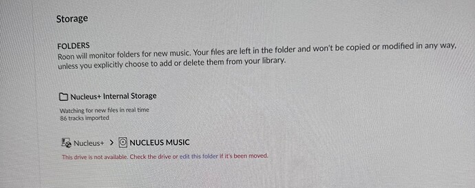

Also, what do you see under Roon → Settings → Storage? A screenshot of that section would be appreciated to help us better understand the setup.

Roon—>Settings–>Storage does not find the external hard drive. A screen shot is attached.

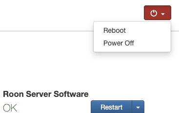

Thanks for the update! In the future, if you’re shutting your Nucleus down often, the safest way to do so would be from the webUI of your Nucleus - you can access it via Roon's Settings>Setup>Find Roon OS> and Click the IP address
This will open the webUI via your web browser (you can also just copy and paste your Nucleus IP into the web browser), to which you can then click the red power icon arrow in the upper right-hand corner > power off.
