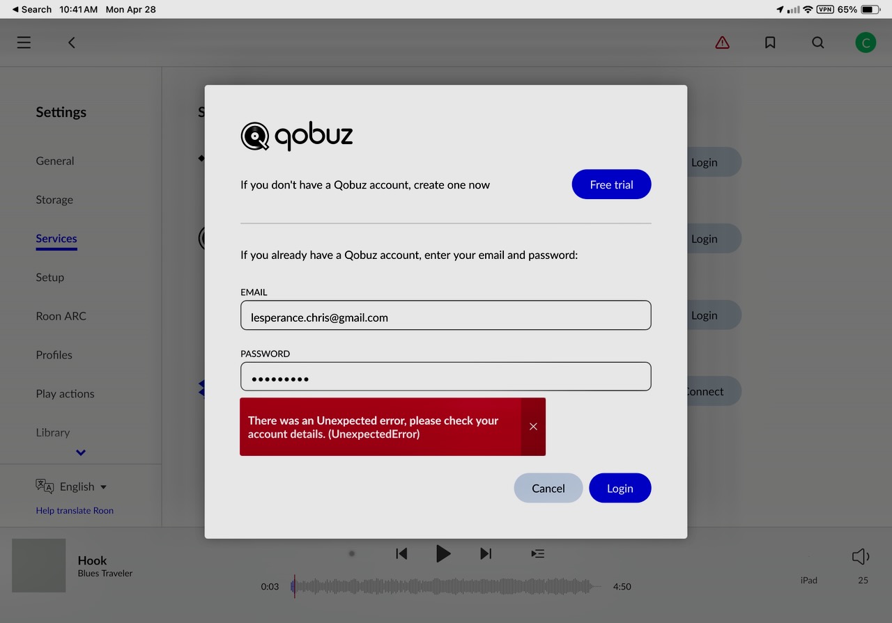

I can't get Qobuz to connect through Roon - my account is fine and it worked previously.
I have Roon installed on a QNAP TS-473 over a Google Nest network. I have multiple devices including a WIIM streamer and a Moon 280D. I interface with Roon over an iPad and and iPhone. Everything is updated with the latest firmware, OS etc.

That didn’t solve the issue. Is there anything else that I can try?

Hi Daniel,
I went digging into this. And while I was poking around the network settings, I found an IP conflict. I reset the addressing to dynamic, and the problem is solved. ROON is working much better now.
Thanks for your help.
Chris
