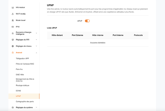

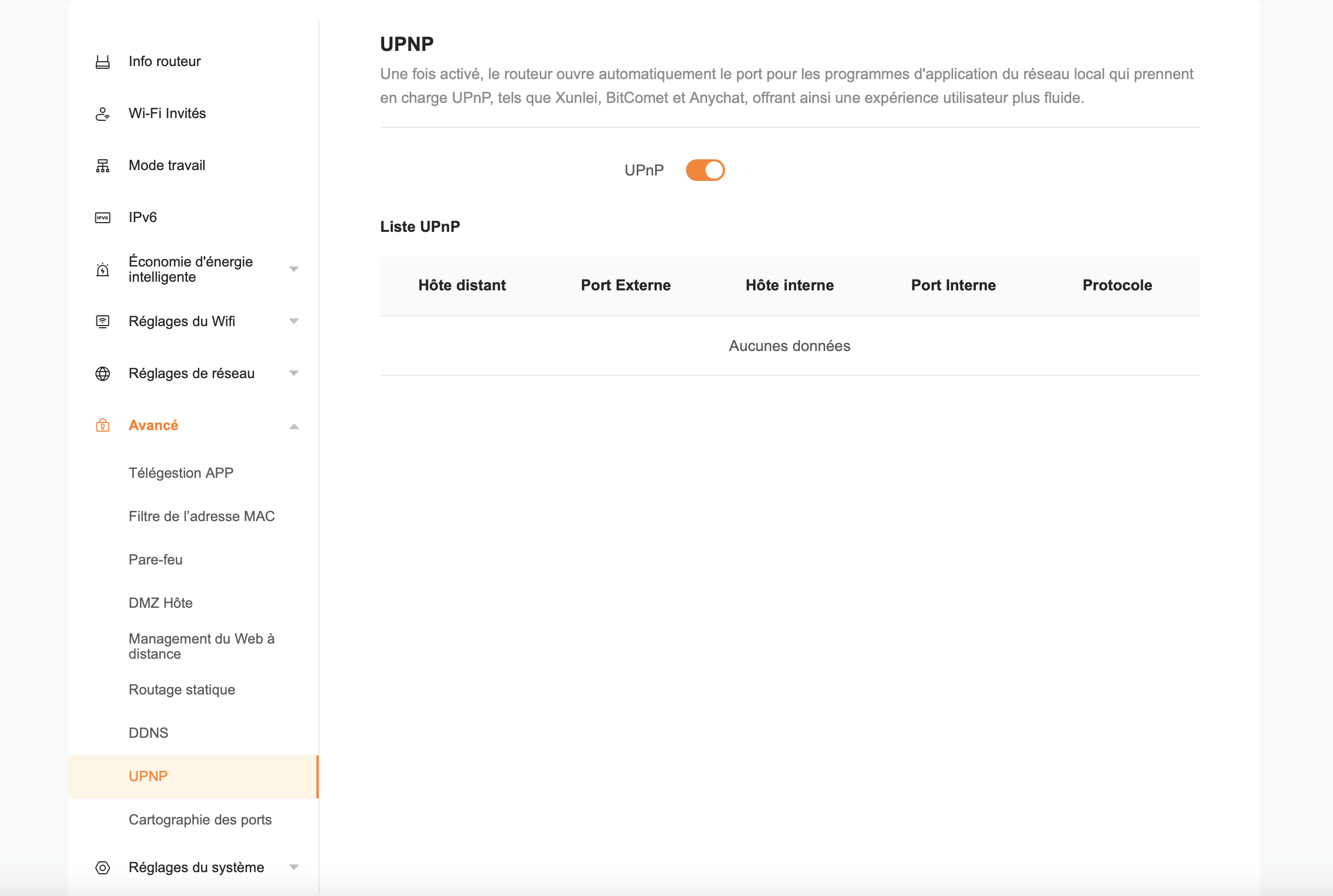

Bonjour,
Je n'arrive pas à me connecter à mon serveur avec Roon arc. J'utilise un système Wifi 6 mesh Tenda nova avec plusieurs modules. Le Wifi de la box internet est éteint donc un seul réseau Wifi marche. Dans les réglages du routeur, l'Upnp est bien activé. Voici les données du diagnostic :
"ipv6_connectivity": {"status":"NetworkError","status_code":502,"error":"error: Error: connect ENETUNREACH 2001:3::96c6:91ff:fe1c:fb1e:55000, response code: undefined, body: undefined"},
"ipv4_connectivity": {"status":"NetworkError","status_code":504,"error":"error: Error: ETIMEDOUT, response code: undefined, body: undefined connected? undefined"},
"external_ip": {"actual_external_ip":"88.fff.ggg.hhh","actual_external_ipv6":"2001:aaa:aaa:aaa:bbb:ccc:ddd:eee","router_external_ip":"null"},
"natpmp_autoconfig": {"status":"NotFound"},
"upnp_autoconfig": {"status":"NotFound"}
Merci pour votre aide
ISP : free
network devices : Tenda Mesh WiFi 6 AX3000 Nova MX12
MacOS : Sequoia 15.1

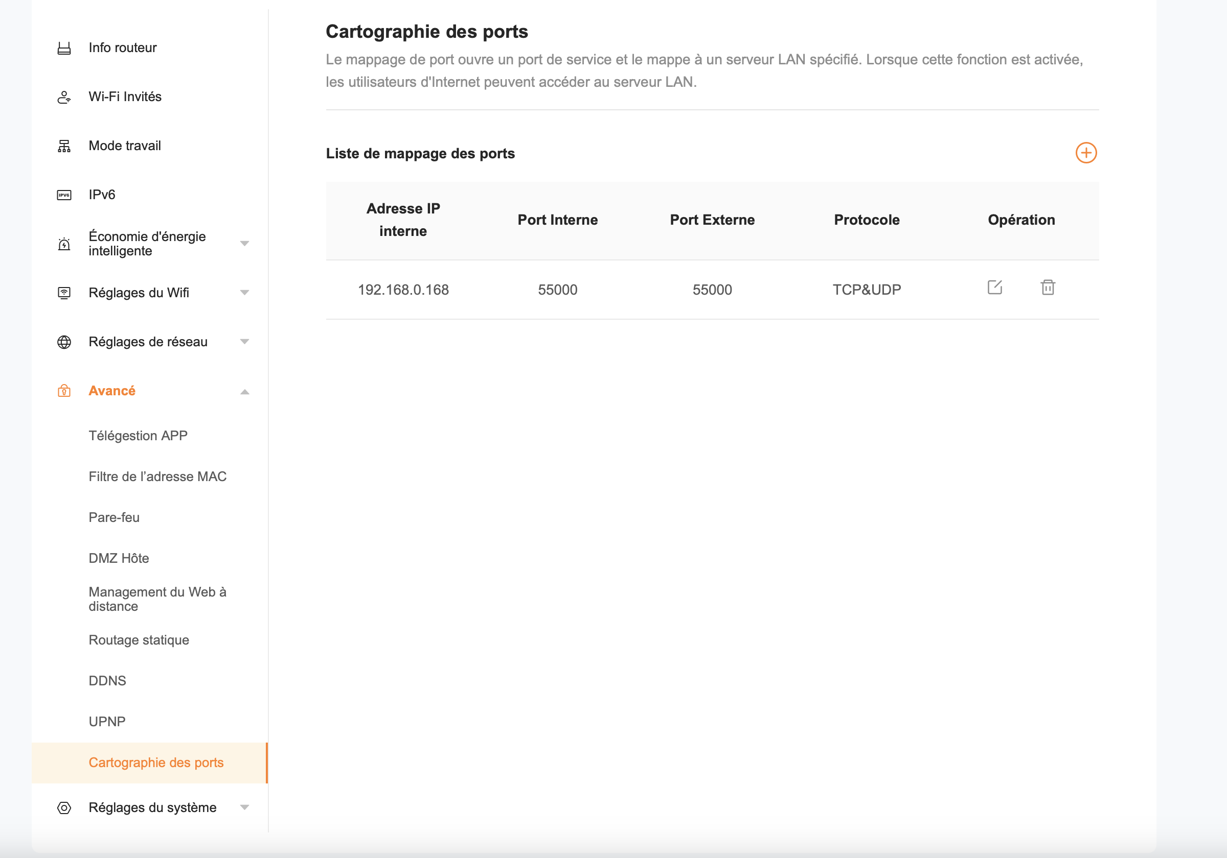

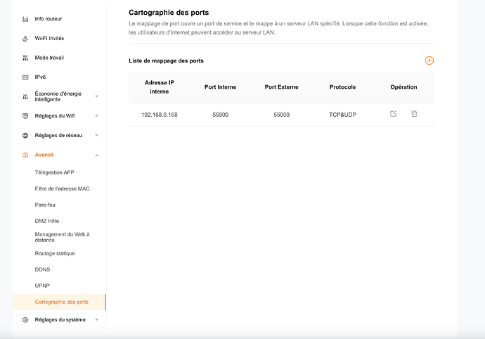

Hi @Vianney_Bouygues,
The snippet you’ve pasted from Roon → Settings → ARC indicates that RoonServer detected neither a UPnP port forwarding service (automatic configuration) nor a manual port forwarding rule in the router.
You can activate port forwarding on the Tenda mesh system by following this guide. For the internal/external port, use the port number listed in Roon Settings → ARC. Similarly, use the IP address listed for your Nucleus for the IP in the port forwarding rule.
If you have a second router in addition to the Tenda unit, you will need to create an identical port forwarding rule there using the same port number and IP address.
Please let us know if this helps.

Thank you for your answer. Unfortunately it still doesn’t work :roll_eyes:
It is frustrating
If you’re having trouble with the port forwarding do you want to try Tailscale instead? A lot of our users find that easier. This article can walk you through doing that.
