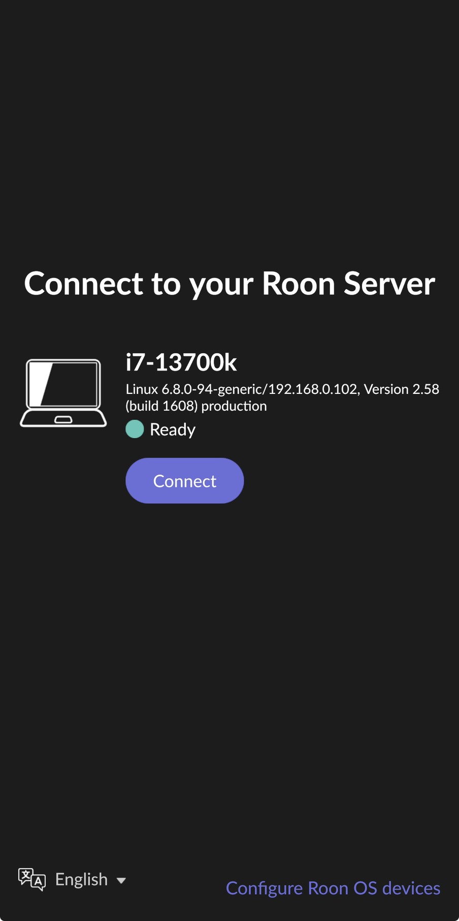

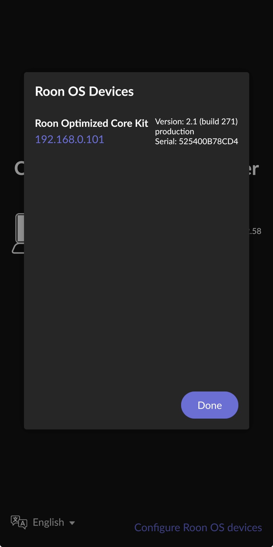

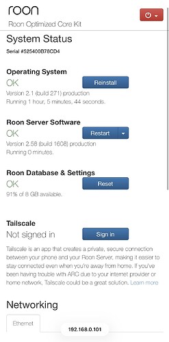

I've suddenly been unable to connect to my Roon Rock app for the past two days, but I can still find it in the Roon OS settings, access the Rock page by entering its IP address, and connect normally using Roon ARC. The problem persists even with other phones or reinstalling the app. Is there any way to resolve this?

We’ve reviewed the diagnostic report from your device, and your Roon ROCK appears to be functioning normally.

Hi @Z7481592630,
We see both a Linux and a RoonOS (ROCK) server active on your network. It’s not clear which you use as your primary RoonServer, but the latter is hosted on a virtual machine.
Please take note that we can’t guarantee Roon will function in a virtual environment.
ARC can’t retain session authorization between servers. If you’ve migrated between your Linux server from ROCK, you’ll unfortunately need to deauthorize ARC’s connection to the first server or reinstall the app.
