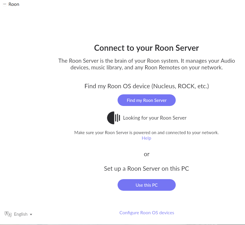

I followed exactly the procedure but after completing the installation and running the ROON REMOTE on PC, it gives this looping icon "looking gfor your Roon server " like eternity. What am i missing? Im not a computer savvy.
Good day @Ronaldo_Cristobal !
If you want to run Roon Server on the PC which you have sent a screenshot from please just select an option “Use this PC” as it’s shown on your screenshot.
Regards.

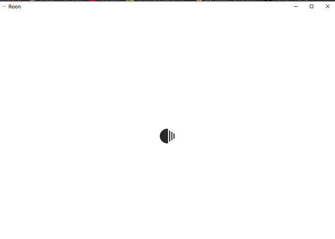

Yes I select use this PC to setup your Roon Server but for 3 to 4 hrs is not doing anything, all I got is the image below setting it up.
Hello @Ronaldo_Cristobal
Thank you for the update.
From the screenshot attached, it seems that Roon is still trying to load the database. Would you kindly confirm that you have removed all Roon-related folders under the folder :

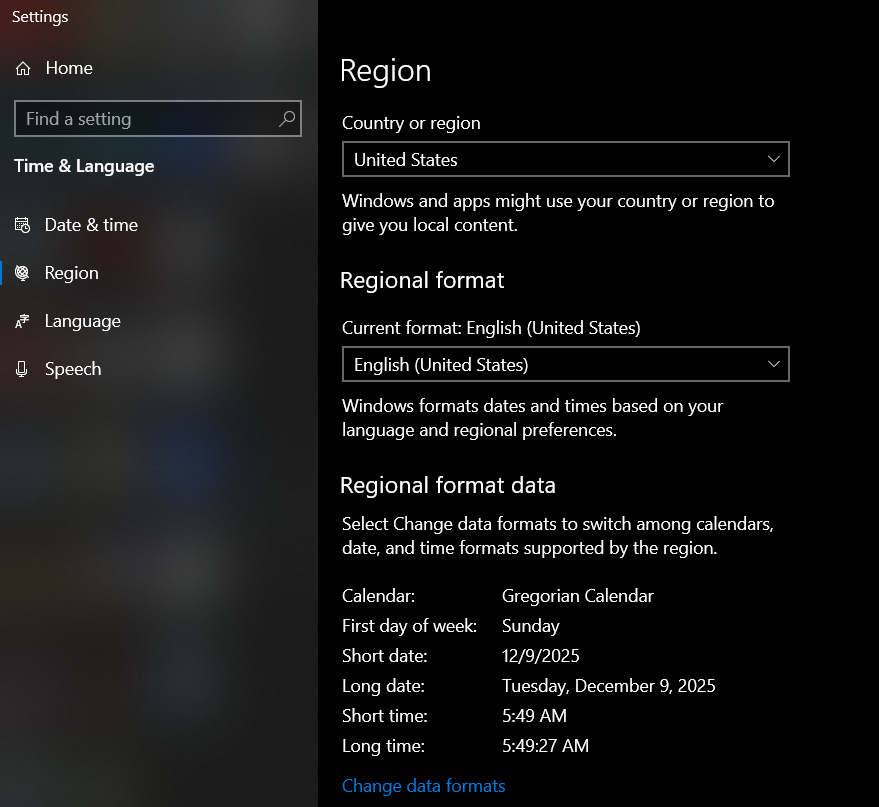

To resolve this, please check the following:
  1. Region and Language Format
Go to:
Settings → Time & Language → Language & Region
Please temporarily set the Regional Format to:
English (United States)
or
English (United Kingdom)
Then restart your machine.

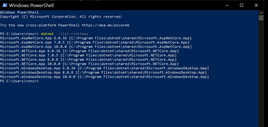

  1. Check .NET Runtime
Roon uses .NET 6, and Windows should have this properly installed.
You can verify this in PowerShell:
dotnet --list-runtimes
You should see:
Microsoft.NETCore.App 6.0.36
If it’s missing or corrupted, reinstalling the .NET 6 Desktop Runtime will correct it.
Please try the steps above and let us know the results.

Thank you for the information provided. I executed exactly the procedure as specified. I am still getting .NET Runtime eror. see
snippets below:
Thanks
It is working now after the procedure provided but It worked when I started to turn off Windows Firewall Defender. Thanks for all the help.
