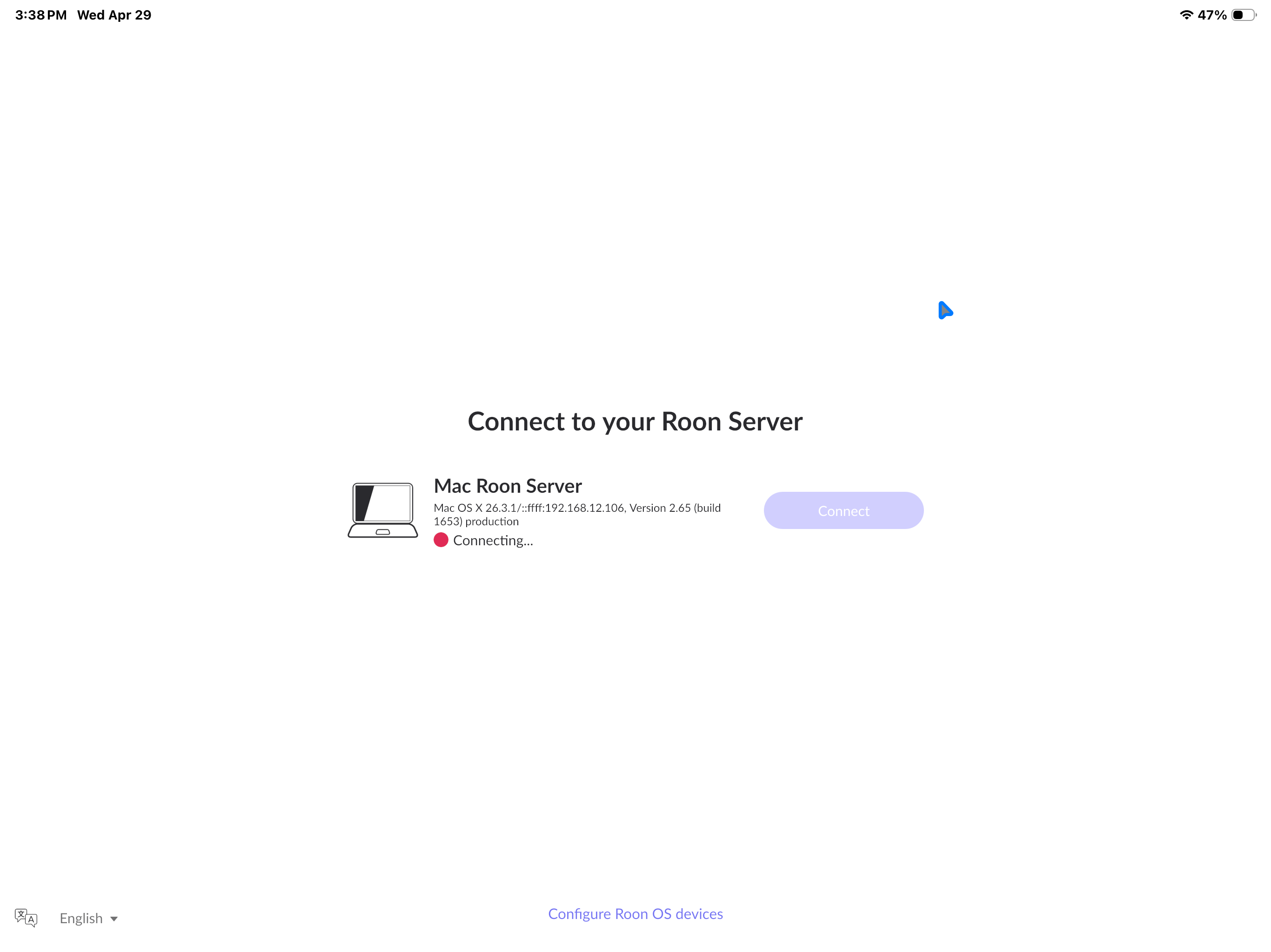

· I migrated to a new server, new computer is a M2 MacBook. Everything works fine on the MacBook playing music via my usb to dac but I can’t connect to server using ipad or iphone.

• Remotes: iPad and iPhone (stuck on “Searching”).

2. The iPad occasionally shows a picture of the MacBook but hangs on “Searching.”

• IP Bypass: Attempted to manually “Configure IP” on the iPad using the MacBook’s local IP address.

This sounds like the MacBook is serving music locally, but the Roon Remote side is not completing discovery on your network.
One thing stands out right away: T-Mobile home internet mesh setups can be tricky with device discovery, especially when the Roon Server is running on macOS and the remotes are on Wi-Fi. To narrow this down, I’d like to check two things:
  • Is the MacBook connected to the mesh by Wi-Fi or by Ethernet?
  • Do the iPad and iPhone sit on the same mesh node and same band as the MacBook, or can they roam between nodes?
In the meantime, please try this on the MacBook running Roon Server: quit Roon and RoonServer, then reopen RoonServer first and wait a minute before opening the iPad or iPhone app again. If it still hangs on searching, the next most useful test is to connect the MacBook directly to the T-Mobile gateway, bypassing the mesh if possible, just to see whether discovery starts working.
If you can also share the exact model of the T-Mobile gateway and mesh gear, that will help us tell whether this is a network isolation issue or something specific to the MacBook permissions side.
With that, could you bring your Server back online? We’ll enable diagnostic mode for your Roon Server to take a closer look. Thank you! :folded_hands:
