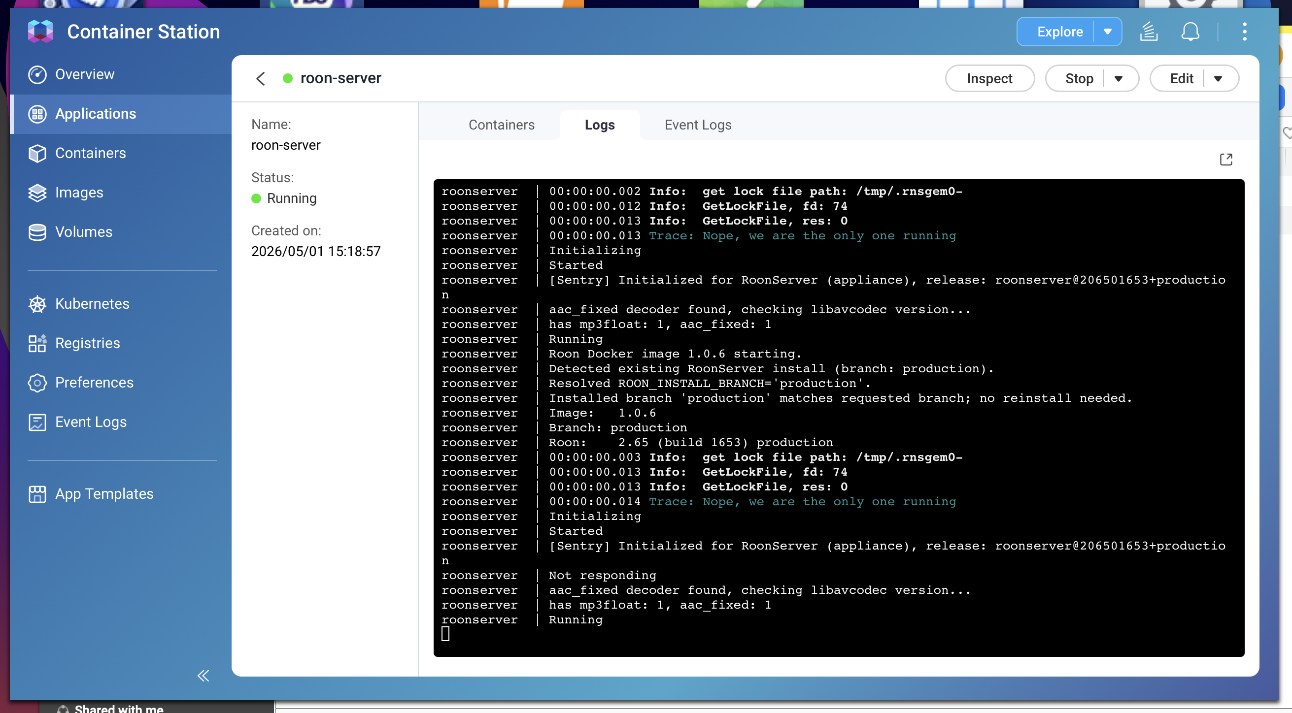

Can't connect to Roon Server after upgrading to host via containers on QNAP NAS
Was surprised to find Roon not working after returning from a trip and found that the server on my QNAP NAS wasn’t running. Some Googling quickly identified that the native Roon app was no more and that I needed to move it to a Container. Amazed that the first I heard about this was after my system had stopped working.
So I followed the instructions to move the Server to a Container and now have Roon Server 2.65 (build 1653) running on my TS-251+ through Container Station. I found the instructions really easy to follow and the web page to generate the yaml was great.
When I try to connect any of my Roon clients, they see the Roon Server instance (which is on the same network), but then never successfully connect. All I get is the Roon animated icon, suggesting something is stuck.
I haven’t yet got to the point of restoring the old database yet and thinking that the upgraded server might have been busy re-indexing my music library left it running overnight. However, behavioural today is unchanged and I am still unable to connect.
Server logs aren’t very informative. Welcome any ideas on what to try next?
NAS connected via LAN to MESH WiFi network. Nothing has changed other than the recent upgrade of Roon Server
This ticket can be closed. After restarting the container running the ServerI was able to chose to deactivate the existing instance (which I now assume must have been the replaced native version) and log in successfully. It would be useful to note that this step is required in the otherwise useful instructions on migrating to Container Station.

Your feedback about the deauthorization step is spot on. Because the Docker container generates a new Machine ID, the Roon system treats it as a completely new Core, which requires releasing the license from the legacy installation. I will pass your suggestion directly to our documentation team to ensure this step is explicitly added to the migration guide.

Vadim, thanks for the reply. In response to your questions, I have removed the native installation and configured the new installation with a new set of database folders, restoring the most recent backup once I got the system working again.
