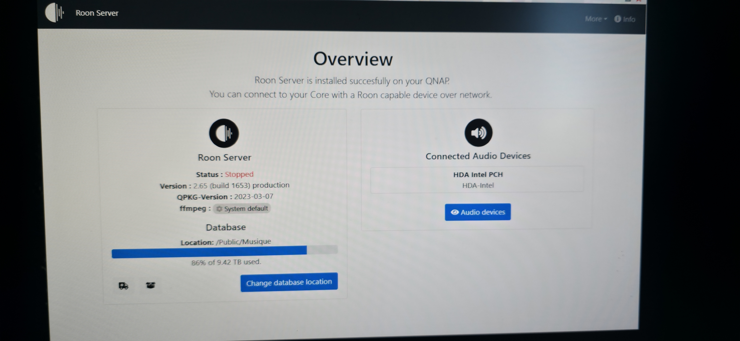

For the past two weeks, i have been unable to connect to Roon serveur on my Nas Qnap TS453D. The status is "Stopped" in the application. I uninstaled and reinstalled the application but it didn't work. My annual subscription ends in mid-july. What should i do ? Thank you for your reply. Sincerely, Michel
Roon server is installed on a Qnap TS 453D, all on a wired network

The Roon Server package no longer works, please switch to the official Docker image to run Roon Server on your NAS. See also:
Hello @Michel_Cayatte
It looks like you’ve been hit by the recent compatibility shift on QNAP. BlackJack is spot on here—the native QPKG app is no longer supported due to outdated system libraries on the NAS.
Please follow the link he provided to set up the official Docker image via Container Station. This is the definitive path forward for QNAP users to get back online with the latest version of Roon.
