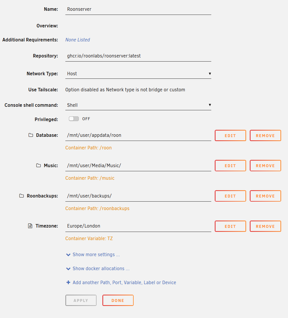

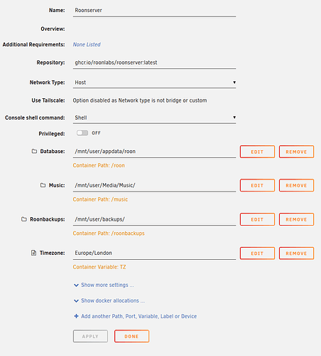

To troubleshoot the connection hang on your Unraid Docker deployment, perform the following steps:
  1. Verify that the Docker container’s Network Type is set specifically to Host in the Unraid template. Bridge or custom networks will block required multicast and TCP traffic between the Remote and the Server.
  2. Restart the Roon Server container in Unraid 2-3 times to ensure all background network services initialize correctly.
  3. In your Roon Remote app, click the Select a different Roon Server button, select the server instance, and log in. If this is a new container deployment with a new Machine ID, you must confirm the prompt to unauthorize the previous installation to release the license.
Provide a screenshot of your Unraid Docker template settings for the Roon container if the issue persists.

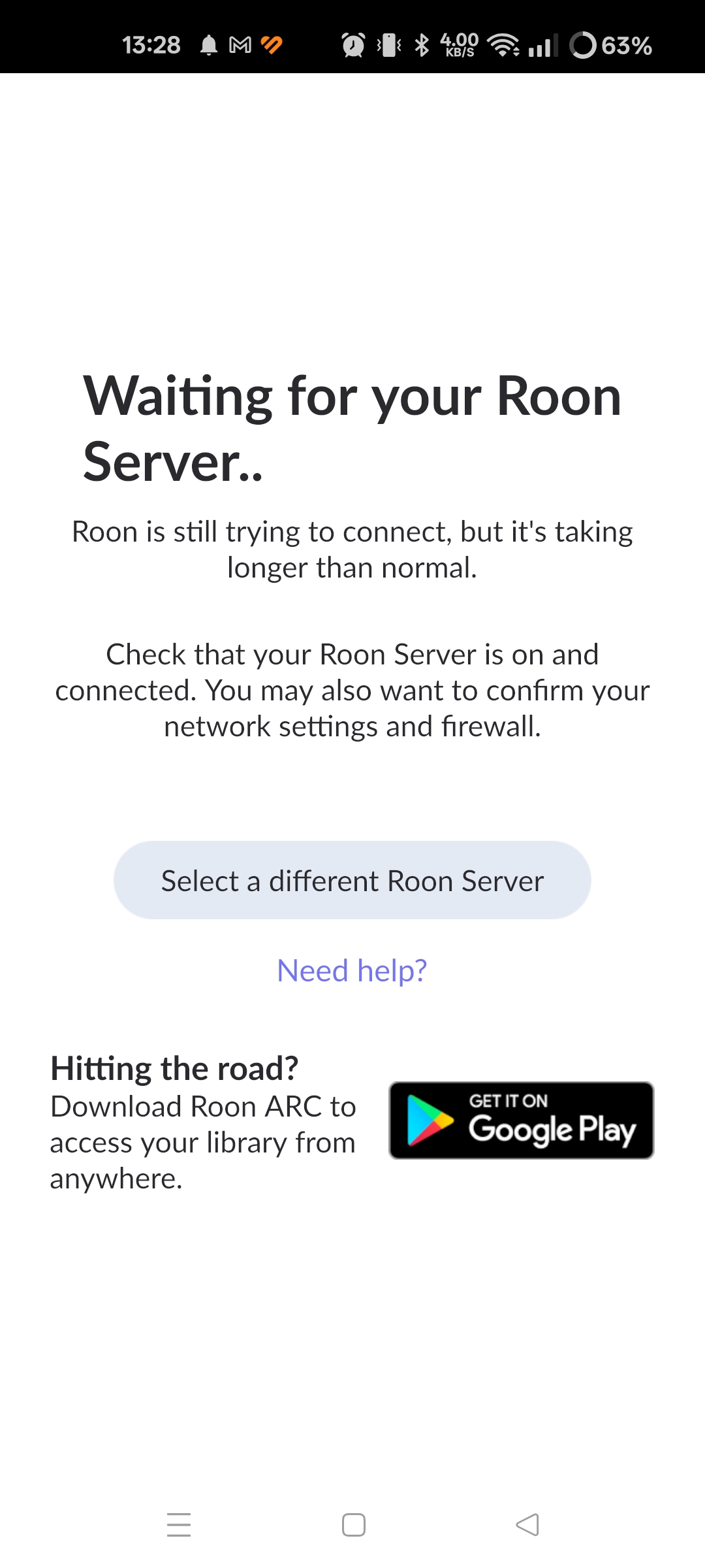

Thanks for the reply. This is my first roon installation. The server was working very well initially and I could connect via windows and android devices. Today however, I can’t access anything and all remote apps are stuck on the roon logo screen. I can’t select an alternate server as you suggest.
Update: I was able to select “choose a different server” and start the process on a windows PC, unauthorized the original server, retried login and unauthorized the windows PC. Now the original server has connected. If you could explain why this has happened and how to avoid in the future it would be much appreciated.
