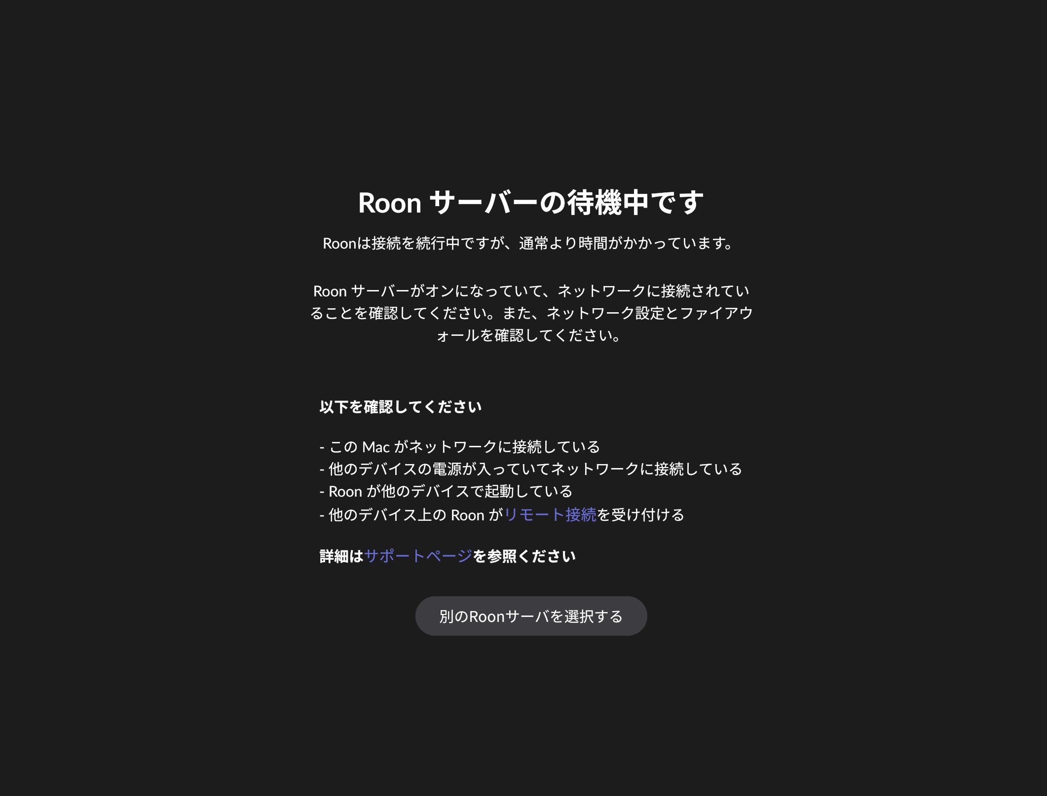

I can not connect to my Roon server
MBP LAN
Hi @raitautsumi,
Here are a few initial troubleshooting steps to try:
  1. update your Roon Server to the latest version 1480
  2. check your mac firewall and ensure Roon and Roon Server are listed as proper exceptions (or temporarily disable it to test for connection) - https://help.roonlabs.com/portal/en/kb/articles/firewall
  3. If you have the option to ‘select a different Roon Server’ click this and see if your Mac is available
  4. Reboot both your Roon Server machine and your router
If none of the above help, try refreshing your Roon Server database:
Let’s try a fresh database and see if your issues persist:
  • Exit out of Roon + RoonServer (from taskbar area)
  • Find the folder that says “Roon Server” and “Roon”
  • Rename the “RoonServer” folder to “RoonServer_old” and “Roon” to “Roon_old”
  • Verify if the issue persists on a fresh database before restoring the backup
Here is the process outlined from a macOS machine:
roonoldmac
We’ll be on standby for your reply :+1:
