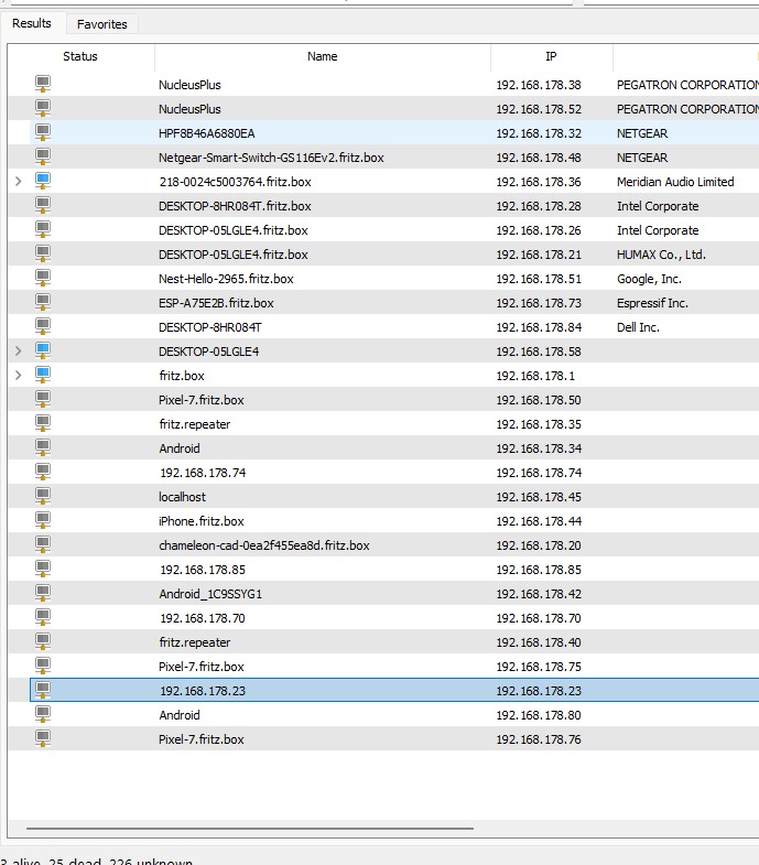

Hello Vadim,
Thank you for a most useful reply. I have tested the Nucleus plus connected directly to the main house router. I have taken photos of the Nucleus on test as you requested connected by HDMI cable to the main and only router. Here is a link showing general arrangements of the test setup as well as an IP scan of our home network and a shot of the network page of our router.=> https://photos.app.goo.gl/u2Ki15JC71mz64DAA
There seems to be something very wrong. The Nucleus output, both HDMI A & B, is connected to a screen by an HDMI cable as you can see. You can also see (Light on) that the Nucleus was powered on with its normal 19V DC power supply. The screen connected shows no signal is being received. This is most strange as I sent the Nucleus to the company from which I bought it for test. The company is Audio Images in Sheffield UK. The owner, Rick, tells me that it worked fine, so I am really mystified. During test, the Nucleus was connected to the main router alone, with an HDMI cable. I have verified that I was logged on to Roon Labs.
In response to your various points:
  1. I do not and never have used Wi-Fi for signal delivery to the Nucleus. As I write the Nucleus is now re-connected directly to the router using a well screened Cat 6A 4pr F/FTP cable. Wi-fi does not work in this building because of the thickness of the old stone walls. The reason for Wi-Fi is to connect my phone to the network for controlling Roon (I used to use an iPad), connecting to Google door bells and finally connecting via ethernet and possibly to a Google TV streamer. The connection from the Nucleus to the stereo amplifier is via a Meridian 218 zone controller over ethernet.
2. The faulty network extender (we have three in total) has been replaced because we need such devices as described above. I could make sure it is not on the same ethernet extension as any Wi-Fi device or remove it altogether.
3. I note what you say about Wi-Fi devices. Are you saying that I must remove them altogether, if only for test purposes? They are already on separate ethernet extensions. It would be helpful to know under what conditions Wi-Fi is permissible. Importantly, it is a fact that people all over the world make frequent use of Wi-Fi devices of many different types and designs. If Roon equipment cannot live with this then you have a problem!!! Perhaps you can propose an alternative. My near term intention is to change this network to optical fibre and this may deliver an improvement.
4. I have scanned my network and can see an allegedly dead Nucleus Plus. You should be able to see this on the router network scan I also have uploaded.
5. You asked for old IP Nucleus locations. You will find a further scan uploaded showing our network in the above folder. I shall be visiting these and all other Nucleus locations I am able to recollect and will advise the outcome. Our router does record such locations, but how exhaustively I don’t know.
Very Best wishes and thanks again,
Geoff Owens

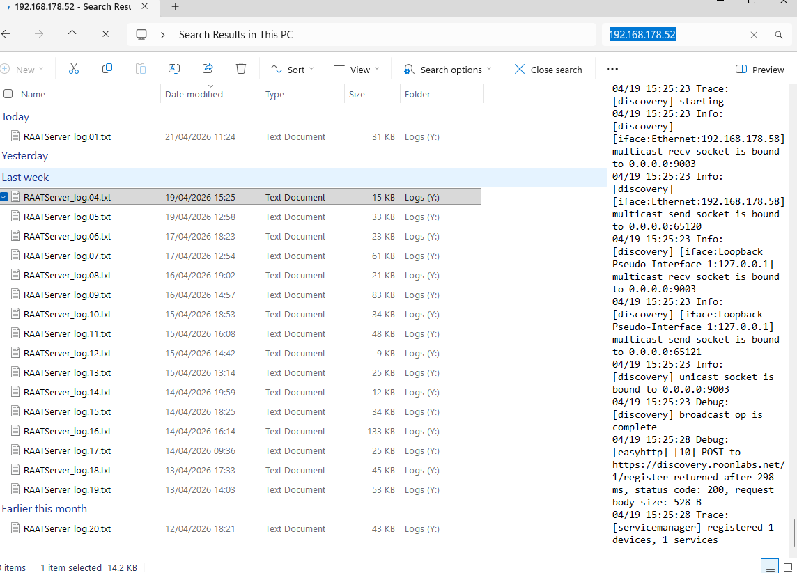

Hello Vadim,
I have just searched my PC using the string 192.168.178.52. This is where my advanced IP scanner thinks my Nucleus lives. I scrolled the right hand window to the bbottom so you could see the latest status. This is what I got:
Hello Vadim,
I believe I have found the IP address of my Nucleus which is 192.168.178.52 by scanning my PC. I checked this by connecting to the 192.168.178.52 IP address with file explorer in Windows. If you look at the previous screen shot I sent it is in the top right hand corner.
The Nucleus is still connected directly to our router where I plan to leave it. What is the next step?

04/23 18:19:43 Trace: \[servicemanager\] registered 1 devices, 1 services
04/23 18:20:41 Trace: \[RAATServer\] network reachability changed, refreshing discovery
04/23 18:20:41 Trace: \[raatmanager\] updating network interfaces
04/23 18:20:41 Trace: \[discovery\] stopping
04/23 18:20:41 Trace: closing multicast
04/23 18:20:41 Trace: \[discovery\] closing unicast send socket
04/23 18:20:41 Trace: \[discovery\] closing unicast recv socket
04/23 18:20:41 Trace: \[discovery\] starting
04/23 18:20:41 Info: \[discovery\] \[iface:Ethernet:192.168.178.58\] multicast recv socket is bound to 0.0.0.0:9003
04/23 18:20:41 Info: \[discovery\] \[iface:Ethernet:192.168.178.58\] multicast send socket is bound to 0.0.0.0:62499
04/23 18:20:41 Info: \[discovery\] \[iface:Loopback Pseudo-Interface 1:127.0.0.1\] multicast recv socket is bound to 0.0.0.0:9003
04/23 18:20:41 Info: \[discovery\] \[iface:Loopback Pseudo-Interface 1:127.0.0.1\] multicast send socket is bound to 0.0.0.0:62500
04/23 18:20:41 Info: \[discovery\] unicast socket is bound to 0.0.0.0:9003
04/23 18:20:41 Debug: \[discovery\] broadcast op is complete
04/23 18:20:46 Debug: \[easyhttp\] \[5\] POST to https://discovery.roonlabs.net/1/register returned after 306 ms, status code: 200, request body size: 528 B
04/23 18:20:46 Trace: \[servicemanager\] registered 1 devices, 1 services
04/23 18:21:47 Trace: \[RAATServer\] network reachability changed, refreshing discovery
04/23 18:21:47 Trace: \[raatmanager\] updating network interfaces
04/23 18:21:47 Trace: \[discovery\] stopping
04/23 18:21:47 Trace: closing multicast
04/23 18:21:47 Trace: \[discovery\] closing unicast send socket
04/23 18:21:47 Trace: \[discovery\] closing unicast recv socket
04/23 18:21:47 Trace: \[discovery\] starting
04/23 18:21:47 Info: \[discovery\] \[iface:Ethernet:192.168.178.58\] multicast recv socket is bound to 0.0.0.0:9003
04/23 18:21:47 Info: \[discovery\] \[iface:Ethernet:192.168.178.58\] multicast send socket is bound to 0.0.0.0:50715
04/23 18:21:47 Info: \[discovery\] \[iface:Loopback Pseudo-Interface 1:127.0.0.1\] multicast recv socket is bound to 0.0.0.0:9003
04/23 18:21:47 Info: \[discovery\] \[iface:Loopback Pseudo-Interface 1:127.0.0.1\] multicast send socket is bound to 0.0.0.0:50716
04/23 18:21:47 Info: \[discovery\] unicast socket is bound to 0.0.0.0:9003
04/23 18:21:48 Debug: \[discovery\] broadcast op is complete
04/23 18:21:53 Debug: \[easyhttp\] \[6\] POST to https://discovery.roonlabs.net/1/register returned after 306 ms, status code: 200, request body size: 528 B
04/23 18:21:53 Trace: \[servicemanager\] registered 1 devices, 1 services
04/23 18:22:51 Trace: \[RAATServer\] network reachability changed, refreshing discovery
04/23 18:22:51 Trace: \[raatmanager\] updating network interfaces
04/23 18:22:51 Trace: \[discovery\] stopping
04/23 18:22:51 Trace: closing multicast
04/23 18:22:51 Trace: \[discovery\] closing unicast send socket
04/23 18:22:51 Trace: \[discovery\] closing unicast recv socket
04/23 18:22:51 Trace: \[discovery\] starting
04/23 18:22:51 Info: \[discovery\] \[iface:Ethernet:192.168.178.58\] multicast recv socket is bound to 0.0.0.0:9003
04/23 18:22:51 Info: \[discovery\] \[iface:Ethernet:192.168.178.58\] multicast send socket is bound to 0.0.0.0:64416
04/23 18:22:51 Info: \[discovery\] \[iface:Loopback Pseudo-Interface 1:127.0.0.1\] multicast recv socket is bound to 0.0.0.0:9003
04/23 18:22:51 Info: \[discovery\] \[iface:Loopback Pseudo-Interface 1:127.0.0.1\] multicast send socket is bound to 0.0.0.0:64417
04/23 18:22:51 Info: \[discovery\] unicast socket is bound to 0.0.0.0:9003
04/23 18:22:51 Debug: \[discovery\] broadcast op is complete
04/23 18:22:56 Debug: \[easyhttp\] \[7\] POST to https://discovery.roonlabs.net/1/register returned after 302 ms, status code: 200, request body size: 528 B
04/23 18:22:56 Trace: \[servicemanager\] registered 1 devices, 1 services
04/23 18:25:24 Trace: \[RAATServer\] network reachability changed, refreshing discovery
04/23 18:25:24 Trace: \[raatmanager\] updating network interfaces
04/23 18:25:24 Trace: \[discovery\] stopping
04/23 18:25:24 Trace: closing multicast
04/23 18:25:24 Trace: \[discovery\] closing unicast send socket
04/23 18:25:24 Trace: \[discovery\] closing unicast recv socket
04/23 18:25:24 Trace: \[discovery\] starting
04/23 18:25:24 Info: \[discovery\] \[iface:Ethernet:192.168.178.58\] multicast recv socket is bound to 0.0.0.0:9003
04/23 18:25:24 Info: \[discovery\] \[iface:Ethernet:192.168.178.58\] multicast send socket is bound to 0.0.0.0:63122
04/23 18:25:24 Info: \[discovery\] \[iface:Loopback Pseudo-Interface 1:127.0.0.1\] multicast recv socket is bound to 0.0.0.0:9003
04/23 18:25:24 Info: \[discovery\] \[iface:Loopback Pseudo-Interface 1:127.0.0.1\] multicast send socket is bound to 0.0.0.0:63123
04/23 18:25:24 Info: \[discovery\] unicast socket is bound to 0.0.0.0:9003
04/23 18:25:24 Debug: \[discovery\] broadcast op is complete
04/23 18:25:29 Debug: \[easyhttp\] \[8\] POST to https://discovery.roonlabs.net/1/register returned after 317 ms, status code: 200, request body size: 528 B
04/23 18:25:29 Trace: \[servicemanager\] registered 1 devices, 1 services
04/23 18:26:26 Trace: \[RAATServer\] network reachability changed, refreshing discovery
04/23 18:26:26 Trace: \[raatmanager\] updating network interfaces
04/23 18:26:26 Trace: \[discovery\] stopping
04/23 18:26:26 Trace: closing multicast
04/23 18:26:26 Trace: \[discovery\] closing unicast send socket
04/23 18:26:26 Trace: \[discovery\] closing unicast recv socket
04/23 18:26:26 Trace: \[discovery\] starting
04/23 18:26:26 Info: \[discovery\] \[iface:Ethernet:192.168.178.58\] multicast recv socket is bound to 0.0.0.0:9003
04/23 18:26:26 Info: \[discovery\] \[iface:Ethernet:192.168.178.58\] multicast send socket is bound to 0.0.0.0:59183
04/23 18:26:26 Info: \[discovery\] \[iface:Loopback Pseudo-Interface 1:127.0.0.1\] multicast recv socket is bound to 0.0.0.0:9003
04/23 18:26:26 Info: \[discovery\] \[iface:Loopback Pseudo-Interface 1:127.0.0.1\] multicast send socket is bound to 0.0.0.0:59184
04/23 18:26:26 Info: \[discovery\] unicast socket is bound to 0.0.0.0:9003
04/23 18:26:27 Debug: \[discovery\] broadcast op is complete
04/23 18:26:36 Debug: \[easyhttp\] \[9\] POST to https://discovery.roonlabs.net/1/register returned after 4506 ms, status code: 200, request body size: 528 B
04/23 18:26:36 Trace: \[servicemanager\] registered 1 devices, 1 services
04/23 18:32:08 Trace: \[RAATServer\] network reachability changed, refreshing discovery
04/23 18:32:08 Trace: \[raatmanager\] updating network interfaces
04/23 18:32:08 Trace: \[discovery\] stopping
04/23 18:32:08 Trace: closing multicast
04/23 18:32:08 Trace: \[discovery\] closing unicast send socket
04/23 18:32:08 Trace: \[discovery\] closing unicast recv socket
04/23 18:32:08 Trace: \[discovery\] starting
04/23 18:32:08 Info: \[discovery\] \[iface:Ethernet:192.168.178.58\] multicast recv socket is bound to 0.0.0.0:9003
04/23 18:32:08 Info: \[discovery\] \[iface:Ethernet:192.168.178.58\] multicast send socket is bound to 0.0.0.0:49959
04/23 18:32:08 Info: \[discovery\] \[iface:Loopback Pseudo-Interface 1:127.0.0.1\] multicast recv socket is bound to 0.0.0.0:9003
04/23 18:32:08 Info: \[discovery\] \[iface:Loopback Pseudo-Interface 1:127.0.0.1\] multicast send socket is bound to 0.0.0.0:49960
04/23 18:32:08 Info: \[discovery\] unicast socket is bound to 0.0.0.0:9003
04/23 18:32:08 Debug: \[discovery\] broadcast op is complete
04/23 18:32:13 Debug: \[easyhttp\] \[10\] POST to https://discovery.roonlabs.net/1/register returned after 323 ms, status code: 200, request body size: 528 B
04/23 18:32:13 Trace: \[servicemanager\] registered 1 devices, 1 services
04/23 18:33:11 Trace: \[RAATServer\] network reachability changed, refreshing discovery
04/23 18:33:11 Trace: \[raatmanager\] updating network interfaces
04/23 18:33:11 Trace: \[discovery\] stopping
04/23 18:33:11 Trace: closing multicast
04/23 18:33:11 Trace: \[discovery\] closing unicast send socket
04/23 18:33:11 Trace: \[discovery\] closing unicast recv socket
04/23 18:33:11 Trace: \[discovery\] starting
04/23 18:33:11 Info: \[discovery\] \[iface:Ethernet:192.168.178.58\] multicast recv socket is bound to 0.0.0.0:9003
04/23 18:33:11 Info: \[discovery\] \[iface:Ethernet:192.168.178.58\] multicast send socket is bound to 0.0.0.0:60771
04/23 18:33:11 Info: \[discovery\] \[iface:Loopback Pseudo-Interface 1:127.0.0.1\] multicast recv socket is bound to 0.0.0.0:9003
04/23 18:33:11 Info: \[discovery\] \[iface:Loopback Pseudo-Interface 1:127.0.0.1\] multicast send socket is bound to 0.0.0.0:60772
04/23 18:33:11 Info: \[discovery\] unicast socket is bound to 0.0.0.0:9003
04/23 18:33:11 Debug: \[discovery\] broadcast op is complete
04/23 18:33:16 Debug: \[easyhttp\] \[11\] POST to https://discovery.roonlabs.net/1/register returned after 303 ms, status code: 200, request body size: 528 B
04/23 18:33:16 Trace: \[servicemanager\] registered 1 devices, 1 services
04/23 18:37:25 Trace: \[RAATServer\] network reachability changed, refreshing discovery
04/23 18:37:25 Trace: \[raatmanager\] updating network interfaces
04/23 18:37:25 Trace: \[discovery\] stopping
04/23 18:37:25 Trace: closing multicast
04/23 18:37:25 Trace: \[discovery\] closing unicast send socket
04/23 18:37:25 Trace: \[discovery\] closing unicast recv socket
04/23 18:37:25 Trace: \[discovery\] starting
04/23 18:37:25 Info: \[discovery\] \[iface:Ethernet:192.168.178.58\] multicast recv socket is bound to 0.0.0.0:9003
04/23 18:37:25 Info: \[discovery\] \[iface:Ethernet:192.168.178.58\] multicast send socket is bound to 0.0.0.0:53864
04/23 18:37:25 Info: \[discovery\] \[iface:Loopback Pseudo-Interface 1:127.0.0.1\] multicast recv socket is bound to 0.0.0.0:9003
04/23 18:37:25 Info: \[discovery\] \[iface:Loopback Pseudo-Interface 1:127.0.0.1\] multicast send socket is bound to 0.0.0.0:53865
04/23 18:37:25 Info: \[discovery\] unicast socket is bound to 0.0.0.0:9003
04/23 18:37:25 Debug: \[discovery\] broadcast op is complete
04/23 18:37:30 Debug: \[easyhttp\] \[12\] POST to https://discovery.roonlabs.net/1/register returned after 316 ms, status code: 200, request body size: 528 B
04/23 18:37:30 Trace: \[servicemanager\] registered 1 devices, 1 services
04/23 18:38:30 Trace: \[RAATServer\] network reachability changed, refreshing discovery
04/23 18:38:30 Trace: \[raatmanager\] updating network interfaces
04/23 18:38:30 Trace: \[discovery\] stopping
04/23 18:38:30 Trace: closing multicast
04/23 18:38:30 Trace: \[discovery\] closing unicast send socket
04/23 18:38:30 Trace: \[discovery\] closing unicast recv socket
04/23 18:38:30 Trace: \[discovery\] starting
04/23 18:38:30 Info: \[discovery\] \[iface:Ethernet:192.168.178.58\] multicast recv socket is bound to 0.0.0.0:9003
04/23 18:38:30 Info: \[discovery\] \[iface:Ethernet:192.168.178.58\] multicast send socket is bound to 0.0.0.0:50883
04/23 18:38:30 Info: \[discovery\] \[iface:Loopback Pseudo-Interface 1:127.0.0.1\] multicast recv socket is bound to 0.0.0.0:9003
04/23 18:38:30 Info: \[discovery\] \[iface:Loopback Pseudo-Interface 1:127.0.0.1\] multicast send socket is bound to 0.0.0.0:50884
04/23 18:38:30 Info: \[discovery\] unicast socket is bound to 0.0.0.0:9003
04/23 18:38:31 Debug: \[discovery\] broadcast op is complete
04/23 18:38:36 Debug: \[easyhttp\] \[13\] POST to https://discovery.roonlabs.net/1/register returned after 305 ms, status code: 200, request body size: 528 B
04/23 18:38:36 Trace: \[servicemanager\] registered 1 devices, 1 services
04/23 18:40:21 Trace: \[jsonserver\] \[127.0.0.1:56128\] accepted connection
04/23 18:40:21 Trace: \[jsonserver\] \[127.0.0.1:56128\] GOT\[LL\] \[1\] {“request”:“enumerate_devices”,“subscription_id”:“0”}
04/23 18:40:21 Trace: \[jsonserver\] \[127.0.0.1:56128\] SENT \[1\] \[nonfinal\] {“status”: “Success”, “devices”: \[{“name”: “System Output”, “type”: “wasapi”, “device_id”: “default”, “is_system_output”: true, “config”: {“external_config”: {“product_override”: null}, “output”: {“name”:
04/23 18:40:36 Trace: \[jsonserver\] \[127.0.0.1:56128\] read: eof
04/23 18:40:36 Trace: \[jsonserver\] \[127.0.0.1:56128\] destroying client
04/23 18:44:29 Trace: \[RAATServer\] network reachability changed, refreshing discovery
04/23 18:44:29 Trace: \[raatmanager\] updating network interfaces
04/23 18:44:29 Trace: \[discovery\] stopping
04/23 18:44:29 Trace: closing multicast
04/23 18:44:29 Trace: \[discovery\] closing unicast send socket
04/23 18:44:29 Trace: \[discovery\] closing unicast recv socket
04/23 18:44:29 Trace: \[discovery\] starting
04/23 18:44:29 Info: \[discovery\] \[iface:Ethernet:192.168.178.58\] multicast recv socket is bound to 0.0.0.0:9003
04/23 18:44:29 Info: \[discovery\] \[iface:Ethernet:192.168.178.58\] multicast send socket is bound to 0.0.0.0:56416
04/23 18:44:29 Info: \[discovery\] \[iface:Loopback Pseudo-Interface 1:127.0.0.1\] multicast recv socket is bound to 0.0.0.0:9003
04/23 18:44:29 Info: \[discovery\] \[iface:Loopback Pseudo-Interface 1:127.0.0.1\] multicast send socket is bound to 0.0.0.0:56417
04/23 18:44:29 Info: \[discovery\] unicast socket is bound to 0.0.0.0:9003
04/23 18:44:29 Debug: \[discovery\] broadcast op is complete
04/23 18:44:35 Debug: \[easyhttp\] \[14\] POST to https://discovery.roonlabs.net/1/register returned after 301 ms, status code: 200, request body size: 528 B
04/23 18:44:35 Trace: \[servicemanager\] registered 1 devices, 1 services
04/23 18:45:32 Trace: \[RAATServer\] network reachability changed, refreshing discovery
04/23 18:45:32 Trace: \[raatmanager\] updating network interfaces
04/23 18:45:32 Trace: \[discovery\] stopping
04/23 18:45:32 Trace: closing multicast
04/23 18:45:32 Trace: \[discovery\] closing unicast send socket
04/23 18:45:32 Trace: \[discovery\] closing unicast recv socket
04/23 18:45:32 Trace: \[discovery\] starting
04/23 18:45:32 Info: \[discovery\] \[iface:Ethernet:192.168.178.58\] multicast recv socket is bound to 0.0.0.0:9003
04/23 18:45:32 Info: \[discovery\] \[iface:Ethernet:192.168.178.58\] multicast send socket is bound to 0.0.0.0:51229
04/23 18:45:32 Info: \[discovery\] \[iface:Loopback Pseudo-Interface 1:127.0.0.1\] multicast recv socket is bound to 0.0.0.0:9003
04/23 18:45:32 Info: \[discovery\] \[iface:Loopback Pseudo-Interface 1:127.0.0.1\] multicast send socket is bound to 0.0.0.0:51230
04/23 18:45:32 Info: \[discovery\] unicast socket is bound to 0.0.0.0:9003
04/23 18:45:32 Debug: \[discovery\] broadcast op is complete
04/23 18:45:37 Debug: \[easyhttp\] \[15\] POST to https://discovery.roonlabs.net/1/register returned after 297 ms, status code: 200, request body size: 528 B
04/23 18:45:37 Trace: \[servicemanager\] registered 1 devices, 1 services
Where do I go from here???
Regards,
Geoff
