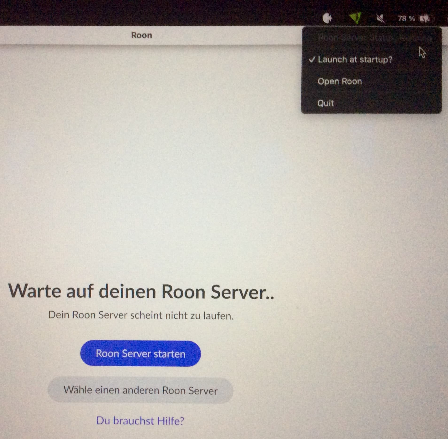

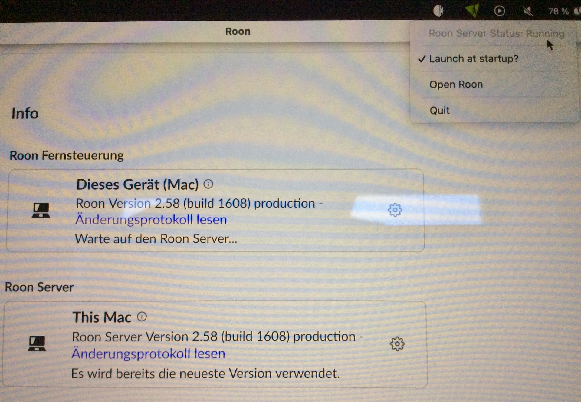

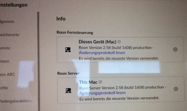

I will test the result and can well imagine that it has certainly been useful and your answer helpful, but I fear that there is another problem: When I first wanted to start a backup today, Roon told me in the “Settings - Info - Roon Remote Control” section, “Waiting for Roon Server” (instead of the expected message: The latest version is already in use, as is the case with the box directly below it (Roon Server This Mac), and at the same time the top line shows that the Roon Server status is “running.” The backup could NOT be started, and the next screen informed me that "Waiting for your Roon Server, does not appear to be running. Starting Roon Server did not work, but as already mentioned, the top line of the monitor shows the server status as “running.”
Hopefully you have an idea what I can do - so that the “waiting for the Roon server” comes to an end.

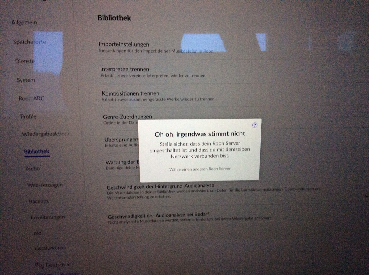

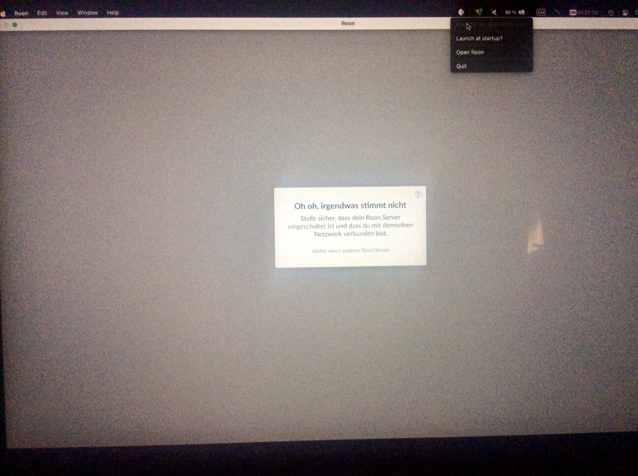

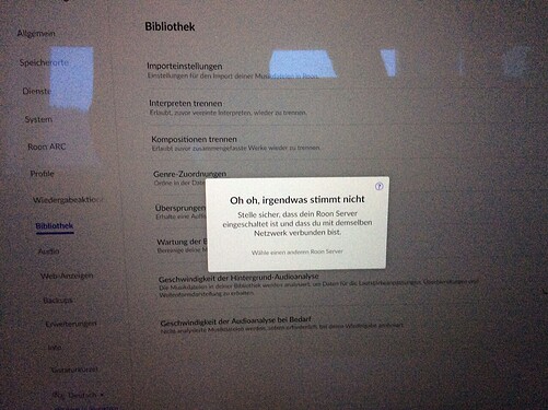

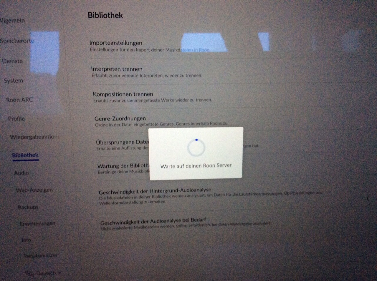

Hello dear support team,
Freeing up disk space was the perfect solution to the system crashes. Thank you very much for this tip!!!
However, “waiting for Roon Server” is omnipresent - and when the “waiting time has expired,” I get this screenshot I just took with the message “Oh oh, something’s wrong…” - and I’m supposed to choose another server that I have on one machine and not on a second one. I am sending the two screenshots with this message.
When I log in with my Roon account, I get the message “The latest version is already in use” for a short time, as expected and desired. But shortly after that, the display changes to “Waiting for Roon Server,” and it stays that way.

Have you tried the option of chosing another server? If anything is listed, it is the same server. It is possible that your network has assigned it a new address.

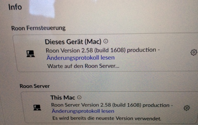

Hello mjw, hello to all helpful supporters,

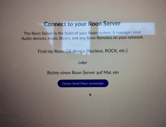

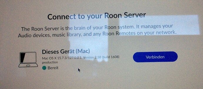

A few minutes ago, I did the following: under General → ROON SERVER - This device (Mac) - I selected Disconnect in the top right corner.
New screen: Connect to your Roon Server, a device is displayed here and it is described with a green dot and the text “Ready.” I took a photo of the result and then selected “Connect.”
This worked for about a minute, and the info said “This device (Mac) is already using the latest version.” About a minute later, this display changed back to “Waiting for Roon Server.” Please see the photo in the attachment.
According to the display in the top line, the Roon Server status is supposedly “Running.”
I don’t have any other server besides this MacPro.
I disabled the firewall in System Preferences → Network.
I also noticed that “Waiting for Roon Server” also appears as a pop-up when it says that the latest version is being used. This does not seem to be related to the constant search for Roon Server.
“It is possible that your network has assigned it a new address.” Where can I find out and see this?
Jens.

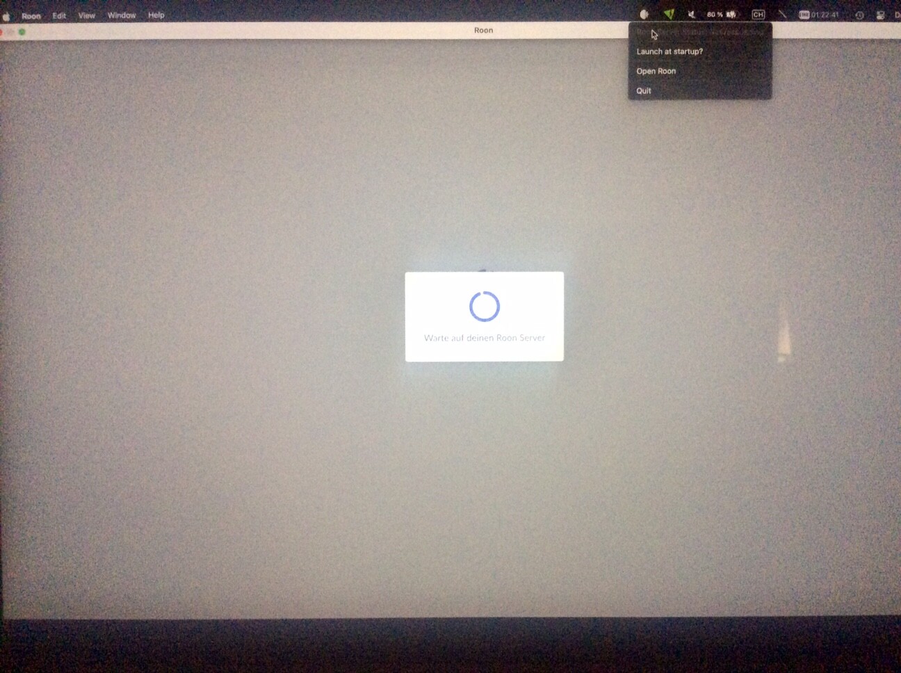

Hello everyone,
It’s frustrating.
After importing a larger hard drive into the Roon system last night, Roon couldn’t find its Roon server today, and I’ve restarted the system several times because I can’t even get to the Roon start screen. I’m slowly starting to despair. The monitor remains pretty much “white” except for the Roon icon. See photo.
And that’s without me having connected an HD at all, which might speed up the program startup. Is it possible that Roon takes hours to start up?
I don’t want to lose the data from the albums I’ve imported so far, but since I couldn’t finish, I don’t have a backup yet.
What could be causing Roon to behave this way?
Best regards to everyone reading this.
Addendum: in the top line, the Roon Server shows the status alternating between Not responding and Running. But I also briefly saw Error there.
All this while the little Roon icon remains stable on the white monitor.
Addendum 2: “Started” is of course also available in the Roon Server status. But even when it is “Running,” the device displays “Waiting for your Roon Server,” and the blue line runs counterclockwise. I just noticed that the status is also displayed as “Not responding” in the top line. This changes quickly and often.
What can be done about this, because listening to some music would be the goal at the end of the installation.
