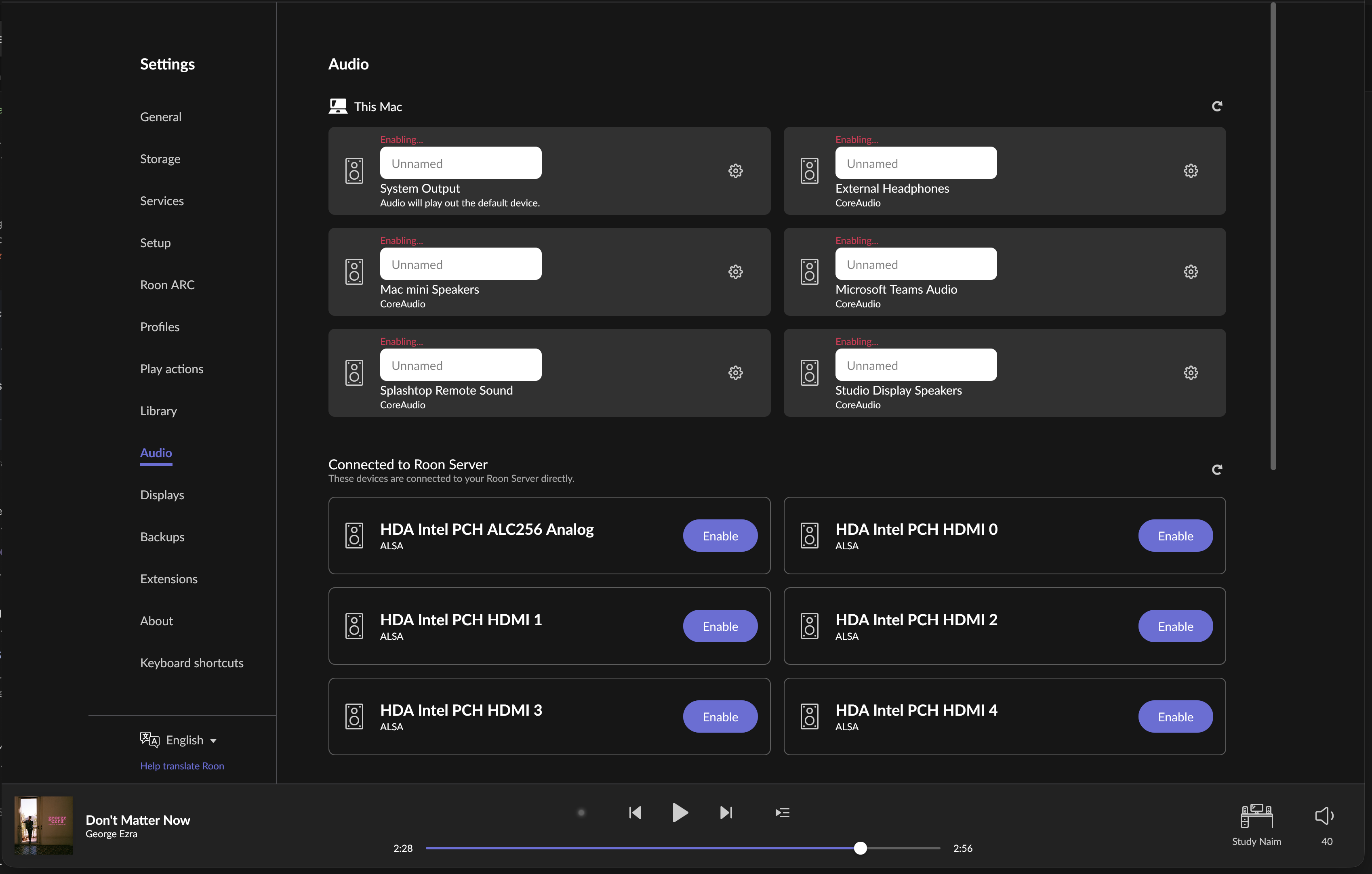

· I am unable to enable Audio Devices attached to my Mac. Anything on the network, including Squeezebox emulating devices and the Mac itself via Airplay2 are working fine. I am on 2.60 (Build 1629) of the Mac App and 2.59 (Build 1625) of the Server Optimised Core Kit. Mac OS is on Tahoe 26.3. I have seen error MacOS error: -25294 in the system log on multiple occasions, I believe this is a security exception.

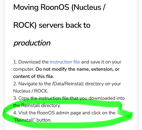

Thanks for this but the published instructions for downgrade do not work. I have copied the instruction file to the data/reinstall directory but the ROCK System status page does not have a reinstall option for the Roon Server Software and it remains at build 1625.
As I was unable to downgrade ROCK I have installed the Early Access client on my Mac, taking it to Version 2.59 Build 1625 early access and this resolves the issue. I can now enable and use my Mac attached devices.

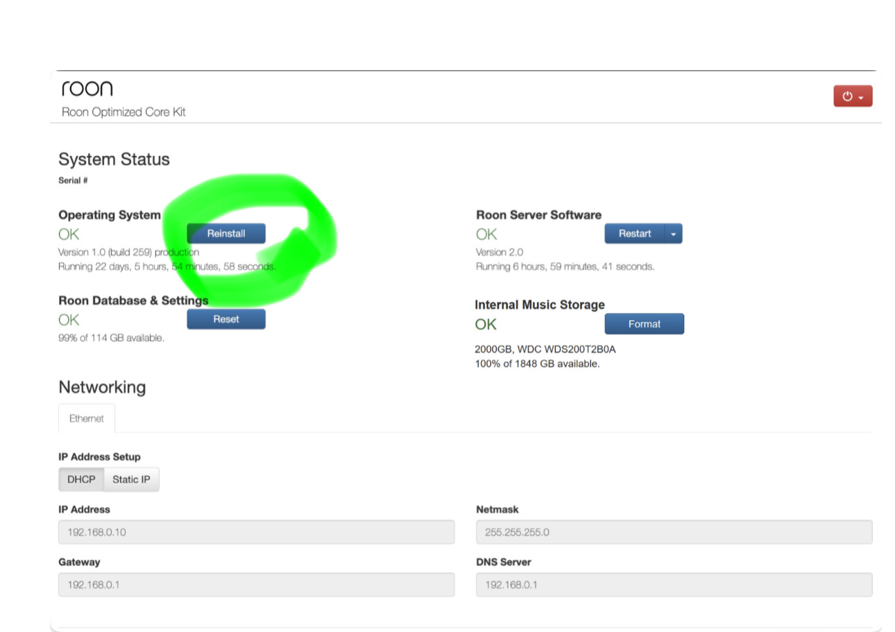

The instructions don’t say „reinstall option for the Roon Server Software, they say the Reinstall button:
And this should be here - it reinstalls ROCK completely, OS and server:
