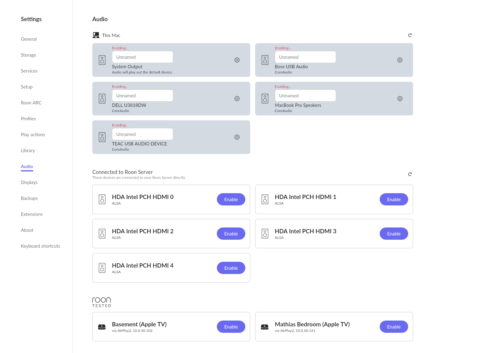

Unable to enable local audio devices (ref#6XFJT7)
Please try rebooting your router.
· No, I'm still having trouble
· This is on a fresh install of macOS 26.5.1 and fresh download of Roon.
· System Output, BOSE USB, MacBook Pro Speakers, DELL U3818 Monitor, TEAC USB DAC... none of them can be enabled
I'm unable to enable any local audio devices
Network connectivity works great. That's not the issue. It's something with core audio, I believe

Hello @Michael_Braun,
Just checking in on this. Have you had a chance to review the macOS Local Network permissions for both Roon and Roon Server, toggle them off and back on, then fully quit Roon Server and reboot the Mac? If you tried those steps already, let us know whether the audio devices came back after the restart, thanks.
