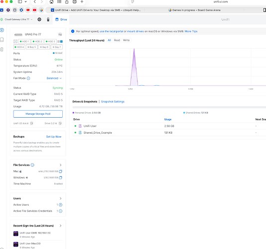

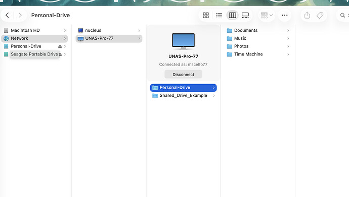

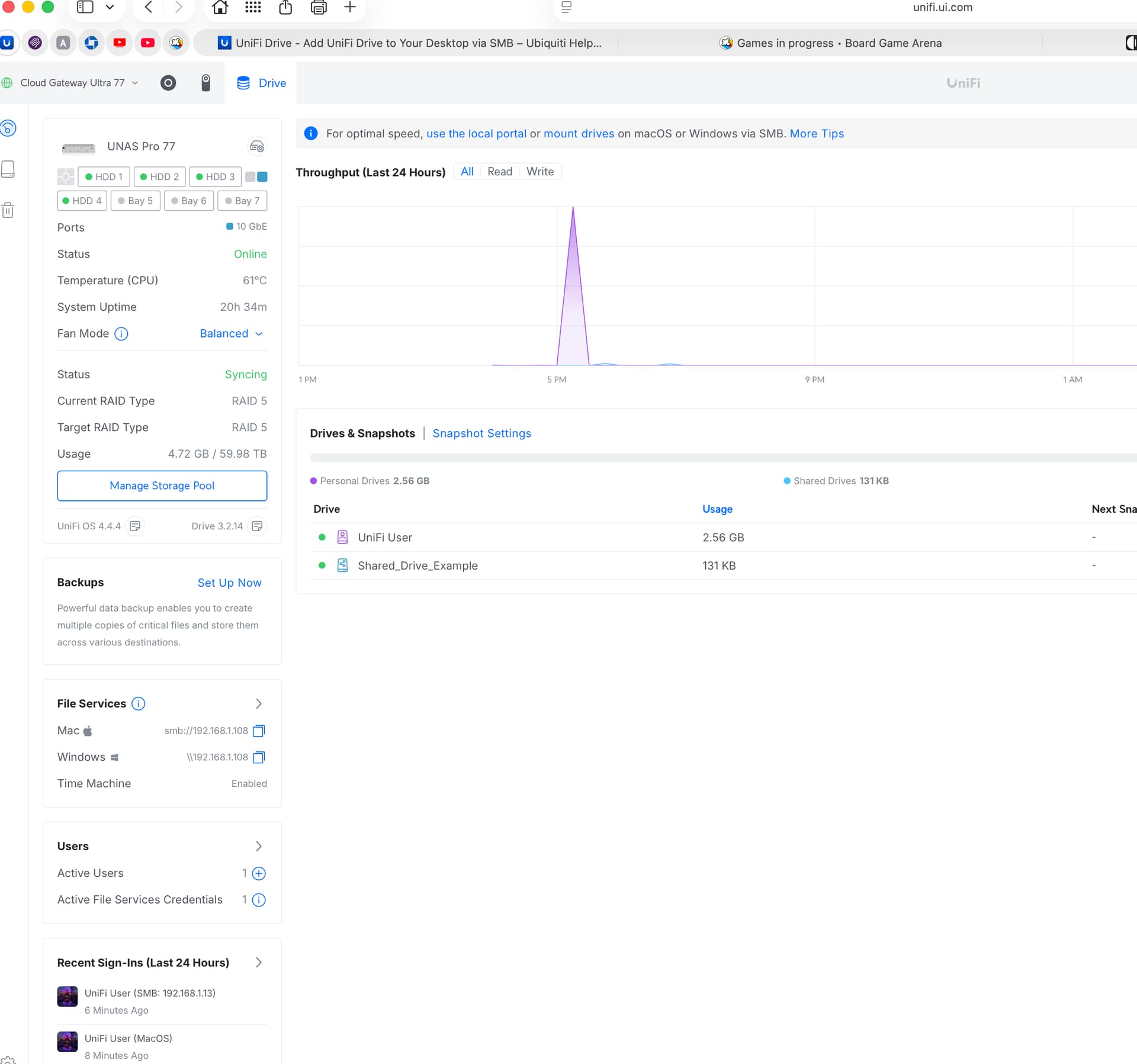

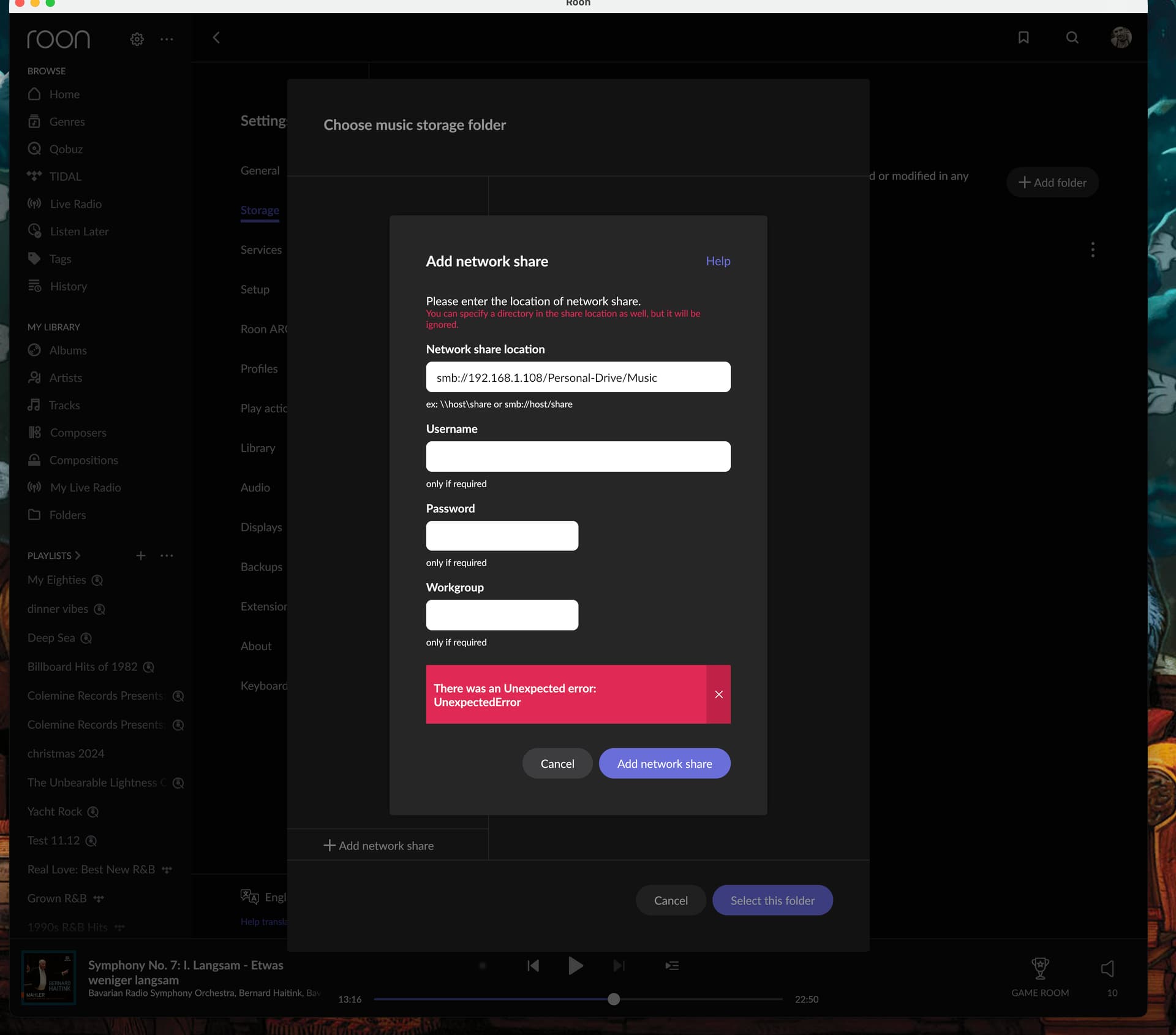

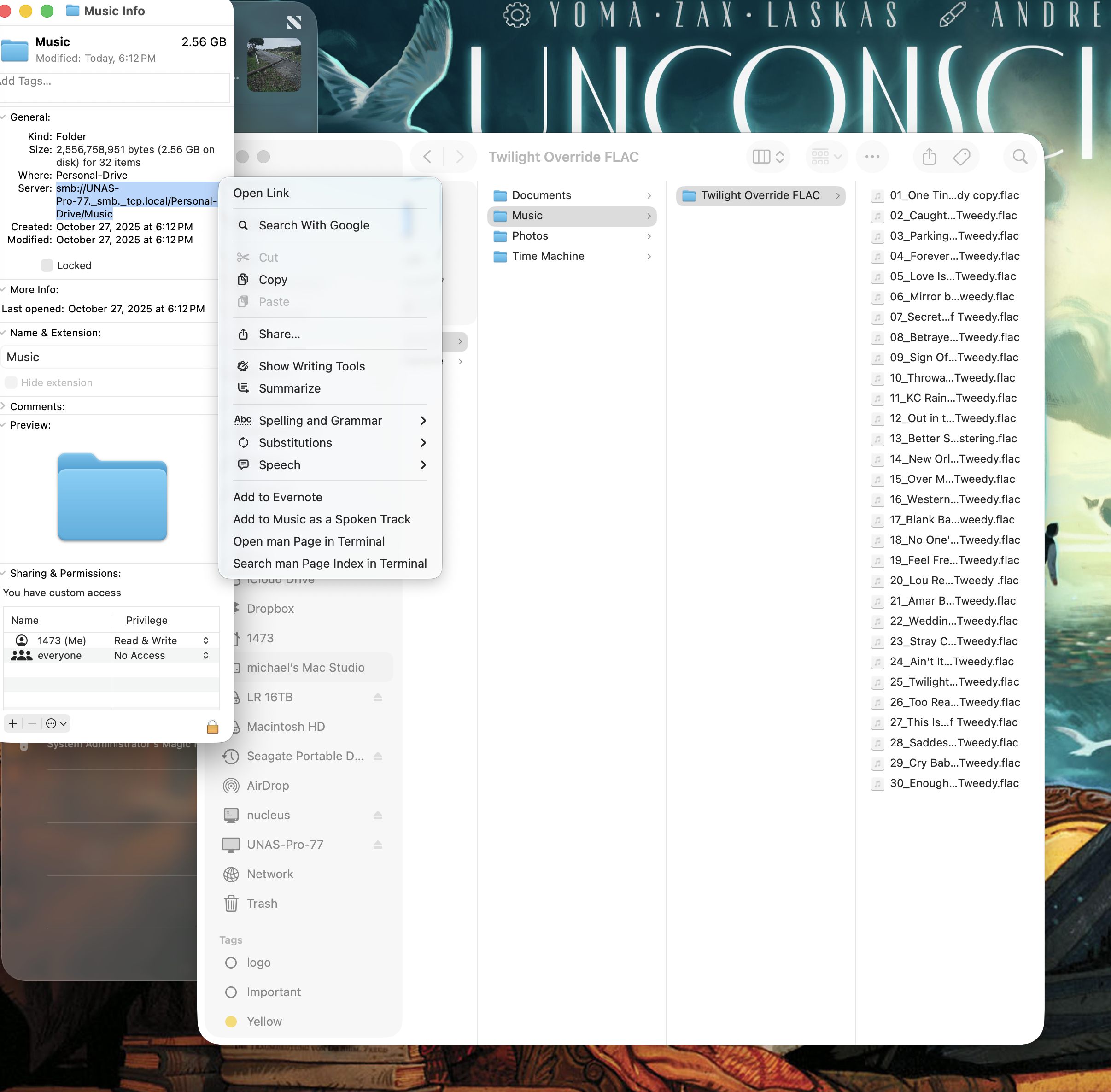

trying to establish network share on new NAS, getting host not found error. I used the path in the "get info " area of new music folder. also tried entering my nas credentials and both ways same error: host not found
unfi system, using UNAS PRO with Roon Nucleus on same network
Good day @Michael_P_Scelfo !
In our logs we were able to see the following:
10/27 22:19:47 [Local 10/27 18:19:47] Error: [broker/filsystem/drivelistshares/addsharedrive] error adding share: System.Exception: [cifs/mountconfig] invalid cifs path (post windowsization, missing third backslash): smb://UNAS-Pro-77
It means that likely share path was not provided correctly.
Can you please try to add it again but instead of name of the share machine use its ip so it looks like this for you:
smb://192.168.1.xxx/Personal-Drive/Music

different issue/error

Hello @Michael_P_Scelfo,
From the diagnostic messages, it appears that the mount attempt is failing due to a login authentication error:
CIFS: Status code returned 0xc000006d STATUS_LOGON_FAILURE
This usually indicates either incorrect credentials, a permission mismatch, or SMB protocol incompatibility.

  1. Use the correct network path format
  • In Roon, the share path should look like this:
\\192.168.1.108\Personal-Drive
or, if using a hostname:
\\UNASPRO\Personal-Drive
Avoid copying paths directly from “Get Info,” as those sometimes contain macOS-specific formatting.

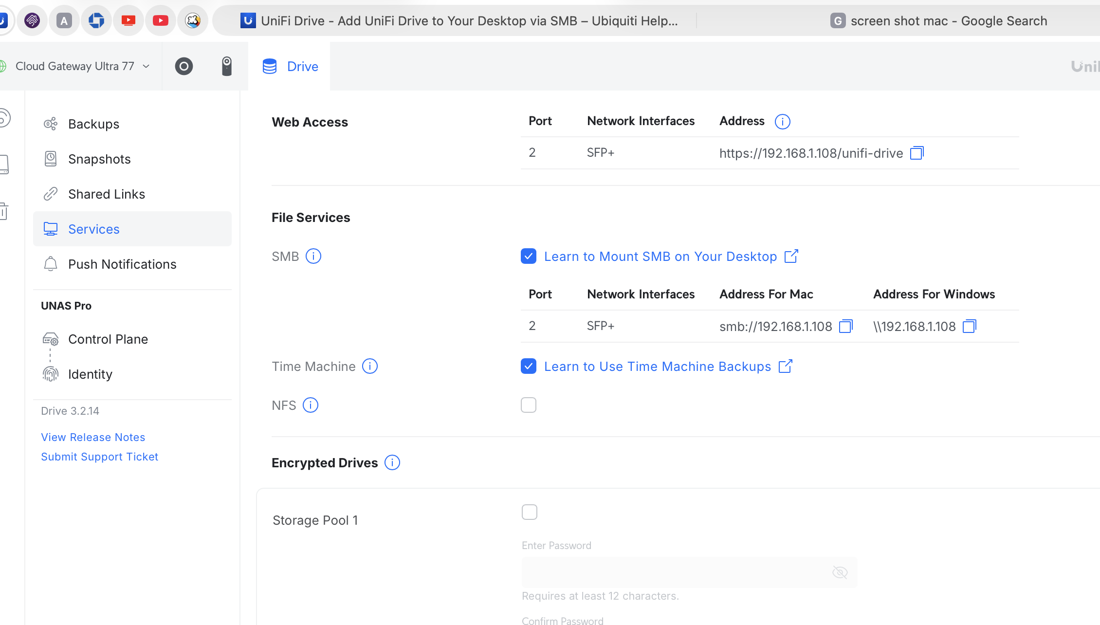

  1. Ensure SMB v2 or v3 is enabled on your NAS
  • The log line
Use of the less secure dialect vers=1.0 is not recommended
suggests the connection might be falling back to SMBv1, which is disabled in modern systems for security reasons.
  • Please enable SMB v2/v3 on your NAS and disable SMBv1 if possible.
