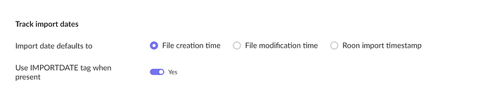

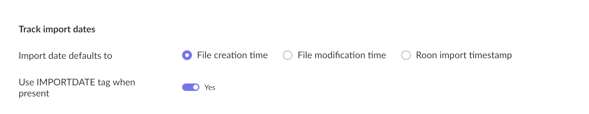

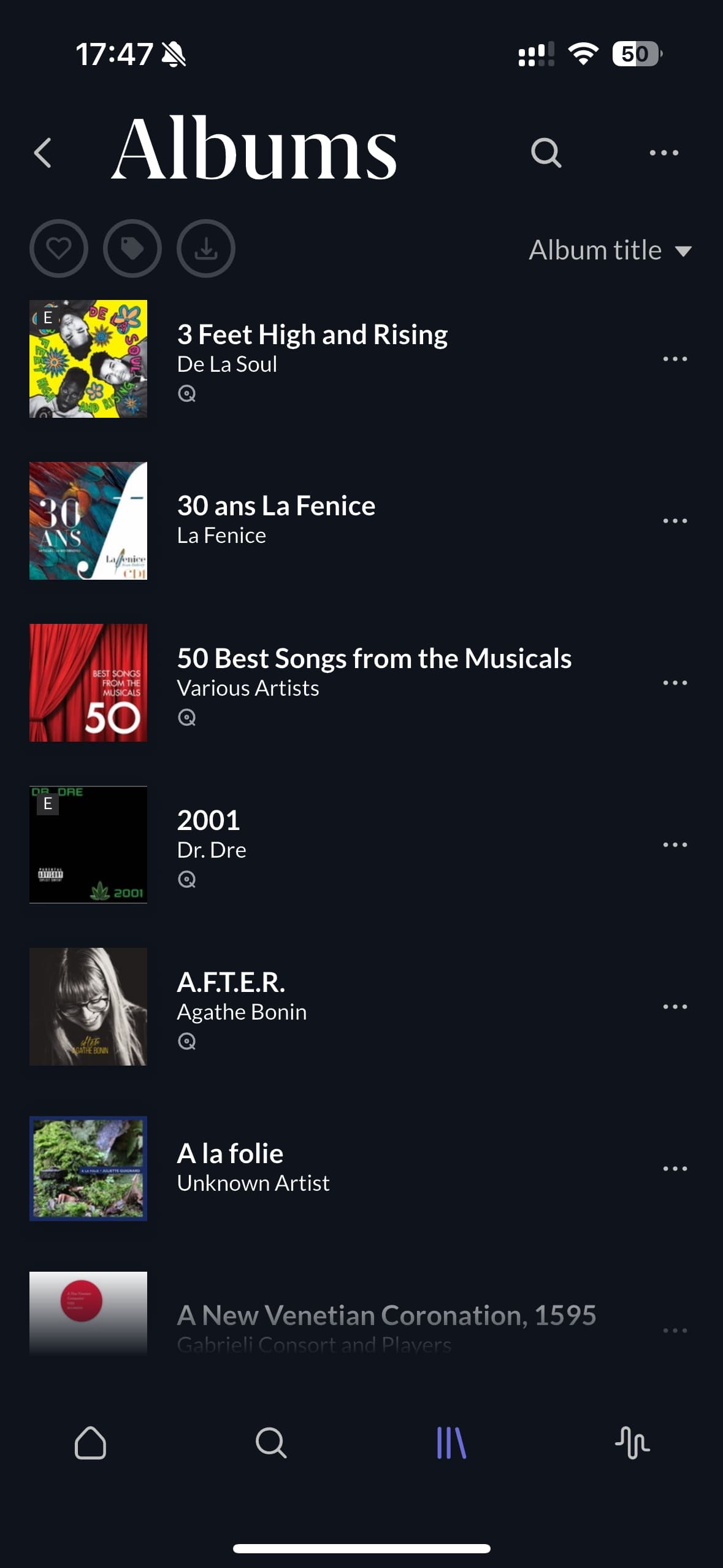

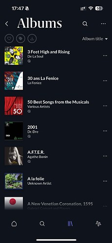

Hello, I’ve entirely removed Roon from the NAS and re-installed it creating a new database. I’ve also chosen to use the metadata contained in the file for all tags and including the “track import date” (see attached). I’ve then re-installed Roon ARC and i now don’t have any access to the filters tab ! Also the sorting by “date imported” is completely erroneous while the files all contain this tag (this works well on JRiver Media center which i used to create all the tags). This is really very disappointing

You’ve toggled your Roon Import settings to prefer the file creation time for Date Imported. Is this not what you’d prefer?

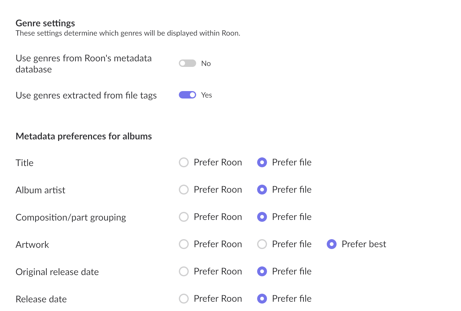

  4. set up the library database using the file’s data (as per picture above) rather than Roon’s data

By doing this, as explained above i ended up with no possibility to click on the the filters tab on Arc as shown above. And when i sorted out the albums on Roon based on import time it shows nonsense while the “import date” tag is present on the files and i’ve asked Roon to use the file’s data rather than it’s own.

    • In Roon settings under Library → Import Settings, ensure “Prefer Roon” is selected (so that only Roon’s own metadata is used upon re-import)
