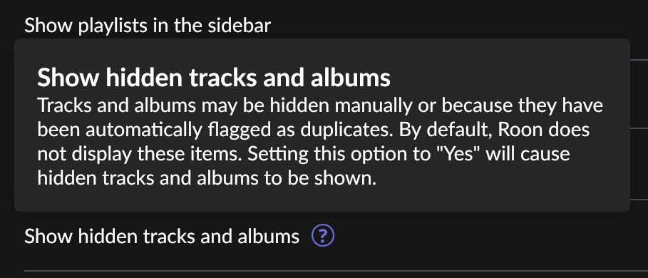

Not the most intuitive setting when you’re thinking “duplicates”, but I believe you’re looking for
Settings > General > Show hidden tracks and albums
Thanks for your reply @s73nm I think I’m looking to “hide” duplicates. My setting is “No” but I only want to see the 41,000 highest quality (like the set up from my previous set up) and now it is showing all 51,000 including duplicates.
