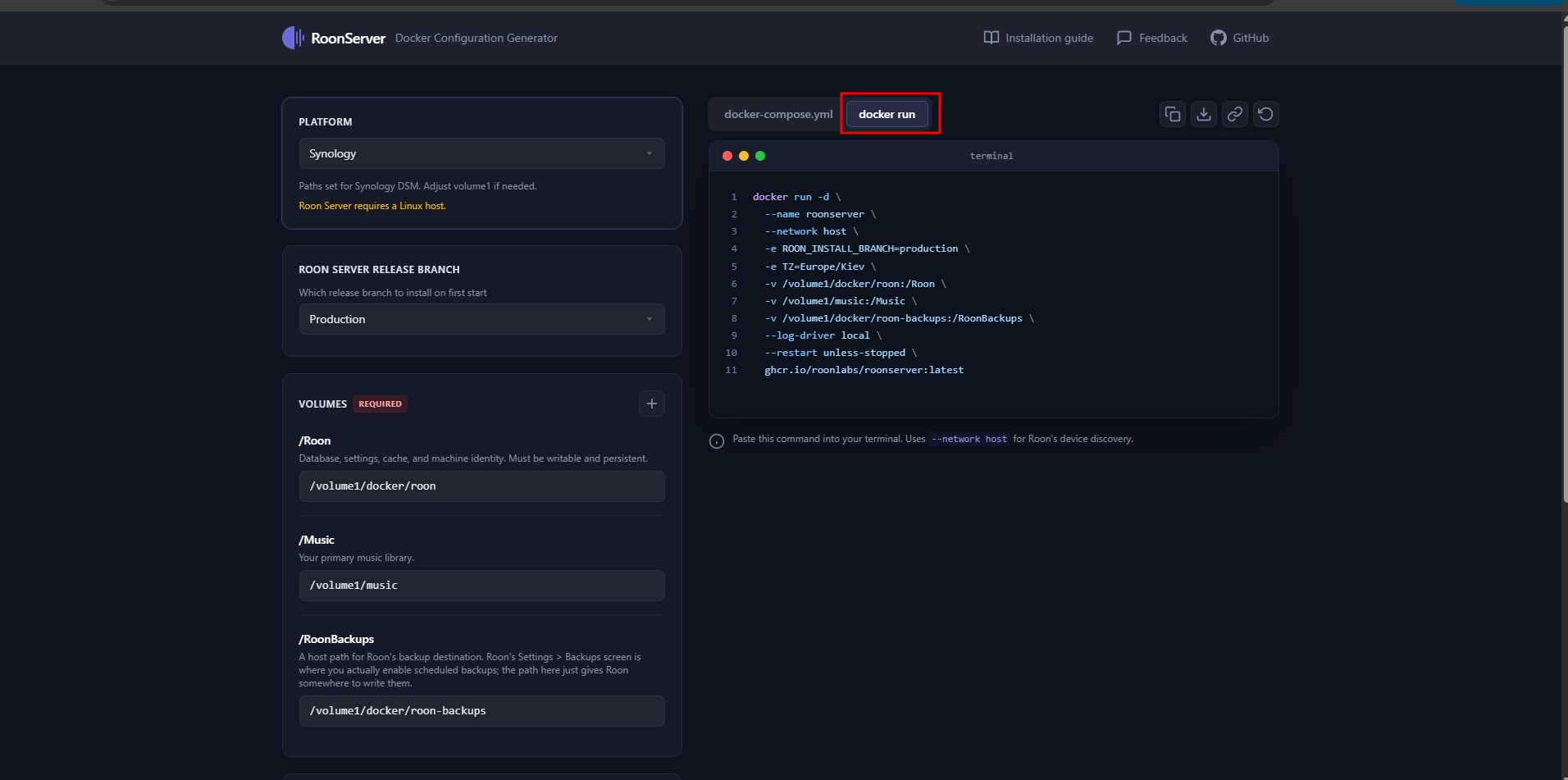

Option 1: The Quick docker run Command
This method uses a single text command to launch the server immediately.
  1. Go to our Roon Docker Configurator. Select Synology, choose your timezone, ensure your music path is mapped exactly to /volume1/music, and copy the text from the docker run tab at the bottom.
  2. Open Command Prompt (Windows) or Terminal (Mac).
  3. Type ssh your_synology_username@your_nas_ip and press Enter. (Replace with your actual admin username and NAS IP).
  4. Type your password when prompted and press Enter. (The cursor will not move while typing).
  5. Type sudo -i, press Enter, and type your password again for admin rights.
  6. Paste the docker run command you copied and press Enter. The container will download and start!

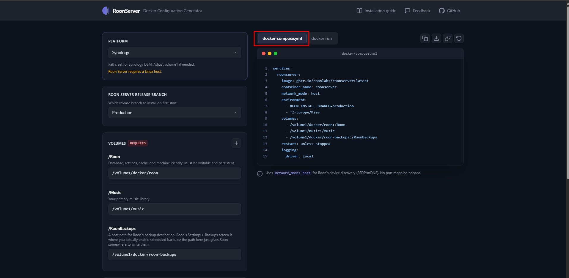

Option 2: The docker-compose Method (Via SSH)
If you prefer to use the .yml file so your configuration is permanently saved, we can deploy it through SSH instead of the broken Synology GUI.
  1. Open File Station on your Synology. Inside your main Docker folder, create a new sub-folder named RoonServer.
  2. Inside that folder, create a plain text file named exactly docker-compose.yml.
  3. Go to the Configurator, set your paths, click the Docker Compose tab, and paste that exact text into your new docker-compose.yml file and save it.
  4. Open your SSH terminal, log in, and get admin rights (Follow steps 2-5 from Option 1 above).
  5. Navigate to the folder you just created by typing: cd /volume1/docker/RoonServer (adjust the path if you named your shared folder differently) and press Enter.
  6. Type docker-compose up -d and press Enter. Docker will read the file and launch the server.
