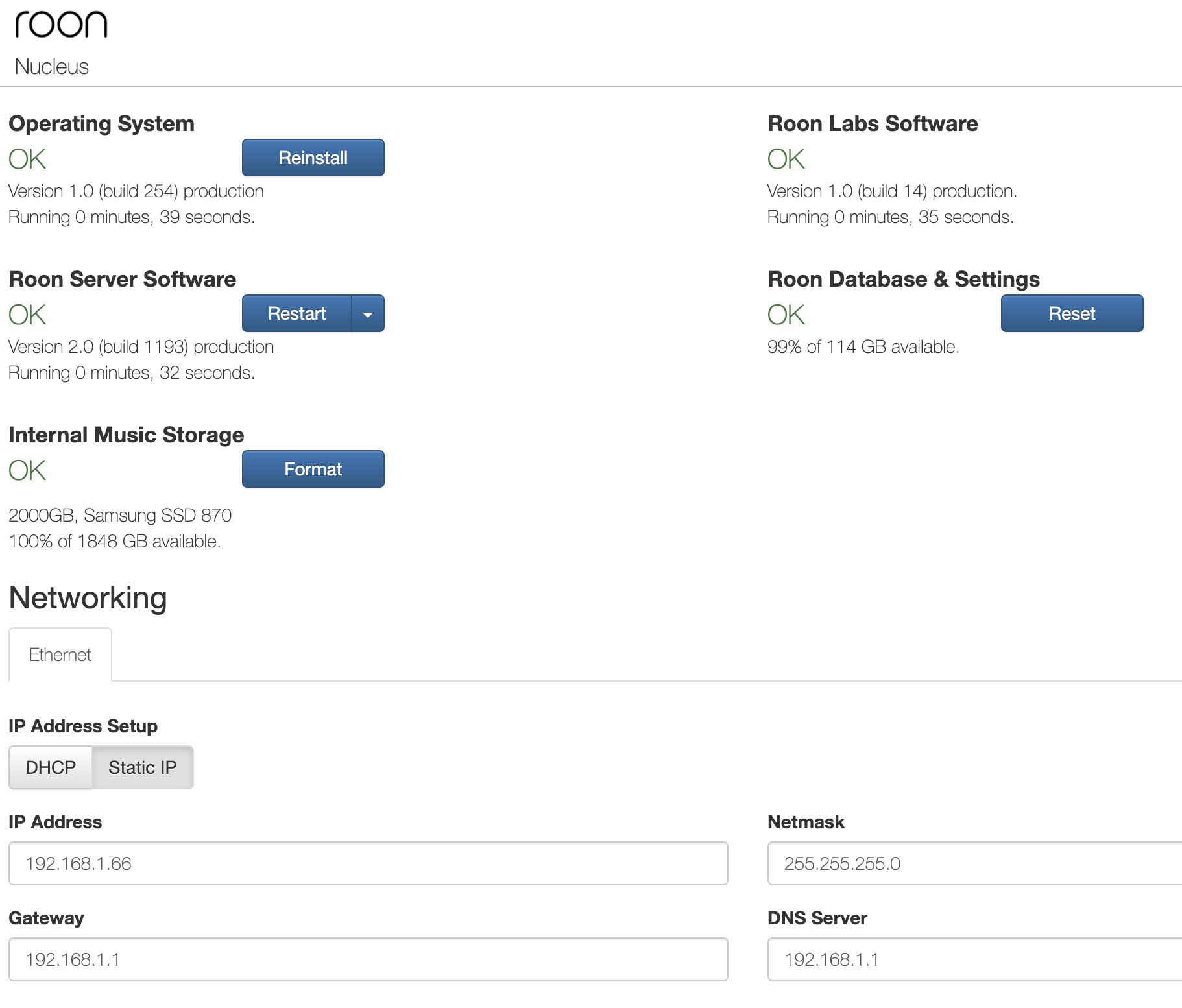

I have set a static IP for the nucleus and checked on both the nucleus and router that IP is the same. Set port forwarding for that IP address and restarted everything.
