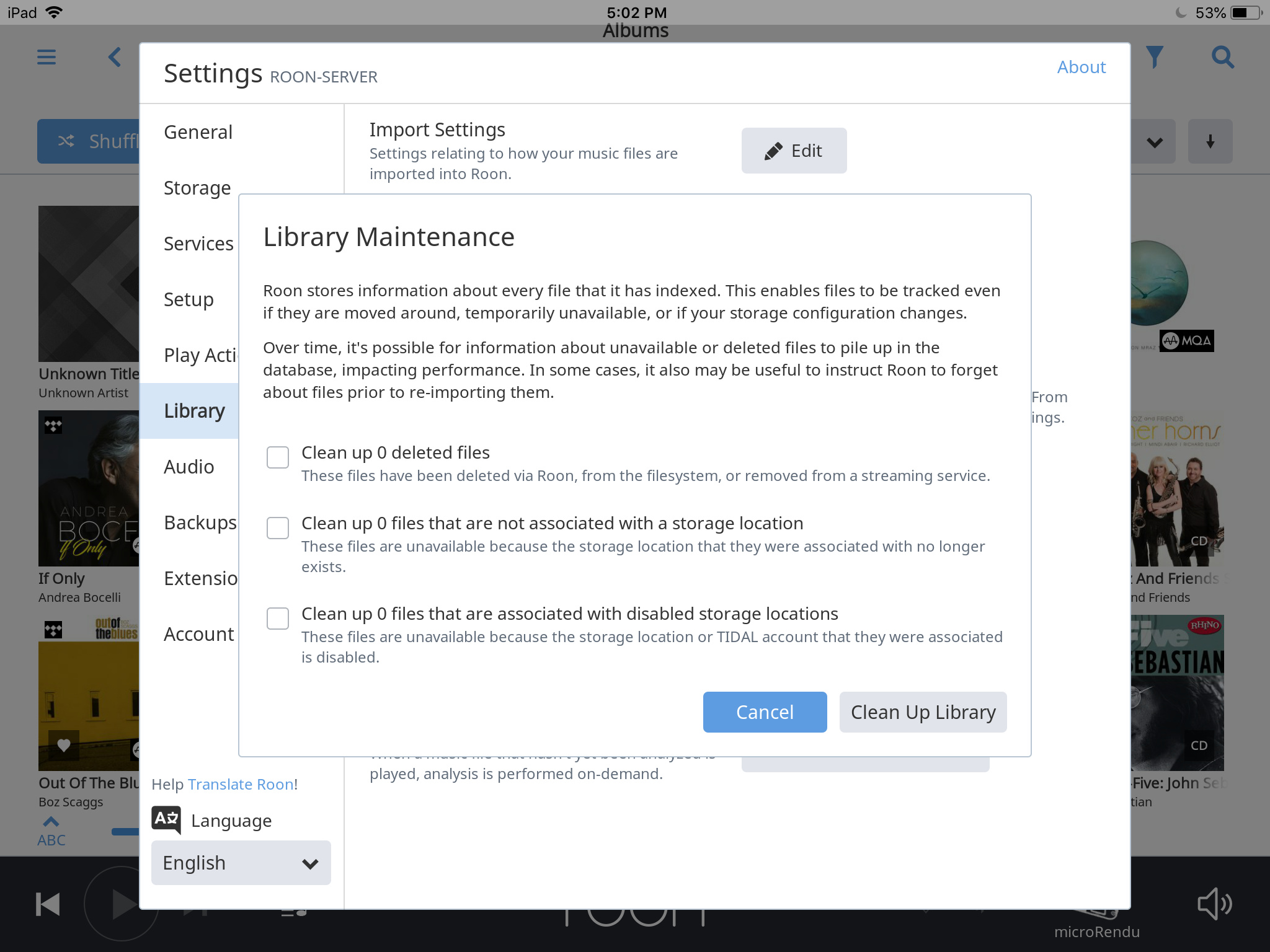

Here’s the latest attempt. Looks like the metadata for this album is messed up.
When I strarted this last time I tried to delete the albums. When that did not work I hide them, but that just adds to the problem it seems.

But I am still left with the orphan album with the 2 corrupt files.
Other than trims to hide the album is there any other way to fix this?
