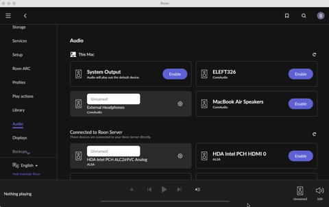

If you navigate to Roon Settings>Audio, you should see an option for the ‘system output’ of your local remote device.
You can click ‘Enable’ and then click your speaker/zone icon on the bottom right-hand corner of your screen, which will pop up a list of your zones - here is where you can select your ‘system output’ zone for testing purposes. Here’s a screencast display of this process:
system output mac zone giphy
You can then select BBC and begin playback as normal.
Let us know if you run into the same issues after trying the above, thanks Karen! :raised_hands:
