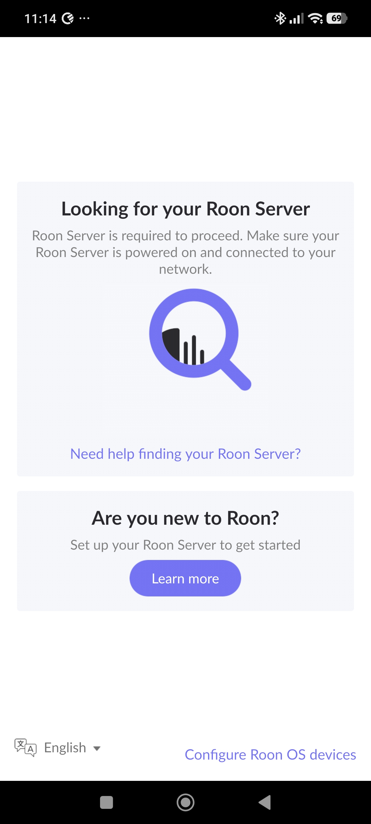

· Cannot find my roon server, reboot and try with different devices and problem still
Cannot log in on my windows pc neither on my Android devices
Router is a live box fibra tried inserted IP manually but keeps searching for roon

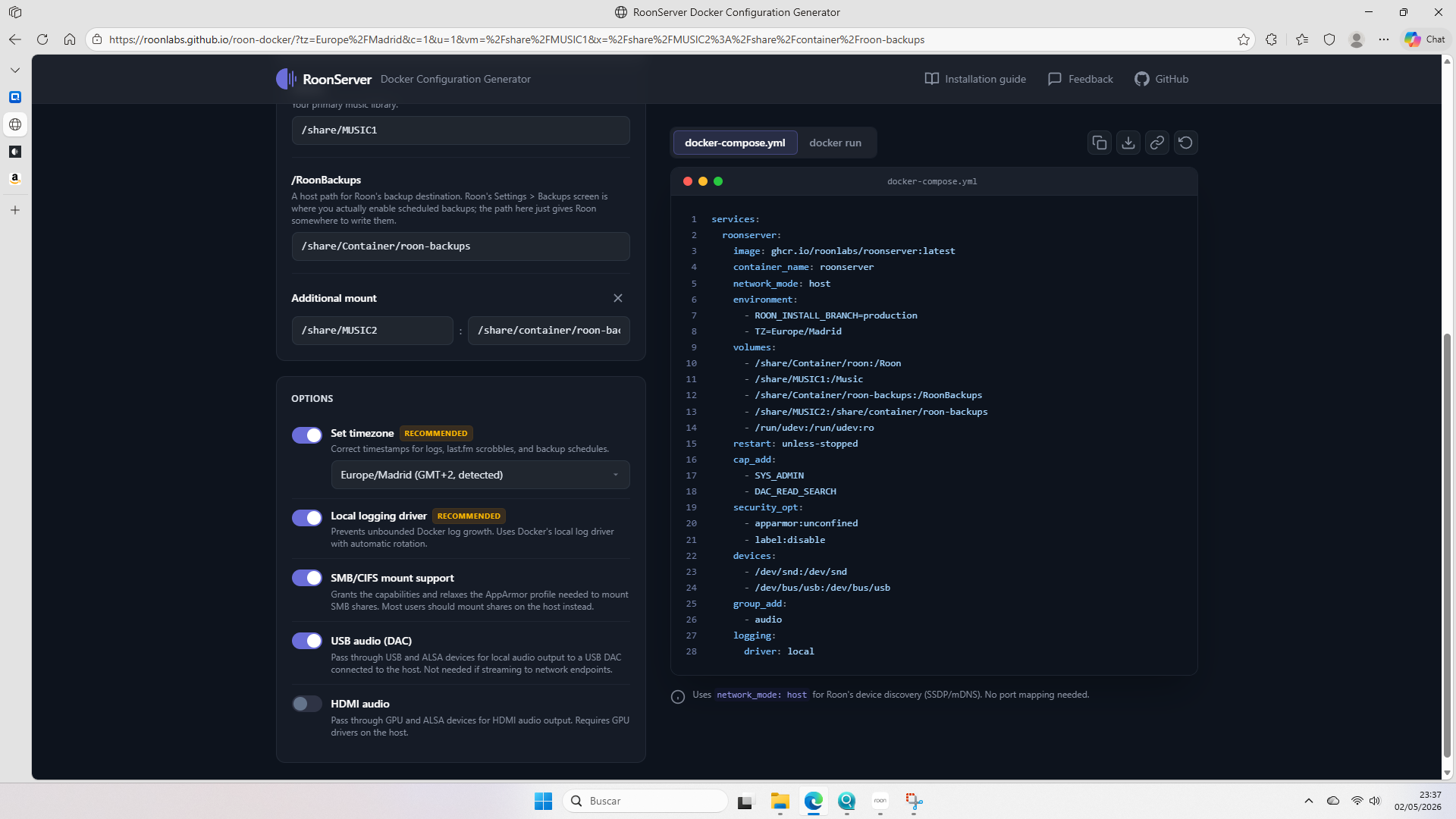

Hi, Connor
As I did not receive any more replies from your side, on different posts
about Roon access problems with Qnap NAS, I did follow the instructions on
how to create a container in the container station with a link from Roon on
how to do it.

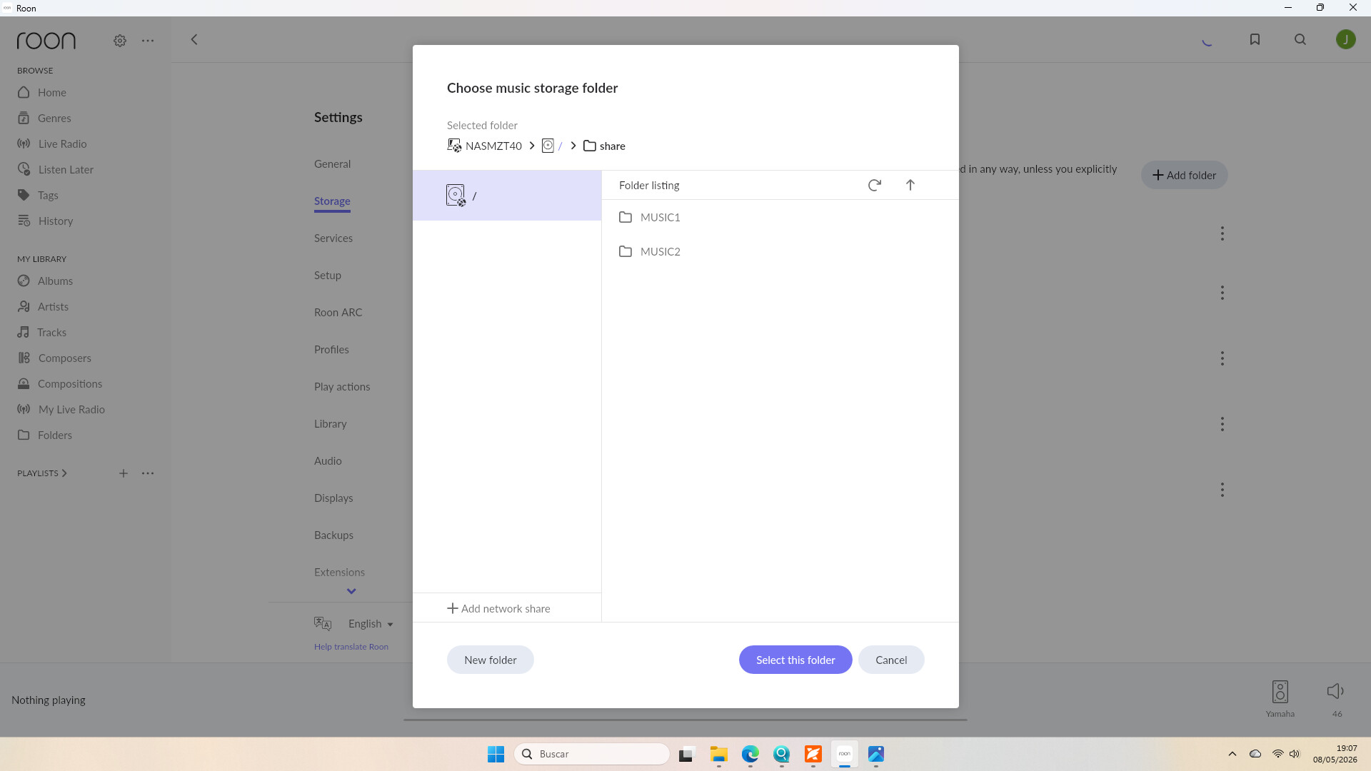

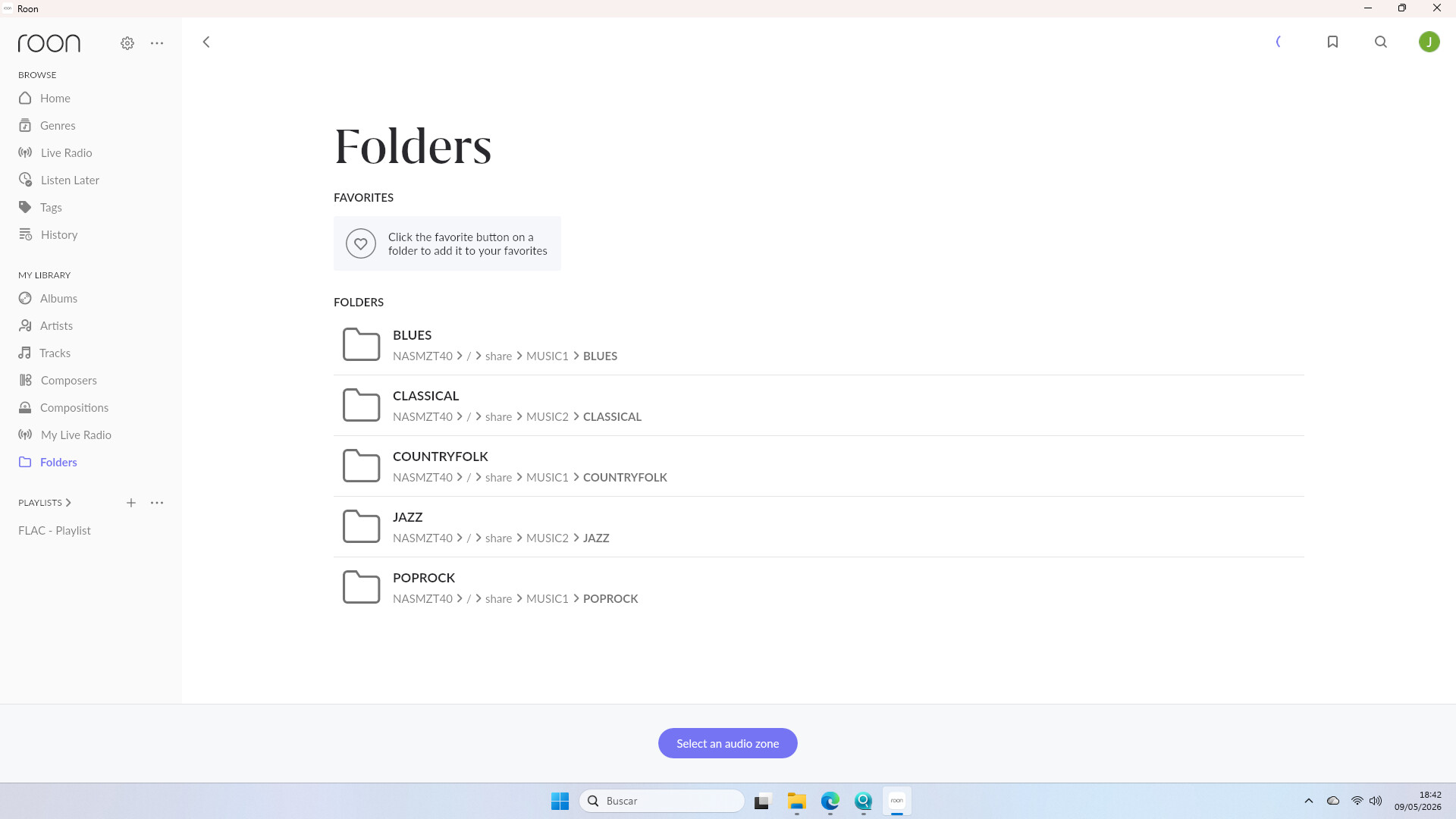

I tried several times as was little bit difficult for me but finally got
access the only problem is on how my music is now on folders, as I have on
my NAS music in two different HDD discs VOL1 +VOL2
On the link to create container there is option for music file and to add
additional mount.  Now I have  no ideal folders to manage.
I attached some screencaptures here to show it to you.

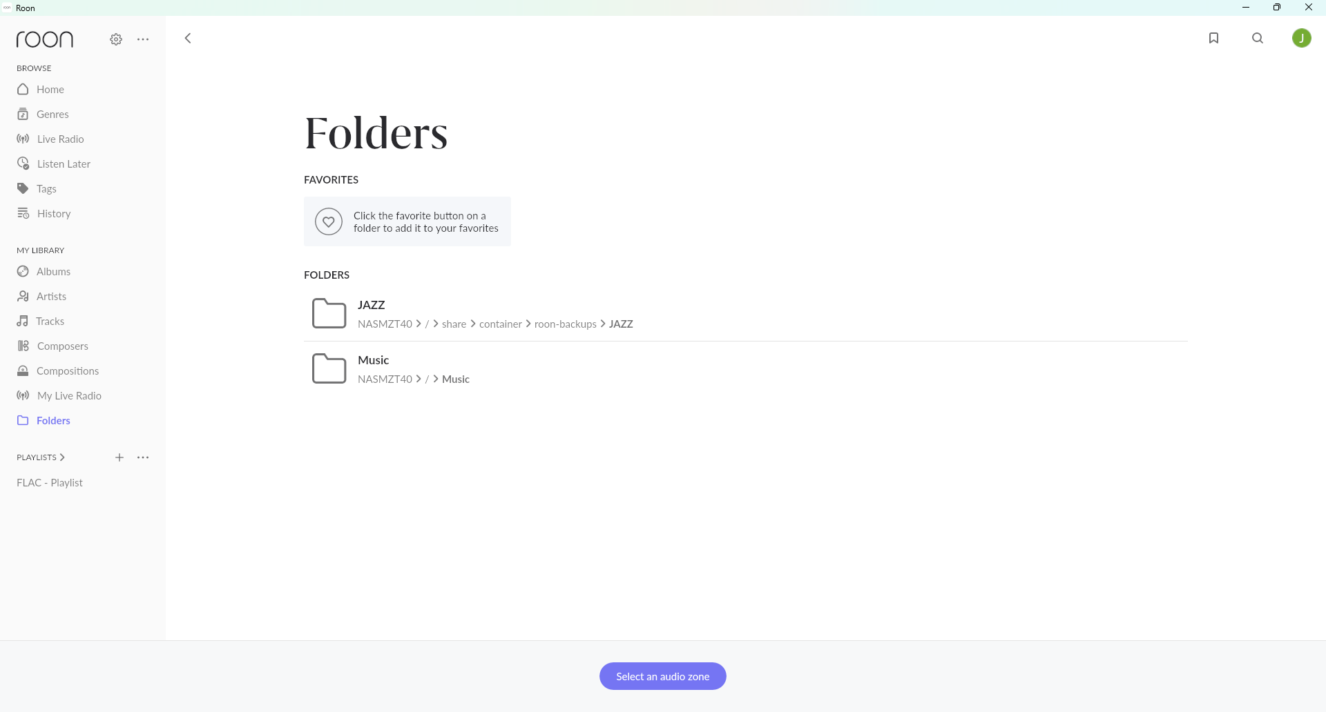

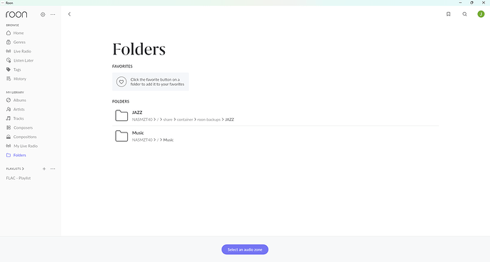

Previously I have
 in Vol1
POP-Rock
Blues
in Vol2
Jazz
Folk
Country
Classic
 If any can be done to solve it, please advise.
Best regards
Jose

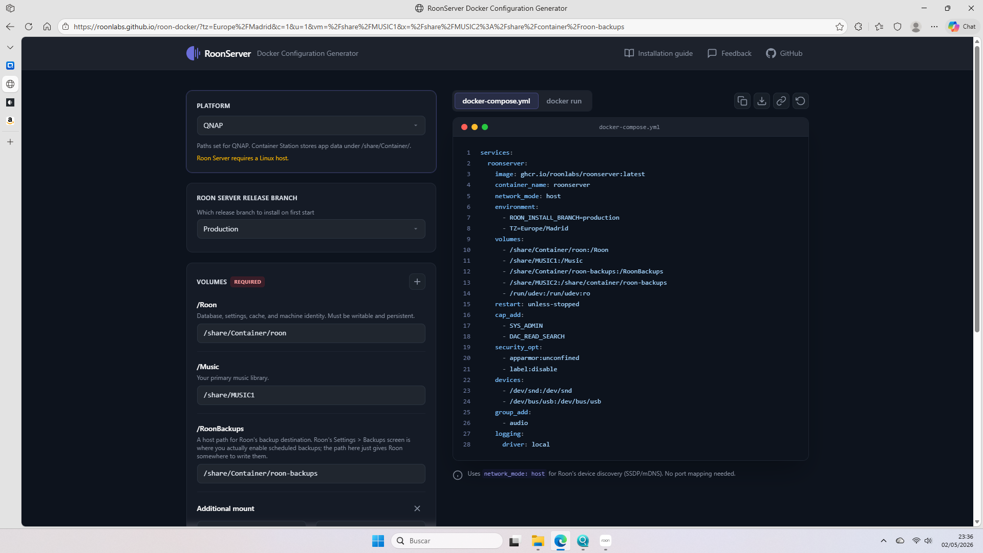

Hey @jose_manuel_gallardo,
Thanks for the update! When you set up Roon in QNAP Container Station using Roon’s Docker instructions, the music folders from your NAS volumes (Vol1 with POP-Rock/Blues and Vol2 with Jazz/Folk/Country/Classic) need to be explicitly bind-mounted into the container.
Right now they aren’t, the paths the container is looking for (/Music and /share/container/roon-backups/JAZZ) either don’t exist or aren’t properly mapped.
Here are some next troubleshooting steps:
  1. Fix the container volume mounts in QNAP Container Station
You need to edit your Roon container and add bind mounts for each music folder. In Container Station:
  • Go to your Roon container → Edit → Storage/Volumes
  • Add a mount for each music location, for example:
    • Host path: /share/VOL1/POP-Rock → Container path: /music/pop-rock
    • Host path: /share/VOL1/Blues → Container path: /music/blues
    • Host path: /share/VOL2/Jazz → Container path: /music/jazz
    • (and so on for Folk, Country, Classic)
The exact host paths on your QNAP will look something like /share/CACHEDEV1_DATA/Music or /share/VOL1_DATA/... — check your QNAP File Station to confirm the exact paths.
  1. Update Roon’s watched folders to match the new container paths
After fixing the mounts, go into Roon → Settings → Storage and point each watched folder to the new container-internal paths (e.g. /music/jazz, /music/pop-rock, etc.).
  1. The /share/container/roon-backups/JAZZ path looks wrong
That path looks like it was set up as a workaround and is mixing backup storage with music storage. Once you have proper music mounts, remove this location from Roon’s storage settings.
Let me know if this helps! :folded_hands:

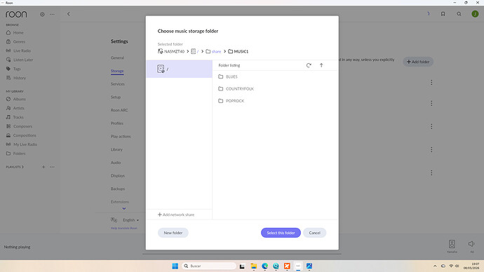

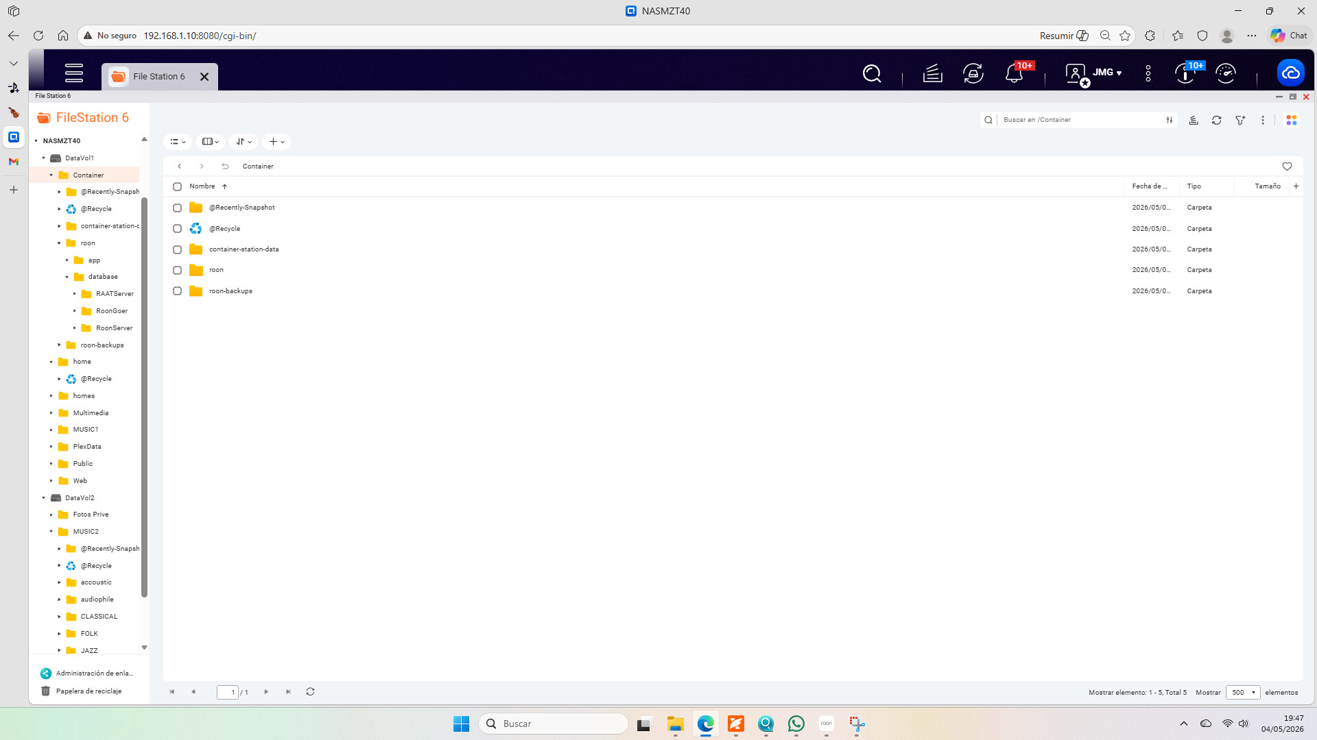

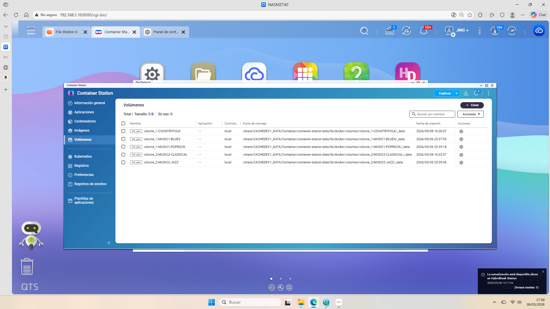

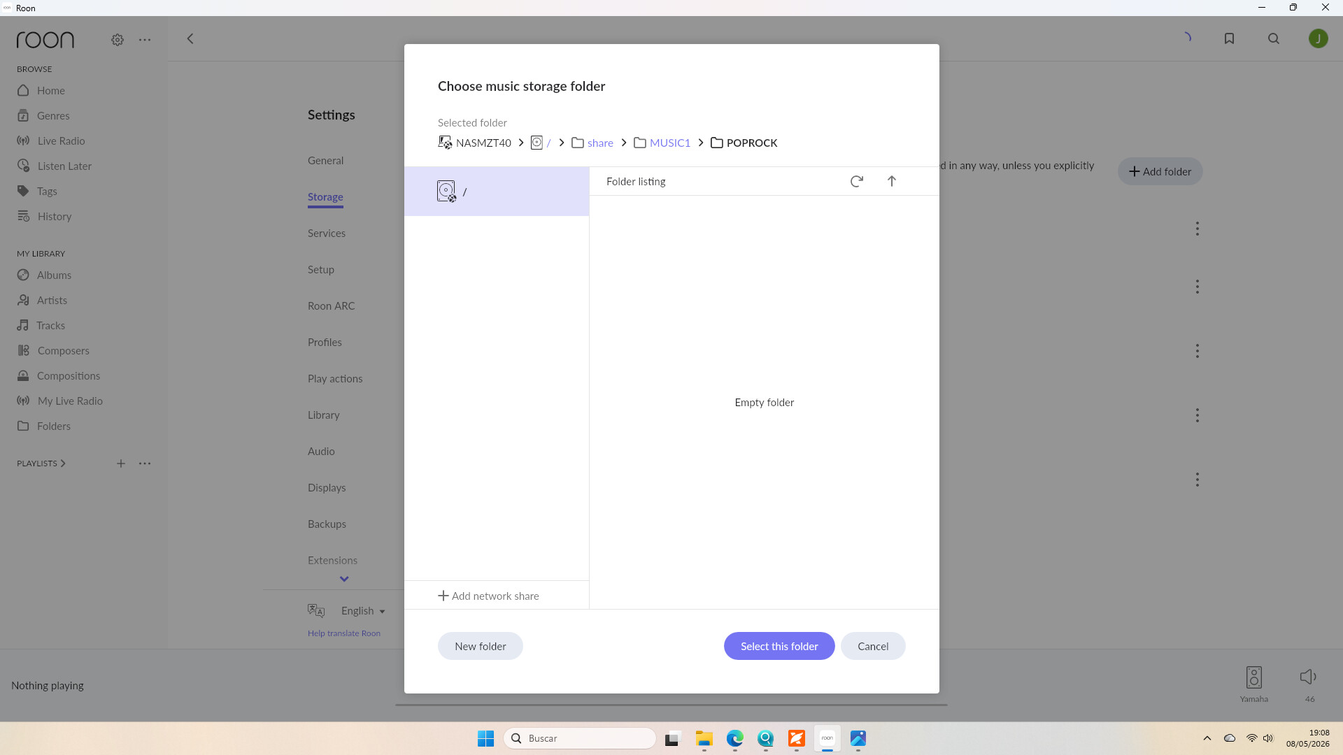

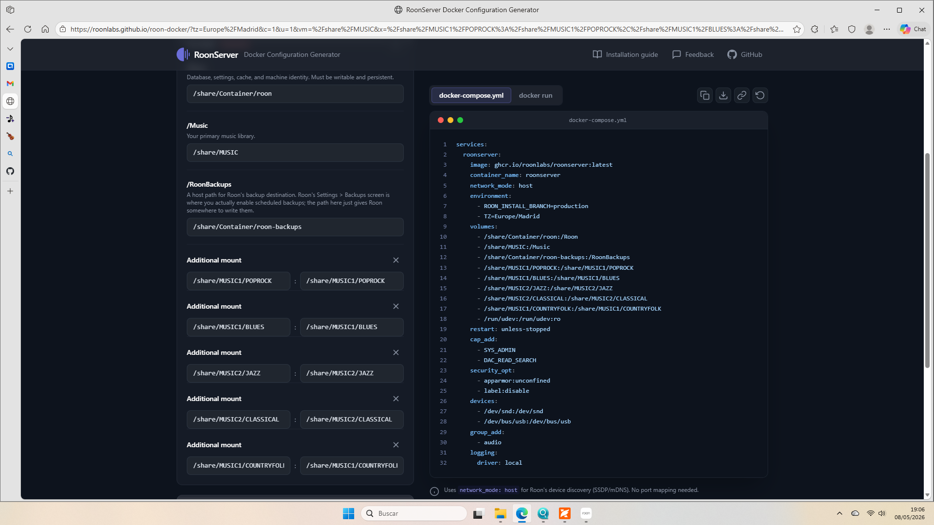

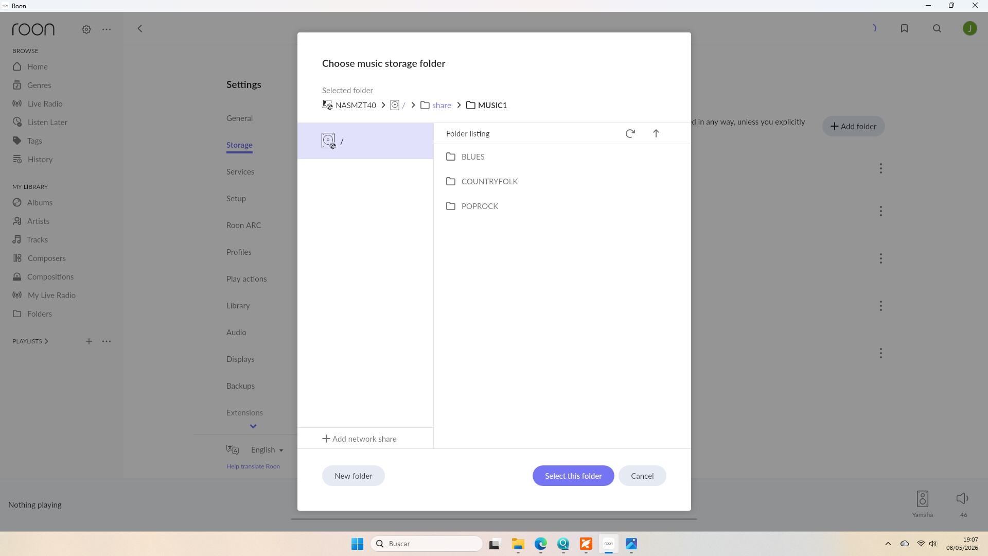

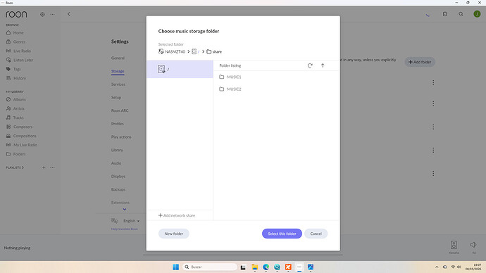

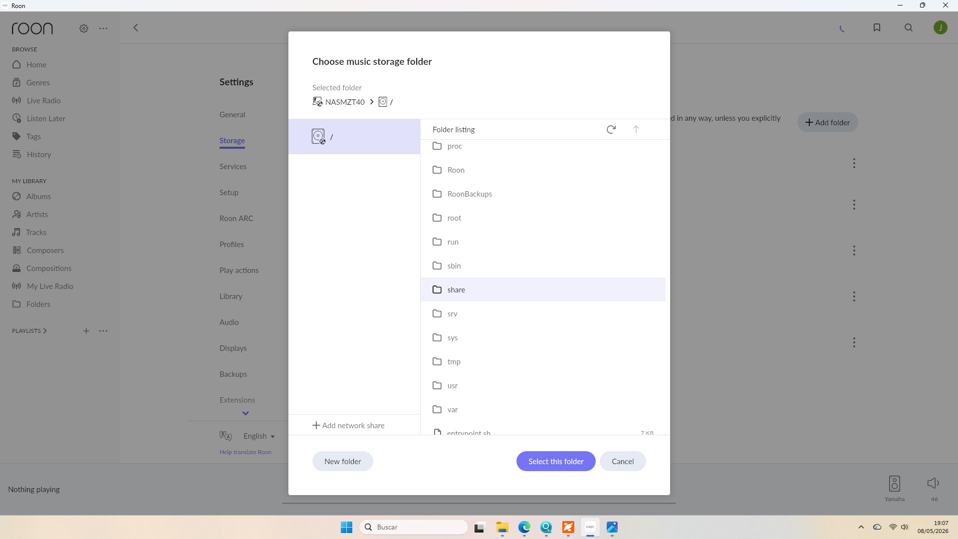

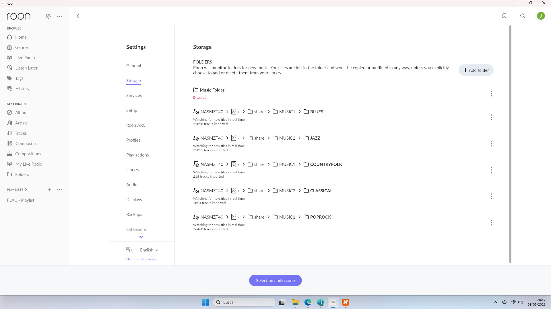

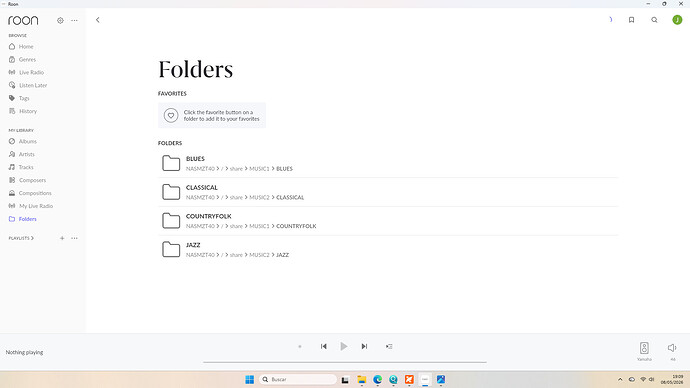

Benjamin, thanks for yours but I am still doing something wrong.
I create volumes as I didnt before, deleted container application and creating new one with new instructions, incorporating mounts additionals.
When running ROON tried to create folders accordingly all ok except for one folder POPROCK unable to do it.
I attached screencaptures for your info and please can you tell me what is wrong

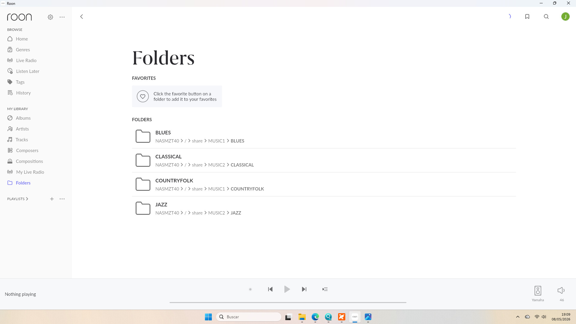

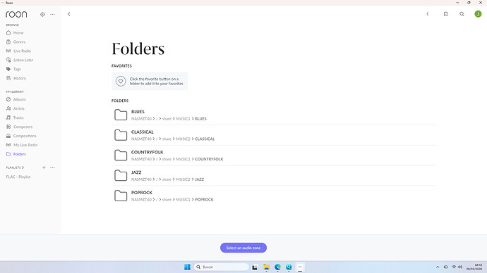

Benjamin, I solved it, delee vol in container for folder and edit new again, then add in roon and worked. Guess was I did name it when create volume without blank space POPROCK instead of POP ROCK. Now it works.
I checked for backups and in file station each folder has a roon backupfolder.
Only question is why sometimes when start running roon do not detect audio zone (my amplifier connected via usb to my NAS) only happens sometimes I have restart NAS, Roon, etc to detect my audio zone
Apart from that I think now all is ok.

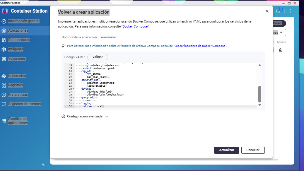

Hi, Benjamin
This is not easy for me, as I do not quite understand how to do it.
I tried to find on my Qnap NAS disabling USB auto suspend and cannot find it.
Alsoon container I do not know where I have to insert line
echo -1 > /sys/module/usbcore/parameters/autosuspend
KSTB6130 is my router what I did is give static IP to my NAS on router settings.
If you can help me on this, when start roon this morning happen same again, I did restart NAS and roon, audio usb to my amp show on again
I attached screenshot of my container, shall I add instruction after line 19 or how to proceed
Please advise
best regards
Hello @jose_manuel_gallardo,
You are doing great! Please don’t worry—handling terminal commands can feel intimidating, but you are looking in exactly the right place.
You are completely right to be cautious about editing that container file. As it turns out, the USB power-saving feature isn’t actually happening inside the Roon container itself—it is being managed by the main host operating system of your QNAP NAS. Because the NAS hardware controls the physical power to its own USB ports, when Roon pauses the music, the QNAP thinks the port is idle and cuts the power connection to your amplifier. When you restart the whole NAS, it wakes the port back up, which explains why it keeps temporarily fixing the problem.
To permanently stop the QNAP from turning off your USB audio port, we need to run that command directly on the NAS system. Here is the easiest way to do it:
