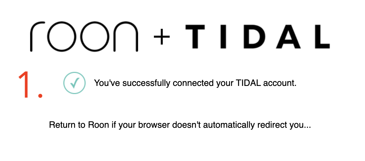

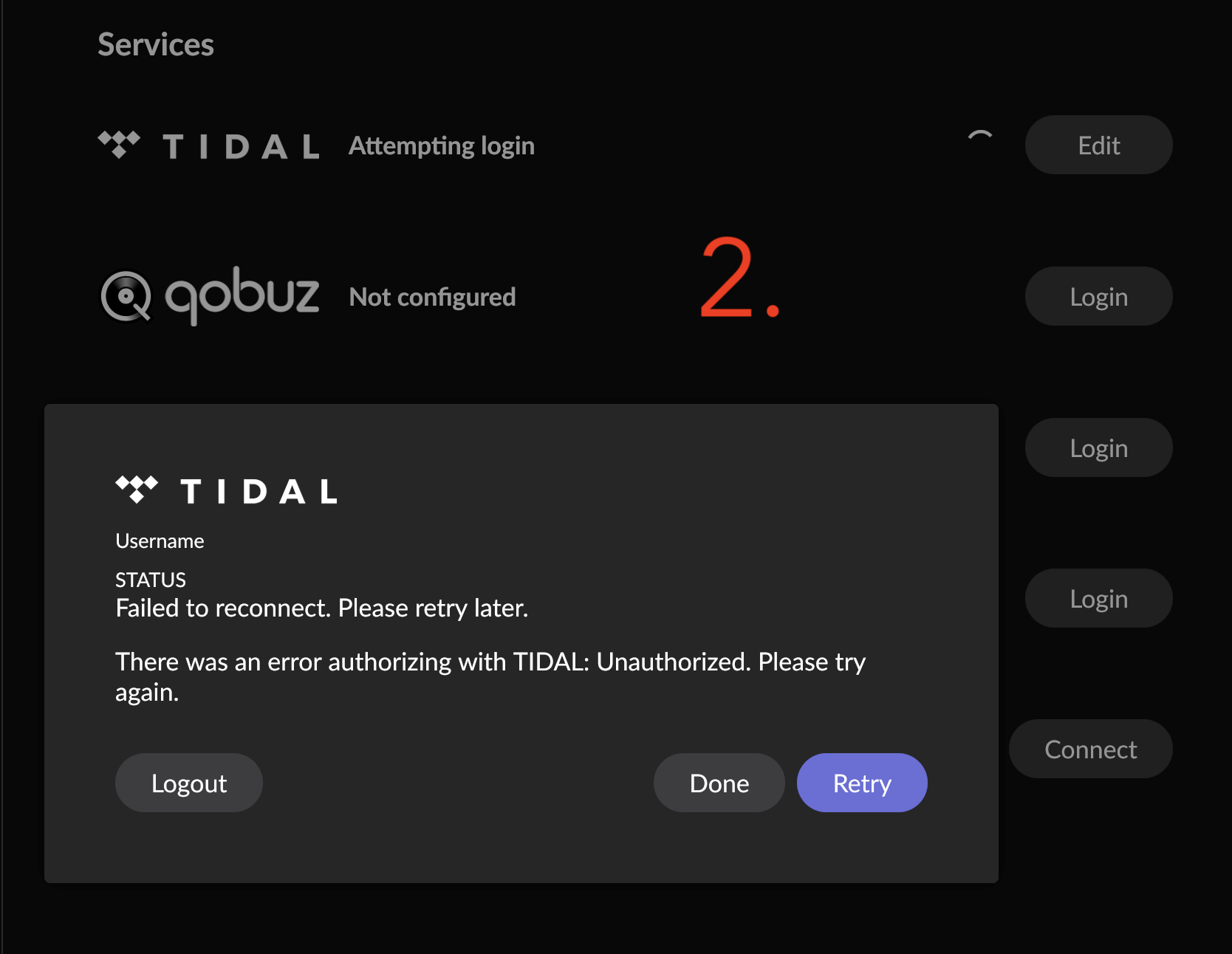

Hi benjamin,
that is the problem. The website says “Login successful”, but login does not work.
See screenshots.
In the meantime, I uninstalled and re-installed Roon and had the same issue. All of a sudden, today it worked and I started to set up everything. Then, after shutting down the computer for a while, I am receiving the message shown in the screenshot. It all worked really well up to now, but this is a new experience with Roon to me. All this while internet connection is flawless and TIDAL works with no issues.

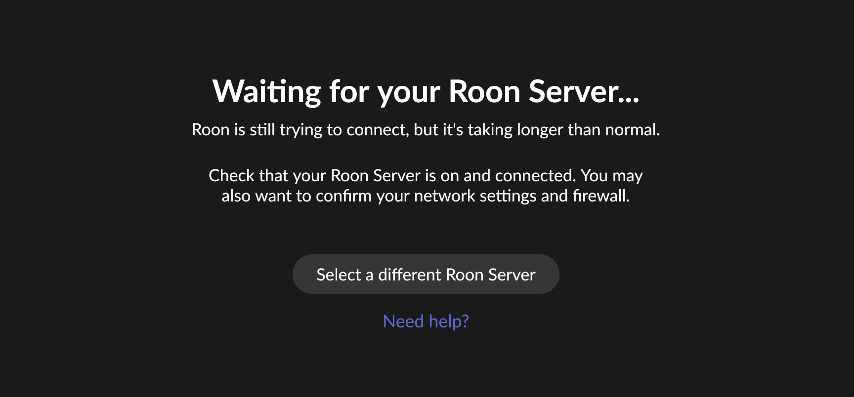

Hello @lobopanic
Since you’re running macOS, the behavior you’re seeing is consistent with the newer, stricter Local Network permission controls in the recent macOS releases.
Please try the following steps:
  1. Open macOS System Settings → Privacy & Security → Local Network
  2. Make sure Roon and Roon Server are both enabled
  3. Even if they are already enabled, please toggle them off and back on
  4. Fully quit Roon Server from the macOS menu bar / task bar
  5. Reboot your Mac
  6. After reboot, launch Roon again and check if the devices is avaliable again.
Once these permissions are refreshed and the system restarted, your Roon Server should reappear.
Please let us know if the issue persists after these steps, and we’ll continue from there.
Hello @vadim
thank you for your response. I already managed to solve the “Waiting for Roon Server …” “issue”.

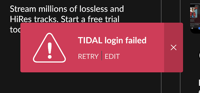

Roon is also running again on my system, but I identified an uncommon behaviour.
Roon Server NOT running : Tidal app starts and can be used immediately after it is loaded.
Roon Server running : Tidal app starts but states “internet connection not available”.
In this case, Roon cannot log in to Tidal, which is probably expected. Waiting for a few minutes after booting the computer and then starting Tidal works as well. Then Roon logs in and works after clicking on “Retry” in the error pop up window, but it never starts without this red pop up.

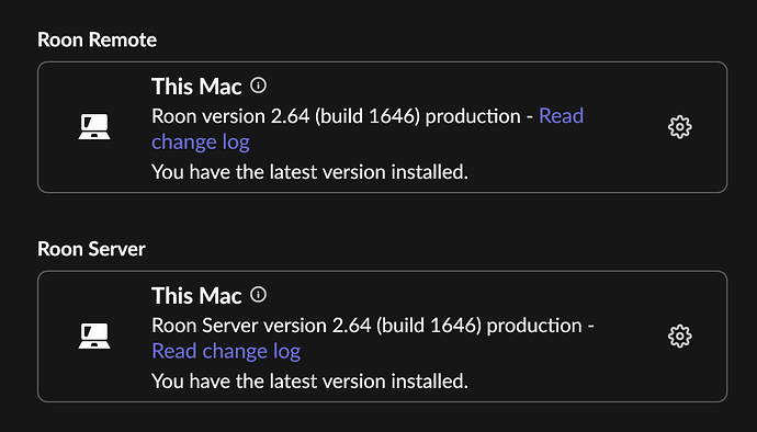

My system :
MacBook Pro 2021
macOS Sequoia 15.7.5
This MacBook is Remote and Server.
Hey @lobopanic,
Thanks for the update! This specific retry dance suggests a temporary bottleneck or a conflict in how macOS handles network requests during the initial startup sequence.
I’d go through the steps @vadim mentioned above if you haven’t already:
If that doesn’t help, Private Relay can occasionally mask the network status from apps, leading Tidal to believe there is “no internet” because it can’t establish a direct handshake immediately.
  • Go to System Settings > [Your Name] > iCloud > Private Relay.
  • Turn it OFF temporarily and restart to see if the behavior persists.
If neither help, let’s see if clearing the Tidal cache improves the behavior:
  • Exit out of Roon/RoonServer (from the taskbar)
  • Find and open your Roon database
  • Navigate to /Library/RoonServer/Cache
  • Move the contents of the /Cache folder elsewhere, like your desktop
  • Try restarting Roon and verify if the issue still occurs
We’ll be monitoring for your reply and results :folded_hands:

Hi @connor ,
thank you. Unfortunately, none of the above approaches changed the behaviour. Private Relay is a feature that is included in iCloud+, which I don´t have.
No problem, I got it running on my system again. I just have to wait several minutes after booting the system before starting Roon.
