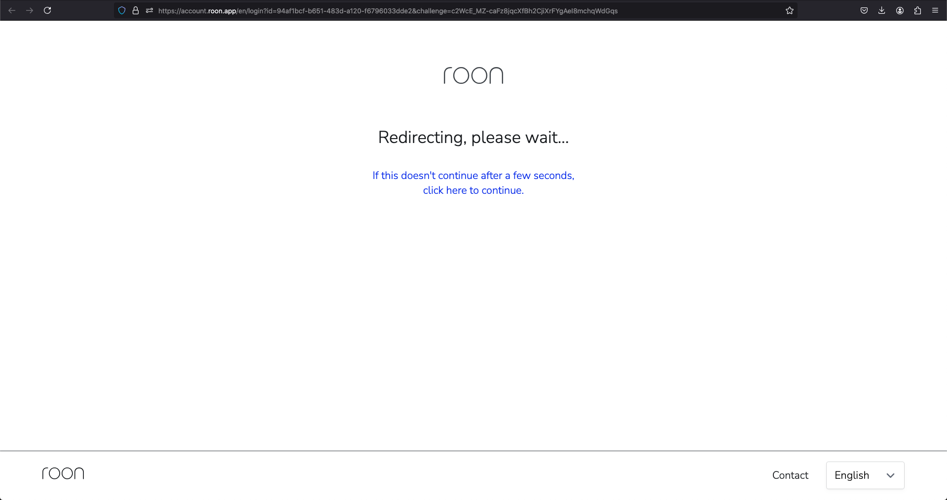

I'm using Grimm Audio MU2 as the Roon Server, which I've just switched over from the MU1 and this is when the problems began. It will not allow me to enter the Roon account as the screen just sits. And when I went to reauthorized the MU1 I was unable to do that as well. Now I cannot connect to Roon at all and cannot get into my account.
The Grimm Audio MU2 is connected to the wireless router.
· I'm having trouble logging in
· I can't log into the Roon app
I am not able to get into to my Roon Account to select/authorize one of my remotes. I've tried to switch to the Grimm Audio MU2 but I am asked to log in and then the screen just sits there. Nothing...
