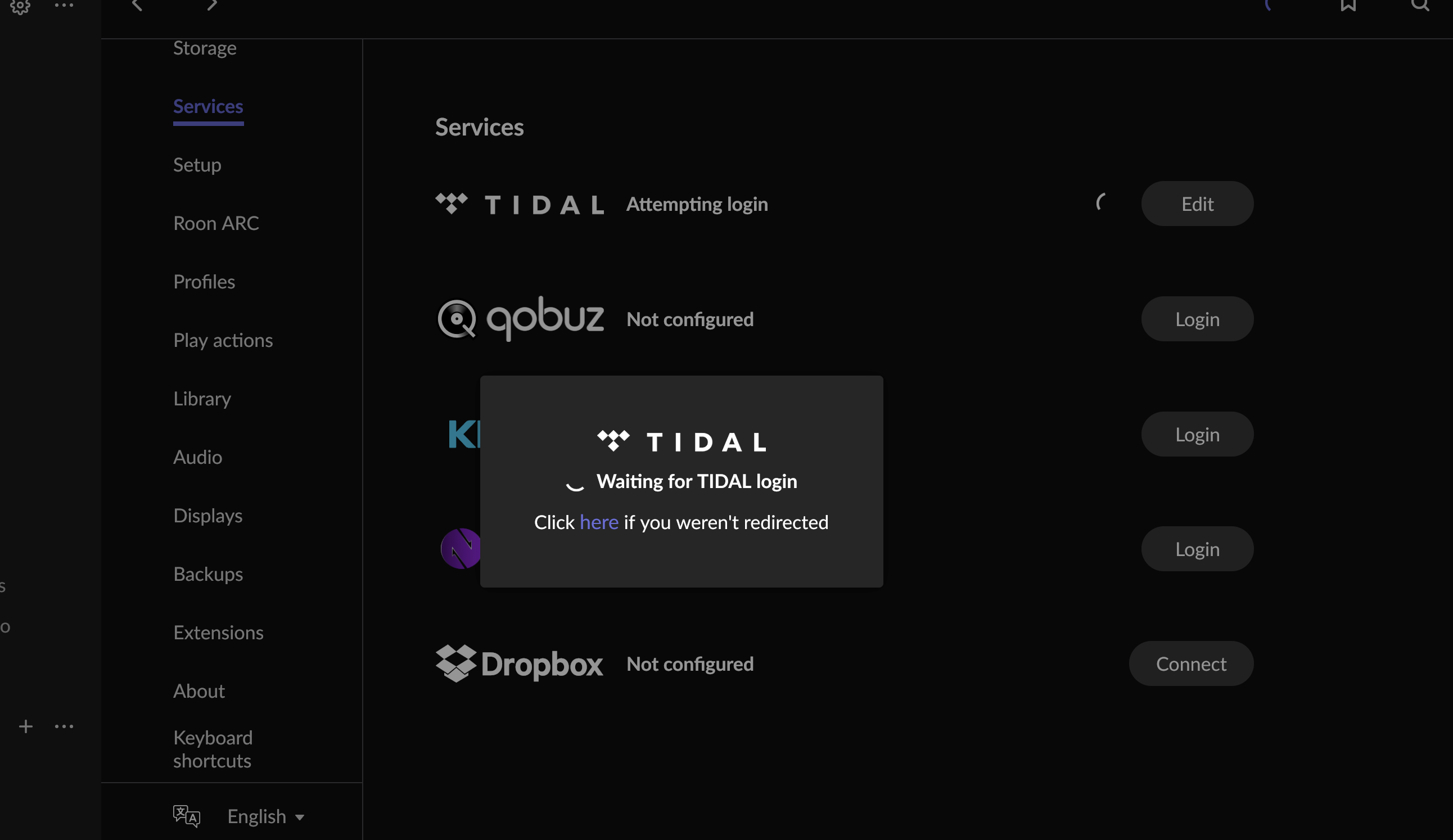

After recent Roon updates (currently both server and remote are on 2.65 1653) I can no longer log into Tidal. This has been working fine for years but isn't any longer. I can log into Tidal without issue on the Tidal app and website, but when attempting to login from Roon, after the Tidal login successful redirect in the login flow I get the 'Waiting for Tidal login' in Roon with the spinner until it times out.
Not sure if it's related, but I also get a timeout when the server checks for an update ('There was an error checking for an update') and 'Can't connect to Roon search' after timeout when searching in Roon.
My server is macOS 14.8.5 on an M1 Mac mini.
ISP is Spark NZ with a router supplied by them, with TP Link Deco mesh network into which the Mac mini is plugged in via ethernet. This is very unlikely to be the issue as there were no issues for many years until a few weeks ago when I updated Roon apps and it broke.
