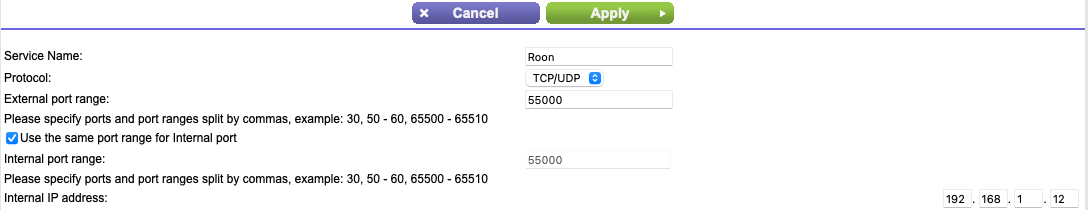

I have followed your instructions to making some setting in my router, I use the port number is “55002”, but it still can’t use ARC. You know initially I can run ARC when I use my windows laptop, but when switched to Mac mini, it doesn’t work now. All the setting in my router remained unchanged. After using the forward port service in my router, the new diagnostics data is as below. Please help me to figure it out. Thank you!

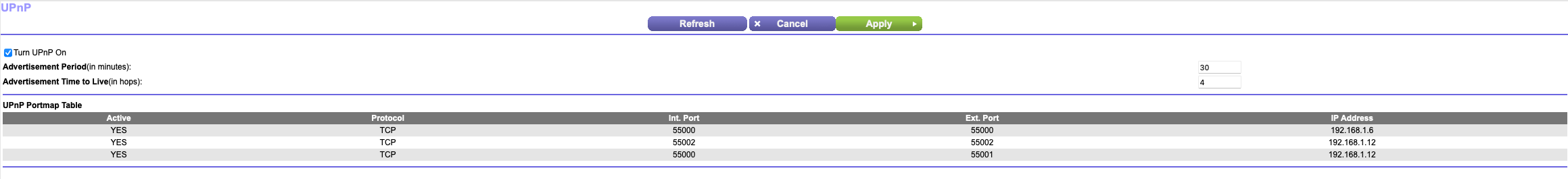

I have used port checker which you provided to check my 55000 and 55002 port. It said the port is closed. How can I open it? Since I am not good at debugging network setting. Could you please give me an explicit solution? Many thanks.

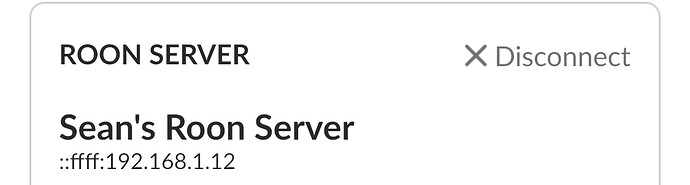

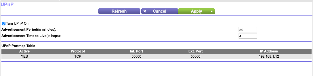

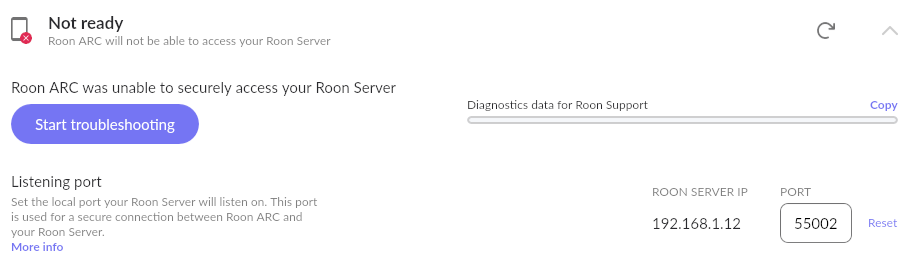

Now my Roon is running on Mac mini, the ip address is 192.168.1.12. I have tried both port 55000 and 55002 in Roon, ARC still can’t be used. I don’t do any setting in my router either when running Roon on windows or on Mac.
I have followed your instructions, but I failed again. The following information is from the ARC test.
“ipv4_connectivity”: {“status”:“NetworkError”,“status_code”:504,“error”:“error: Error: ETIMEDOUT, response code: undefined, body: undefined connected? undefined”},
“external_ip”: {“actual_external_ip”:“45.aaa.bbb.ccc”,“actual_external_ipv6”:“null”,“router_external_ip”:“null”},
“upnp_autoconfig”: {“status”:“NotFound”}
Thanks.

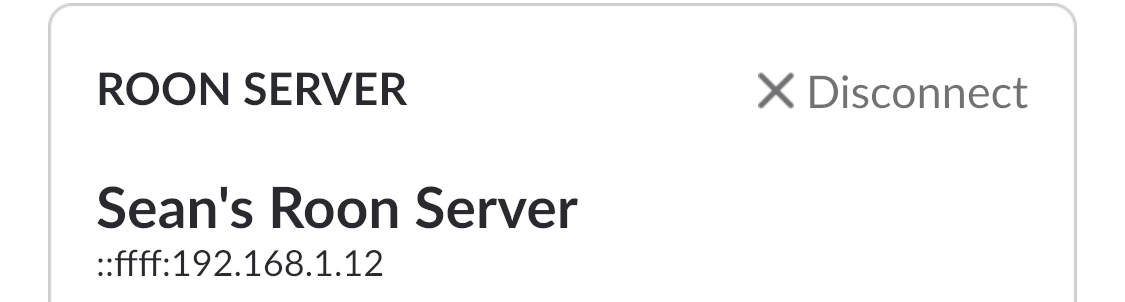

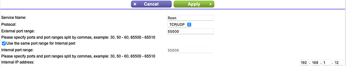

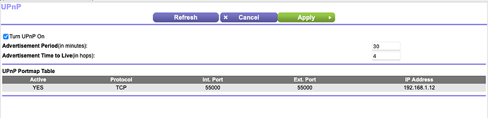

I have capture some screens
for your reference. I have tried port 55002 and 55000 again, they are the same.
I have tried. But the diagnostics information remains the same. So dispirited…

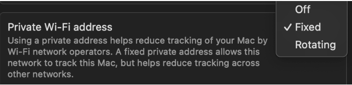

Thanks for the additional details, and thank you for the help so far @anon15113244! As a next step, let’s see if setting your Mac IP settings from ‘rotating’ to fixed may help. One of the myriad network security changes introduced with MacOS 15.x was MAC address randomization.
I recommend navigating to your Network settings (WiFi → Details) and checking whether the Mac in question is relying on a Fixed, not a rotating, Private WiFi Address.
Screenshot 2025-02-10 at 11.49.28
Let me know if this changes any behavior for you. :+1:
Hi, @benjamin
I have tried to fix the ip, but nothing changes, malfunction remains the same.
