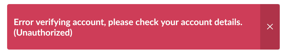

cant login the service Qobuz on a mac mini with system Tahoe 26.4.1. There whas no problem before the update of Roon. Roon on this moment version is 2.67 (build 1661)

I can confirm from a fresh Roon Server diagnostic report, the error we’re seeing is:
"Invalid username\/email and password combination"
If you’re attempting to login via an account created through facebook or a third party, please head into the Qobuz app directly and update your login method to reflect an email and password. Here’s more info:

Hi @marco_molhoek,
While your Qobuz credentials (username/password) might work to login to Qobuz directly, they are still relying on the OAuth flow associated with another external account (Google, Facebook, or Apple).
You will need to create a new password in the Qobuz account page directly and then use this password to sign in via Roon.
The specific instructions can be found at the link @vadim has shared above.
