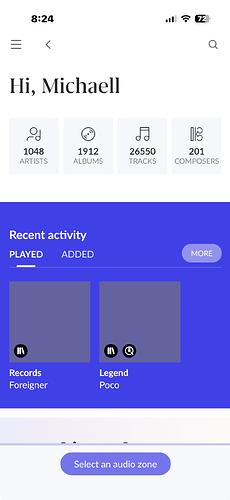

Thank you! It worked. But here is my problem…My iPhone app shows no artwork, rendering it useless. I was hoping that resetting my database would remedy the problem, but no luck. If I access via the roon app on my PC, all works flawlessly. But the phone app is so much more convenient. I have deleted the roon app on my phone and reinstalled it, all to no avail. Recommendations? Best Michaell Huber

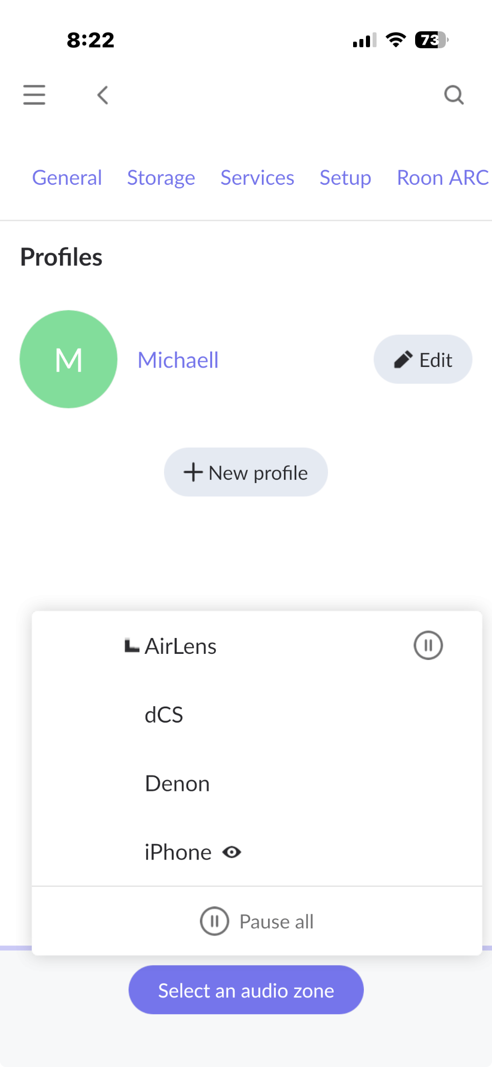

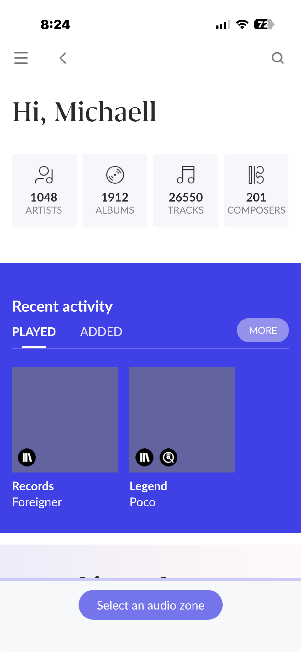

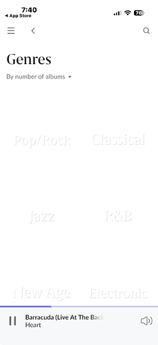

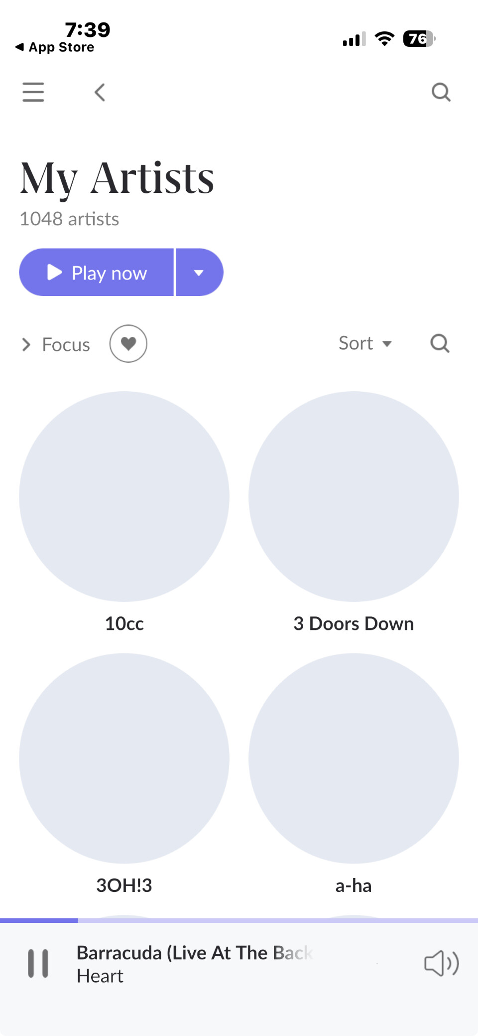

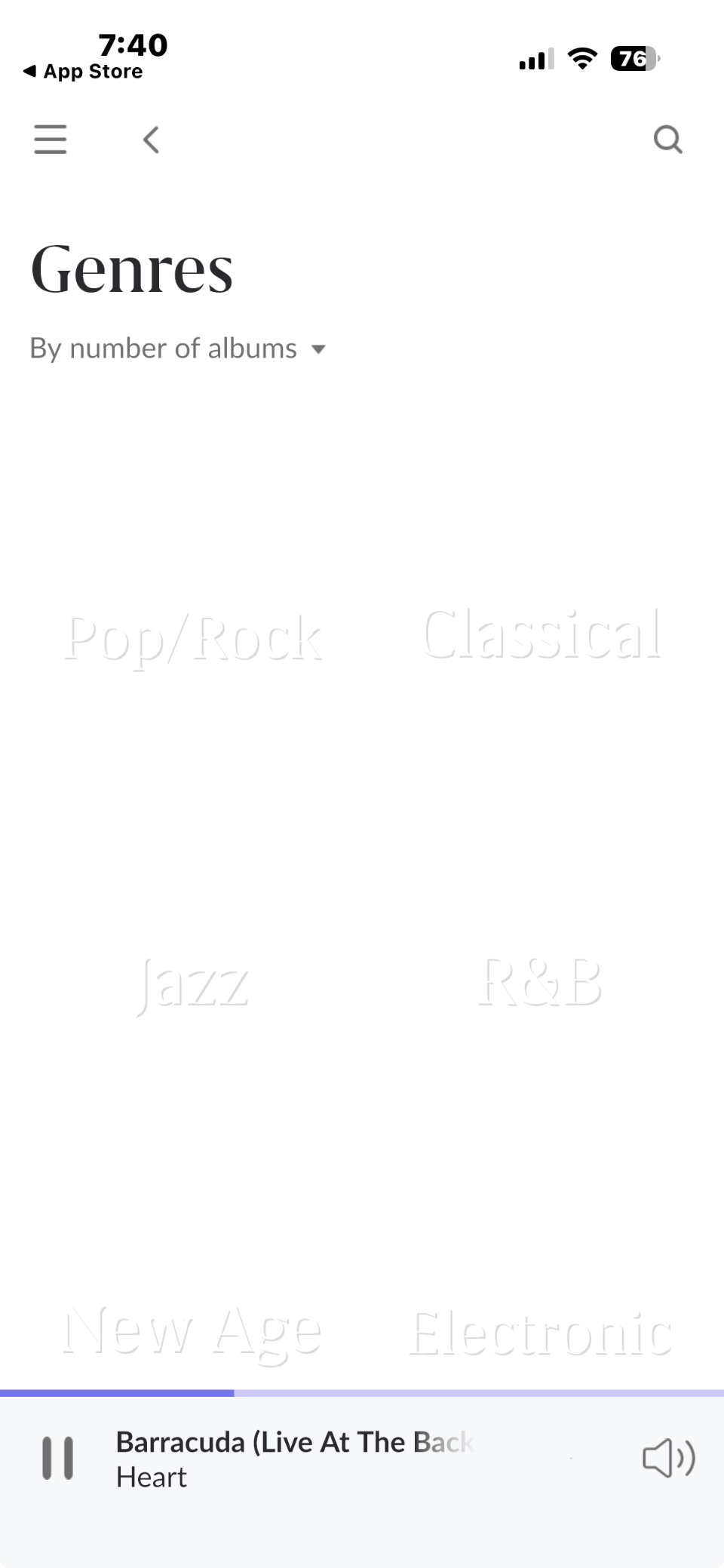

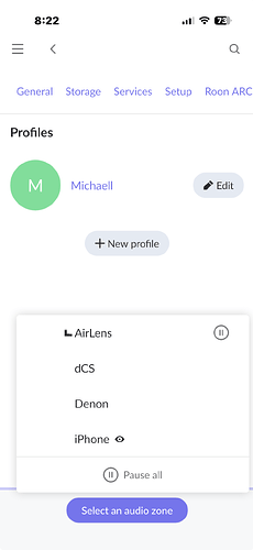

Hi Alex,
I have removed and re-installed the app multiple times. I have attached some screenshots of what I see, or shall I say don’t see.
I also put the roon app on my iPad and IT WORKS. Must be the phone. Are there phone settings that could be affected???
@Michaell_Huber ,
Thank you for confirming.
For some reason, while we do see your iPad in the list of connected devices, we do not see your iPhone.

@Michaell_Huber ,
Thanks for sharing the logs.
We reviewed them and noticed that your iPhone appears to have multiple active network interfaces/IPs, which may indicate that a VPN or another type of tunneling service is enabled on the device.
We can also see repeated socket connection failures when the iPhone tries to load image/artwork content from your Nucleus, which suggests that the issue is likely related to the phone’s local network path rather than to the Nucleus itself.
Could you please temporarily disable any VPN, Private Relay, DNS filter, ad blocker, or other tunneling/security software on the iPhone and then test again?
If the issue still persists, please also try resetting the iPhone’s network settings by going to:
Settings → General → Transfer or Reset iPhone → Reset → Reset Network Settings
Please let us know whether that helps.
Thanks.
Yes, I do have VPN. Switched it off, and the Roon app works great. Thank you for your expertise in resolving this. Best / Mike
