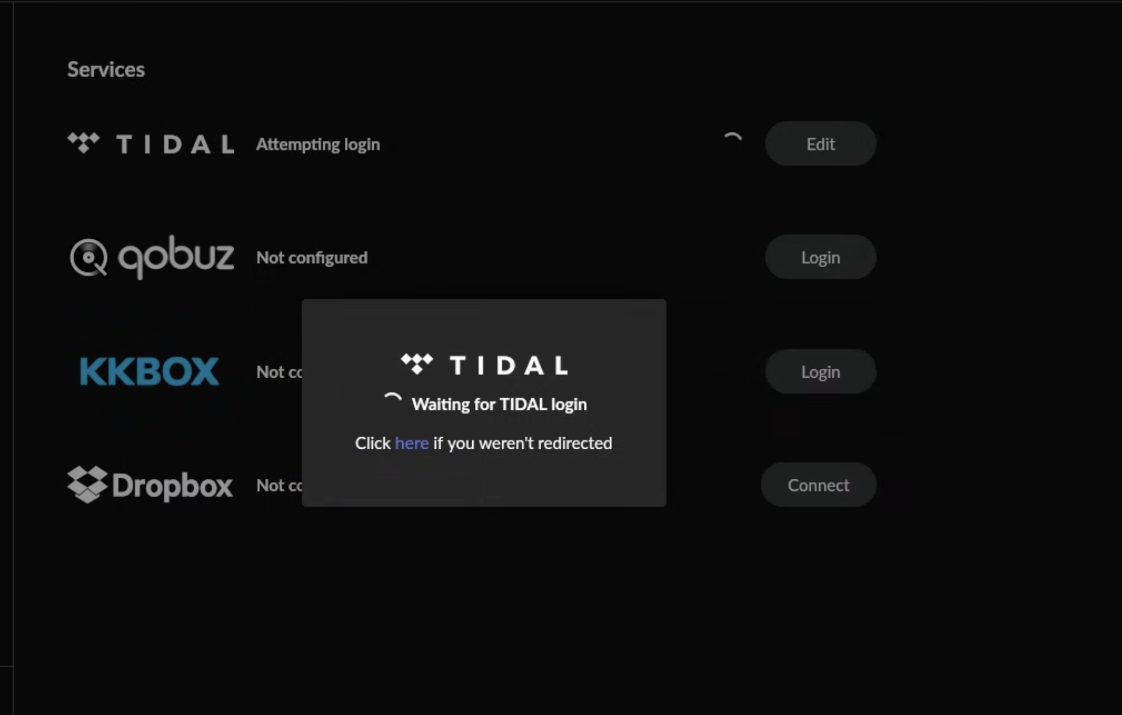

I can't login to tidal from my roon server device or any other device controlling roon, the roon server is installed pn mac mini 2014.

Looking at your screenshot, it appears Roon is stuck on the “Waiting for TIDAL login” stage.
Because Roon uses a secure login method (SSO), clicking the “Login” button is supposed to automatically launch your default web browser (Safari, Chrome, etc.) so you can enter your credentials there.
Could you please clarify one detail: When you click the “Login” button in Roon, does a browser window actually open?
If the browser window does not appear, or if it opens but fails to redirect you back to Roon, this is usually caused by software interfering with the link:
  • Popup Blockers: Check if your browser (Safari/Chrome) is blocking popups from Roon.
  • Ad Blockers: Extensions like AdBlock or AdGuard can sometimes block the login redirect.
  • Antivirus/Firewall: Some security software on macOS can prevent Roon from launching the browser.
    • Try this: On the screen shown in your screenshot, click the small blue link that says “Click here if you weren’t redirected”. This should force the login page to open manually.
  • If the browser DOES open: If you log in successfully in the browser but Roon does not update, try temporarily changing your default browser (e.g., use Chrome instead of Safari) and try again.
Please let us know if the browser window appears!

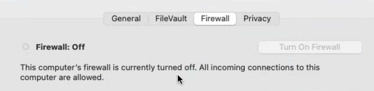

To confirm, you’ve temporarily also bypassed your macOS firewall, and the issue persists?
Thank you! :folded_hands:
The Roon server is up and running 24/7.
The firewall if off.
